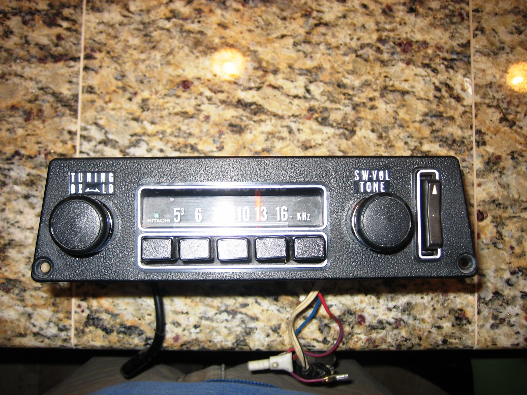

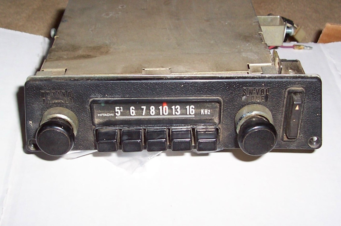

Here's the results. I wound up using a silver pen from my local grocery store. I think it looks really good. I can't say the finish is an exact match to the original, mostly because I dont have one to compare it to, but I am very happy with it.
You can see, I did get some ink in the middle of the letter 'o' and Im not sure how to fix that (I'll probably just leave it as it is so small and minor).
I dont think I would have had the patience or steady hand to deal with a nail polish brush - the silver pen applicator tip was the exact perfect size for me.....
The first pic is the radio before it was cleaned and finished, and the 2nd is after my mini restoration...
Thanks 26th and Enrique for the pointers. You guys rule
To fix the O, I think I'd just get a fine point black pen and mark over the mistaken part. Just a thought.
By the way, you did a great job -- it looks nearly as good as new.
Thanks guys - that is awesome.

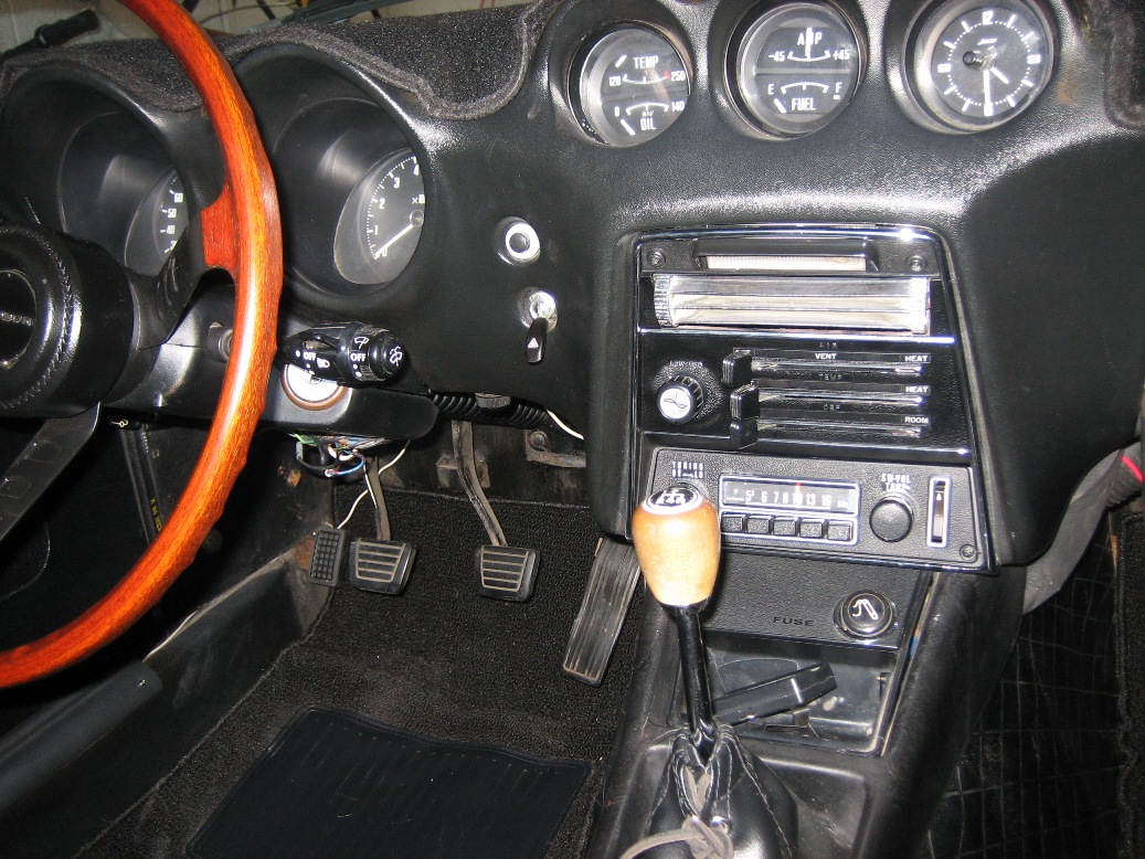

I 'installed' it today.
I dont know how to hook it up at all so I just put it in the dash for cosmetic reasons. I have a few electrical issues that I want a professional to look at so at some point down the road I'll have someone hook it up for me.
I also got the map light (or what we used to call the 'dope scope') working which is really cool.
Lookin pretty good. I should have a new ashtray with lid next week to fix that cosmetic issue.......
While you are looking at the pic - notice the button above the hazard flasher. When I press it, something in the engine compartment seems to spin into life. I assume it's the starter. Anyone know what this button is for? I assume it's not a stock item...
OK! I have the same radio in my '71 that DD has. I am wondering if I can screw the antennae switch onto the side of the '74 AM/FM radio and use my old face plate? It look like this antennae power switch is not a part of the radio harness. I am guessing all I need to do is screw it onto the radio and hook it up. What do you guys think?
Some backyard mechanic starter button perhaps, wanted something a bit different. Next time you go to drive the car, turn the key to on and press the button. You might be able to save your wrists the horrible strain of twisting the key and holding it for 2 seconds. :)
