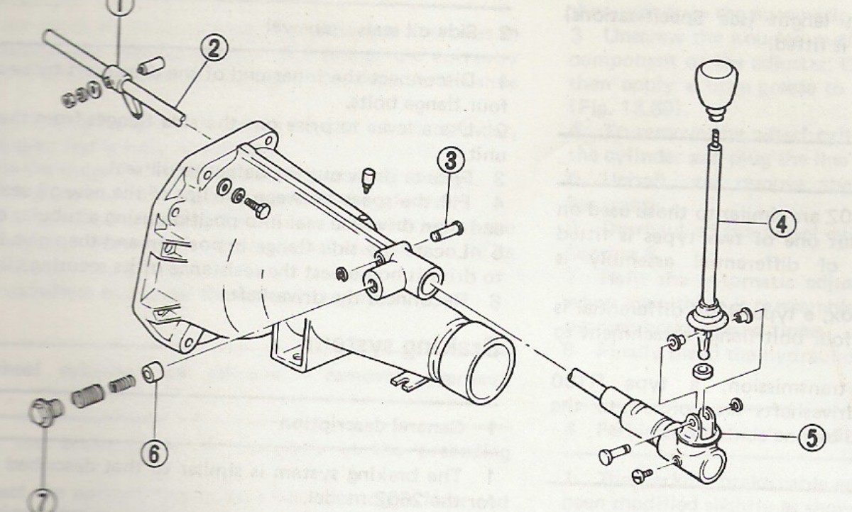

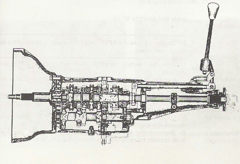

This link will take you to a drawing of all the Z transmission types A, B, and T-5.
http://zhome.com/ZCMnL/tech/69-83TrannyShifterDrawing.jpg
I also recommend changing out the rear end to match the tranny. When I switched from 4 speed to 5 speed, I lost some low end due to the mis-match but gained high end. Also, match your clutch to your driving. Racing clutches are no good for the street. I went with a bigger disk, but softer springs to make it easy on the leg for my mainly city driving.
Good luck! Gee, I haven't pulled a tranny in ages . . . .
