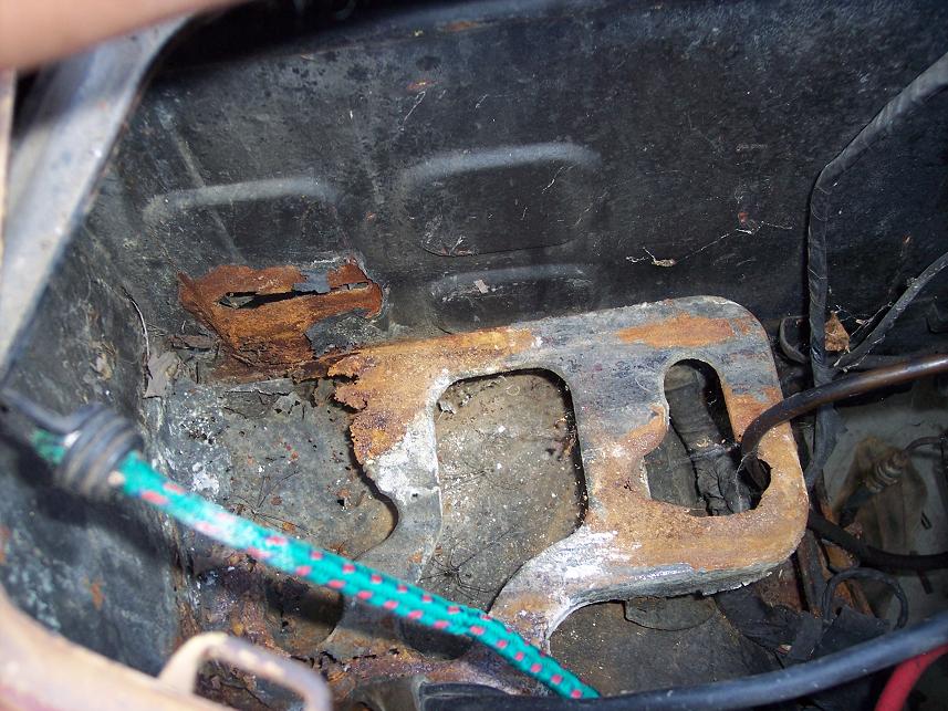

hello. i attached a picture of the battery tray. how bad is the rust here? thank you.
Well it dosen't look good . It's difficult to tell from the picture . Hose it off and wire brush and scrape the loose rust away . See if there is any rust through spots , especially below the tray where the inner fender attaches to the frame rail . This is the critical area . The battery tray looks mostly gone in the picture. Use some baking soda and water to treat the battery acid in the area . If there is no rust through then you have dodged the bullet . The frame rail is the biggest worry here . Gary :cry:

Looks pretty bad, hole in firewall above tray, if there is a hole there then the seam between the firewall and inner fender is gone too. Looks like a lot more than just scraping off the rust and repainting. This is just one part of the car, but if it looks like this the rest of the car is probably needing Big $ to bring it up snuff...

7. Firewall by battery tray

That one picture is enough for me to decide.
That Batt Tray is practically gone, and the firewall above whats left of the battery tray has a good size hole. I can only imagine what all the other hidden spots must look like on that poor Z. :cry:
