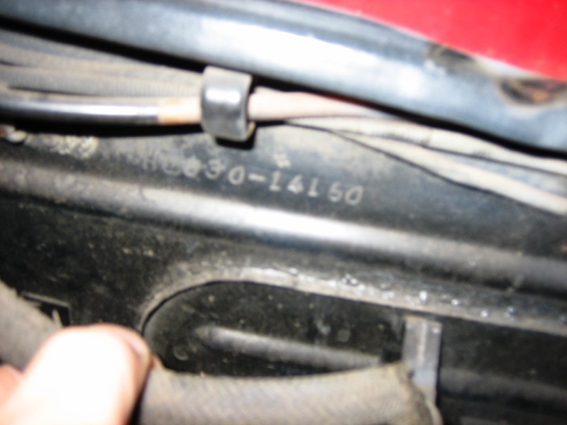

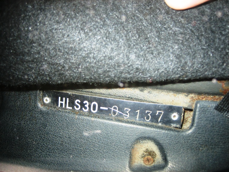

Well - it appears I have been scammed (or someone before me was). Although the VIN on the dash says HLS3003137, the firewall is stamped with HLS3014160.
I've attached pics of both. Does the dash VIN look like a fake to you or is it more likely that it is a dash taken from another car? Obviously the jamb and engine plates were removed to perpetuate the scam....
Based on this new VIN number any idea what year and build date I have? I want to get the VIN's correct all the way around....
I feel so used
Firewall VIN rules. You seem to have a November 1970 build. The dash has probably been changed. Check around for other dated parts and see what you come up with. http://www.classiczcars.com/forums/showthread.php?t=16870&highlight=manufacture+dates
