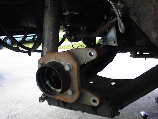

You need to pull out both the stub axles. Check your repair guide for the procedure. The bolt flange is too big for the 4-bolt MAXIMA brake caliper bracket to fit over. There are some brackets that bolt on with 3 bolts without pulling the stub axles, and I think they are equivalents but maybe not as strong as the 4-bolts.
I saw a document somewhere showing the design of the bracket so you could make your own.
While the stub axles are out, why not replace the bearings?
You should ALWAYS replace the rear bearings anytime the stub axles are removed. They are not designed to be pressed in and out more than once.
Here's a pic of the Maxima bracket. You can see why the stub axles need to comw out.

I used the maxima brakets on my conversion but I didn't want to pull the stubs, so I cut the brakets to make them 3 hole so that they would just slide on. Worked well and 3 bolts are plenty for the application as is seen with the aftermarket conversions.
