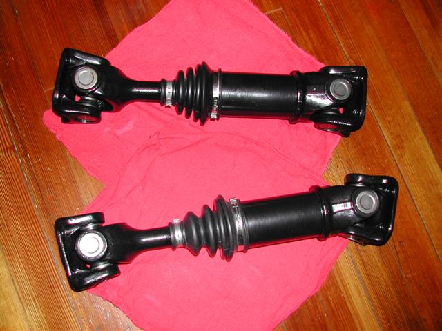

I purchased some rear axle boots and they come with clamps for which I have no tool. What can I use as a clamp: hose clamp? Thanks, Victor.
You realize you have to take them apart right? The c-clamps were so difficult for me to remove I had to take them to a driveshaft shop. They had clamps to put on that fit fine. Otherwise hose clamps will work though the ones they ended up using for me were a special clamp that sort of crimp on. Here's a pic.

Some food for thought.....I would not recommend using hose clamps for this application!!! Think about it, you would be adding excentric rotational wieght to the drive axles. This may cause an out of balance situation! A couple of words of caution, when disassembling the drive axles....place index marks on the two parts before disassembly as you want them to go back together the same, be very aware of the sequence in which the parts are arranged, DO NOT loose any parts as they are no longer available, and be sure to relube the assembly with the correct lube. Hope this is of some help!
What sort of clamps are they? If they are the usual type used on CV joint boots you don't need a special tool. Simply pull the end through the loop hard, bend the end right back and cut off the surplus. Easy peasy :)
