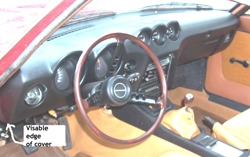

Regarding the dash, you can also look into a "full dash cap". They run just under $100.00 and are relatively simple to install....although patients helps, and depending on the condition of your existing dash. When done properly, they look great, with very little trace of it being a dash cap.
Tom is right, for $100 and some time you can have what looks like a new dash to most people, this is a picture of a cover in my '73.
I marked the only seam that realy stands out-and it is only slightly noticeable when the doors are open. The cut-outs for the gages, and the hazzard switch and the cigarette lighter are also slighty noticeable, as is the altered setback of the glovebox door, but... in reality, most people(unless they know a bunch about Z cars) who are in your car will never notice if you take the time to install the cover correctly.
I have both a restored dash and a covered dash, and the cover will suffice for all but show restorations, bragging rights and personal piece of mind!
