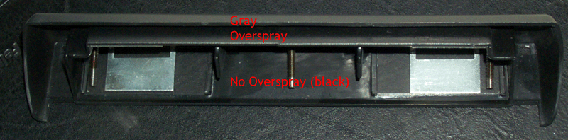

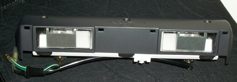

July 12, 200519 yr comment_130453 Posting this for ED-you did it right! The housing is made from black plastic that is painted gray (at least for the USA) by Nissan. Will Link to comment https://www.classiczcars.com/forums/topic/16500-licence-plate-light/?&page=2#findComment-130453 Share on other sites More sharing options...
July 12, 200519 yr Author comment_130455 Will, Where you marked "grey overspray" is where I have grey overspray on mine. I guess the rest was cleaned off. It does look better matching the panel.Thanks.Edit: One more question, What is the gasket material made out of? Link to comment https://www.classiczcars.com/forums/topic/16500-licence-plate-light/?&page=2#findComment-130455 Share on other sites More sharing options...

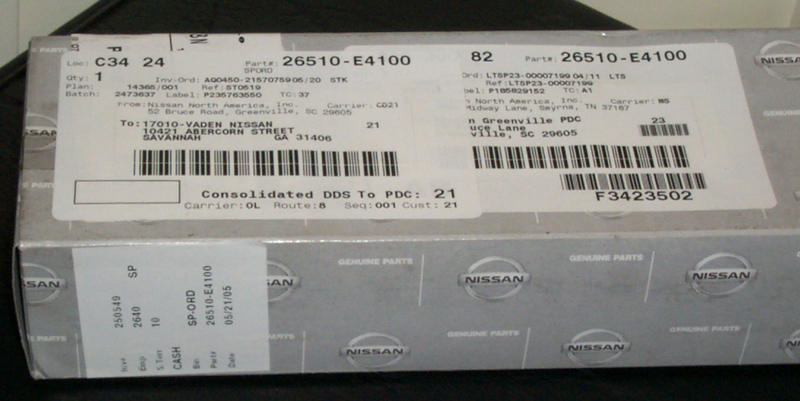

July 12, 200519 yr comment_130456 So what colour is it then. You say black then a grey overspray. To me this applies it was originally black!Are you saying this one you purchased has NEVER been installed on a car and came NEW in the box.Joseph Link to comment https://www.classiczcars.com/forums/topic/16500-licence-plate-light/?&page=2#findComment-130456 Share on other sites More sharing options...
July 12, 200519 yr comment_130458 Just ordered in from the Dealer on 5/21/05. Out of the box twice-once to check for damage when I picked it up, and just now to take the pictures! Will Link to comment https://www.classiczcars.com/forums/topic/16500-licence-plate-light/?&page=2#findComment-130458 Share on other sites More sharing options...

July 13, 200519 yr comment_130503 Will, Where you marked "grey overspray" is where I have grey overspray on mine. I guess the rest was cleaned off. It does look better matching the panel.Thanks.Edit: One more question, What is the gasket material made out of?The Gasket is made of rubber or something similar-I would think a suitable copy could be cut out of edpm, an inner tube, rubberized gasket material-btw you have a PMWill Link to comment https://www.classiczcars.com/forums/topic/16500-licence-plate-light/?&page=2#findComment-130503 Share on other sites More sharing options...
July 13, 200519 yr comment_130518 I call it anthracite. The grey / gray color of the hubcaps, rear valance, and front grill. It is a lacquer paint and has a dull finish. Anthracite is the color of my license plate light. It is painted over black plastic. Now...you didn't ask me about no stink'n gasket. I'll have to go back and check. Link to comment https://www.classiczcars.com/forums/topic/16500-licence-plate-light/?&page=2#findComment-130518 Share on other sites More sharing options...

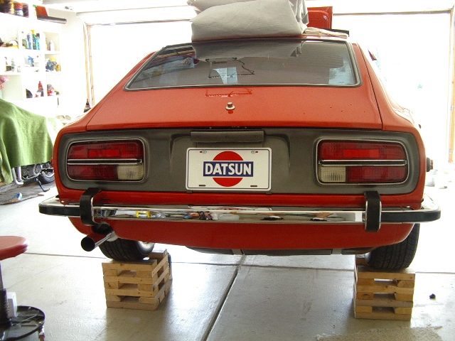

July 13, 200519 yr Author comment_130550 Thanks Will,The color of the panel that is mentioned in another post is from Dupli-color it's a High performance wheel paint. WP-102. This is what I used and was able to give it a dull finish by making the last coat a fine quick mist. She looks goooooood! I'll put up a picture when I get it all together. Link to comment https://www.classiczcars.com/forums/topic/16500-licence-plate-light/?&page=2#findComment-130550 Share on other sites More sharing options...
July 14, 200519 yr Author comment_130675 Here she is all put together. Link to comment https://www.classiczcars.com/forums/topic/16500-licence-plate-light/?&page=2#findComment-130675 Share on other sites More sharing options...
