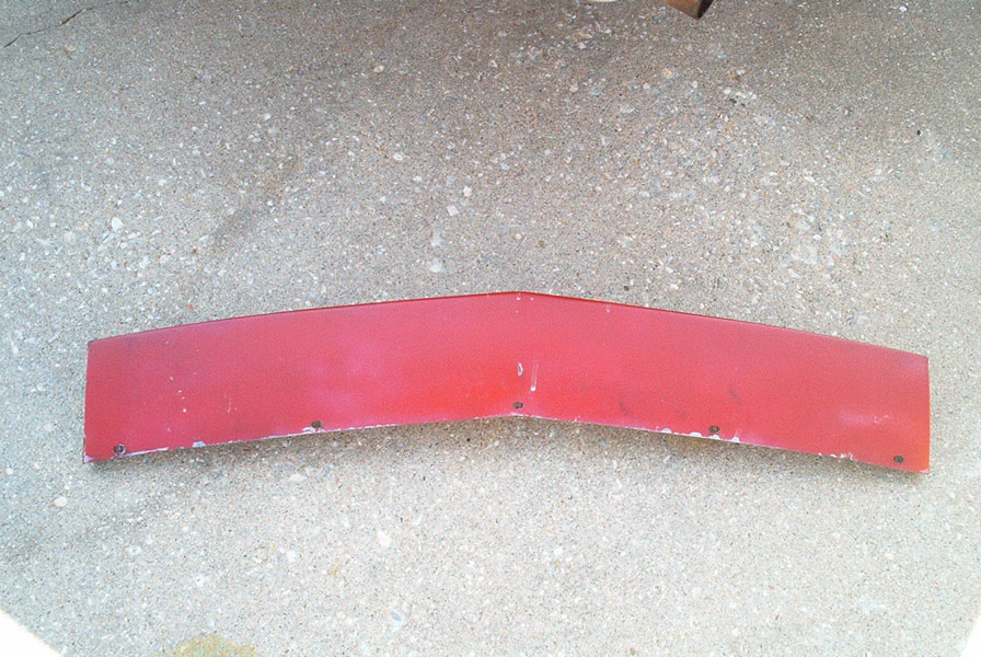

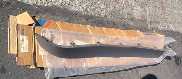

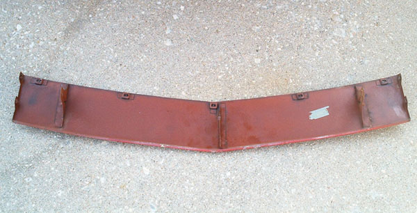

The spoiler you are talking about did not appear on US imports. If you look in Brian Long's; "Fairlady to 280Z", page 89, there is a color photograph that shows it pretty well. Actually, the captions for the photos on pages 89 and 90 are reversed, but you can see the configuration. You are correct that the turn signals are mounted above the bumper. For the spoiler installation, the entire lower valance is different from the US spec. Here are some pictures of the actual spoiler. It is flexible - vinyl / plastic / urethane / rubber covered foam. Same material as the early rubber floor and deck mats, only thicker. I think the real ZG bumper is made of the same material. You will notice the embeded bolt tabs. They bolt to holes along the lower edge of the valance with welded captive nuts. As you can see from Long's picture, the spoiler bolts to the turn signal wings as well as the middle valance.
I have never purchased anything from Fourways, but I see their advertisements all the time in English magazines and I have heard several success stories from friends. PM me if you want this center valance.
Chris

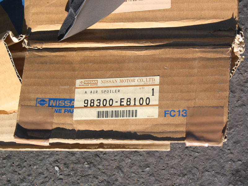

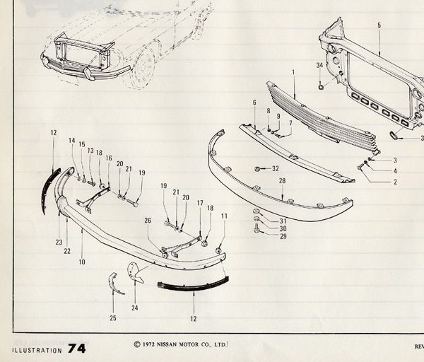

As addition to the good information posted above, here is a scan from Nissan's "R-DRIVE" parts lists.
The illustration shows what they call the "European Air Spoiler" - numbered 28.
*98300-E8100 ASSY-FRONT AIR SPOILER ( EUROPE ).
These were indeed made from Urethane foam with a hard skin on the outside ( hence they were still slightly flexible ). However they hardened up with age, cracked and also deformed in bright sunlight over the years. The steel brackets that were moulded into the Urethane also went rusty after getting wet over the years, and tended to swell up - with the brackets eventually failing......
Good condition original spoilers are like gold dust in the UK these days. I have not seen an NOS one like 26th-Z's pictured item for many years now. The last couple of half-decent used ones I had were sold to Japan.

No serious effort at all, Rick. I was on to one of those some time ago until I realized what Alan pointed out. Fourways has what I think is a reasonable aftermarket approach. Furthermore the center valance with the captive nuts does not fit in 26th's chassis. This was the project that allerted me to the differences in chassis and valances. Go figure. Early cars are different from later cars. The mounting tabs are spaced differently.

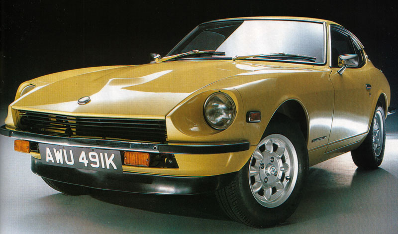

I have some decent photos of cars with these spoilers, I'll dig them out....
Photos as promised
Heres a Euro model 240Z.
Notice the absence of the usual indicators (turn signals), instead they have the bumper mounted indicators, presumably because of design regulations in the UK/euro market.
And theres a euro spoiler. (probably an reproduction one).

Hi Mr C,
That's exactly the car I was talking about above; restored on behalf of Nissan UK for them to use in press and promotional activities.
It is indeed an aftermarket front spoiler - in fact, it is the one-piece FRP item that replaces the spoiler, front valance and both corner panels. If you look closely you can see that there is no join between the nearside corner panel and the front valance......
