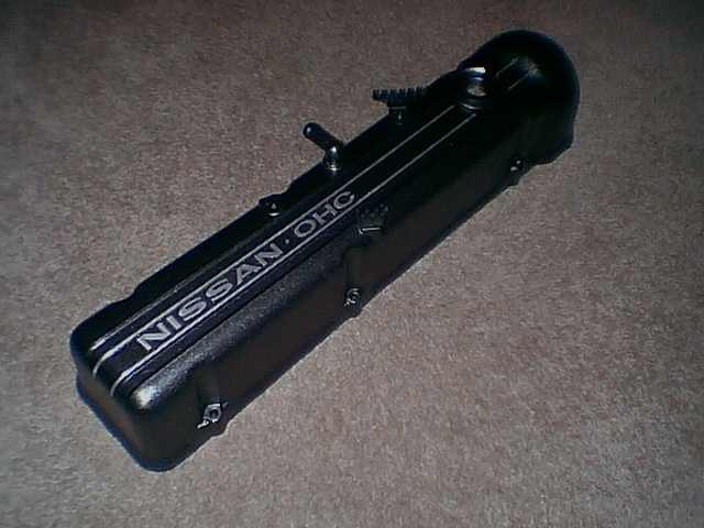

Anyone like my newly painted and cleaned valve cover??

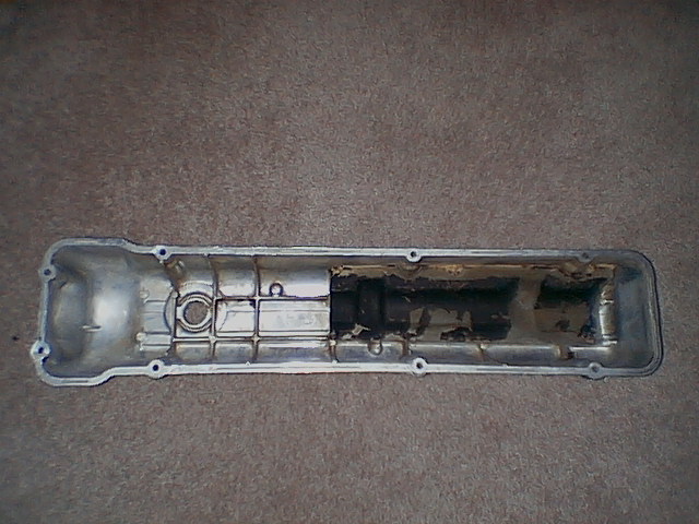

I'm so proud of this valve cover... hehe
spent hours and hours on it..
I used aircraft stripper and a toothbrush on the inside of the valve cover.. and it looks spotless... just in case any flakes of hardened oil and varnish breaks off and damages my baby!!

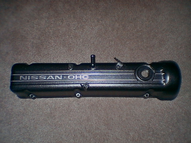

Looks like mine. Textured paint, regular paint, & polished ribs and letters.
Next time I'm going to have mine Powder-Coated in the same style.

I don't know what he used, but I used but I used Textured Paint (sometimes labeled as Wrinkle Paint) available at all of the Kragen (CSK) stores arround here. The paint I used in between the ribs was regualr VHT Semi-Gloss Black paint. I polished the ribs and letters first, then masked them & painted the area between the ribs. Next, I masked the entire area between the ribs and applied the Textured paint to the rest of the V.C.
Lots of cleaning of the V.C. before any paint gets laid down.
I used Dupli-Color "Textured Metallic coating"
I got it at AutoZone.. but is available at Wal-Mart... Checker, Pep Boys, etc.

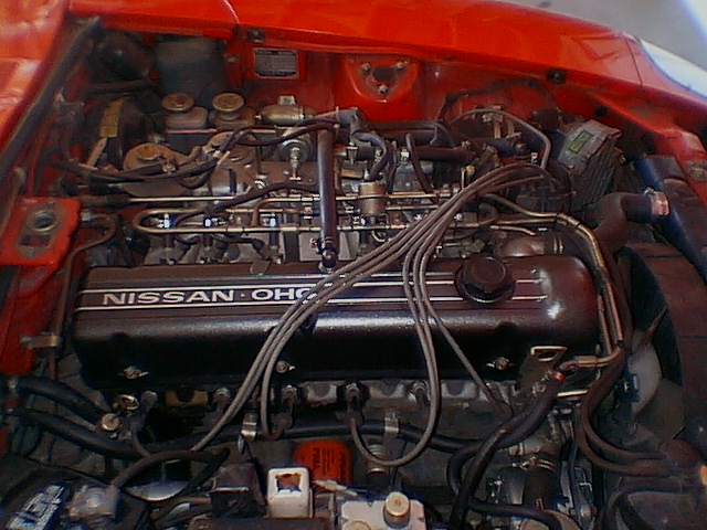

Finally put it on my car!! yess!!
Ontop of the thumbnails.. i'll throw in some bigger pics :)

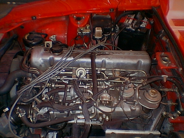

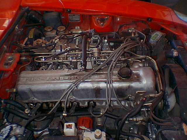

Before:
After:
Before:

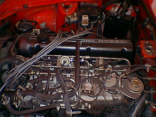

After:
Not only the valve cover, you've kept the entire engine compartment very nice and stock. I see lots of original clamps, ties and even the battery positive lead. Show ready.
Is the fuseable link cover cracked? The valve cover makes a world of difference. Well done!
