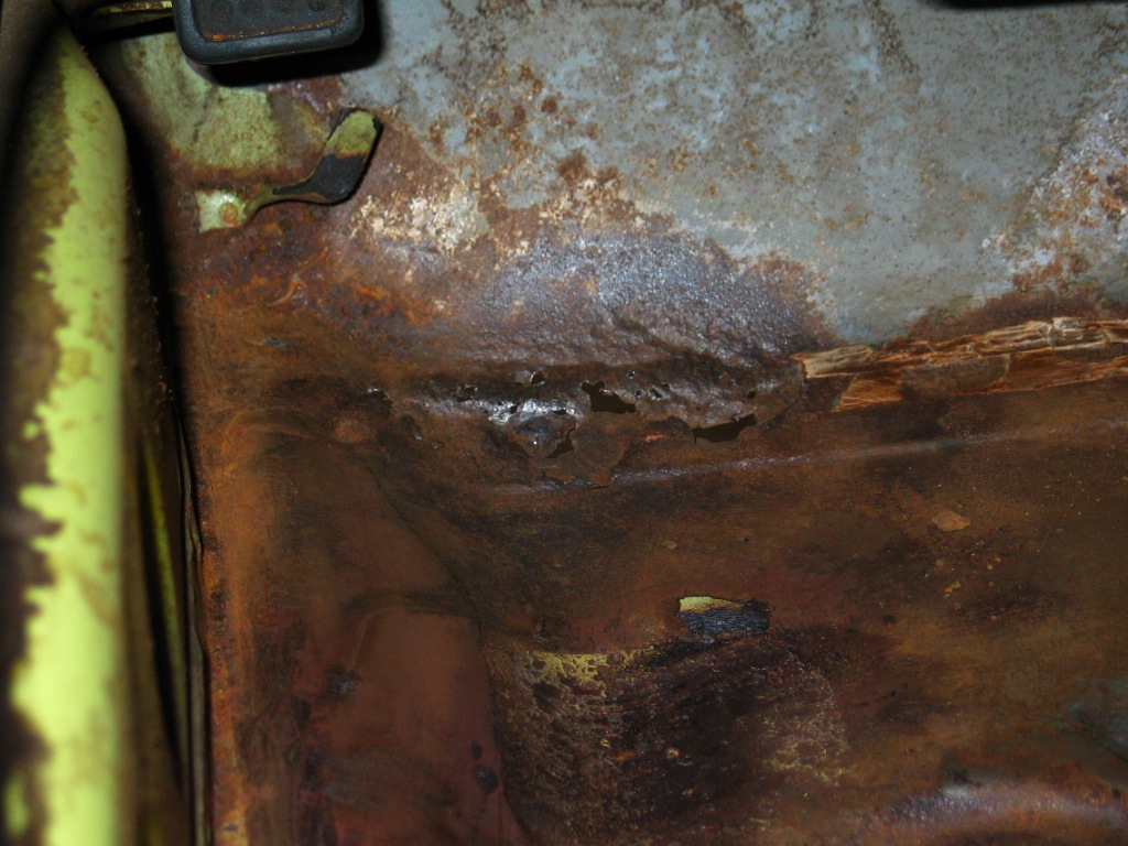

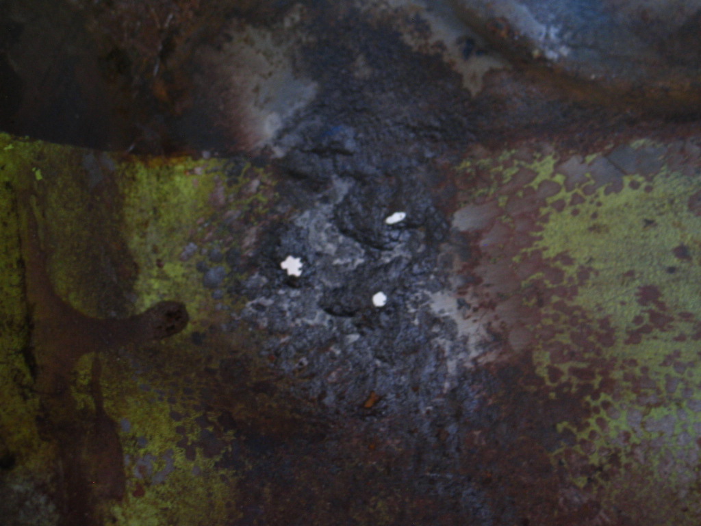

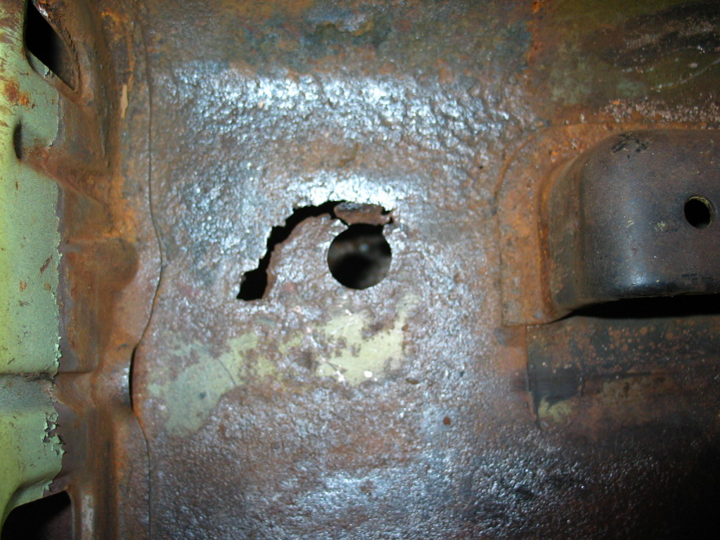

I need some expert advice. I have been griding the rust off the floorpans over the weekend, fully expecting those "little holes" I noticed initially to end up taking over and making my decision to opt for new floorpans an easy one. But, after finishing up all I found were those pesky little pinholes and about 4 areas maybe 1 x 3 inches (2 on each side) in size...
Should I still get the floorpans whacked out and rewelded?
I was on the POR-15 website and they talk up their PorPatch product which sounds like a great option for wha I am dealing with. Has anyone used this stuff? Is this even a proper indication for that type of product?
Here are some pics.
Many thanks!

Using the POR-15 product would be an easy fix for your current rust problem. My only concern would be retaining the structural integrity of the floor pan. I wouldn't want to run over anything knowing that there is only a little bit of filler and paint with paper thin rusted sheet metal protecting my feet. If it was me (look in my gallery) I would cut out all the rusted metal weather it's in patches or the entire pan and replace it with new sheet metal. It's a pretty easy fix since you have access to both sides of the pannel. Once welded in place then use the POR-15 product and protect your new steel floor.

If you were to treat the area's pictured with POR's "Metal Ready" product, the holes would be enlarged considerably. Bearing that in mind, and what little of the rocker panels that can be seen, I'd opt for replacement of the entire floorpans, and rockers (if needed) AND treatment of the entire area with POR15. This is the kind of work that you only want to do once,............................ unless you have lots of money, and time to burn.

MOst of the damage is in the middle of the floorpans near the drain holes, so I think I will POR those (unless the Metal Prep uncovers more extensive damage). There is some through-and-through rust along the welding line near the firewall (pic #3) which I would feel more comfortable having welded. The car is not going to be a 300hp hotrod, so the odds of it ripping in half from some rust like above is pretty slim.
