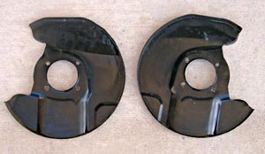

Here are some images of my conversion. It's so easy it doesn't make sense to go into detail. You will need to trim the baffle plates as my before and after shots show.
