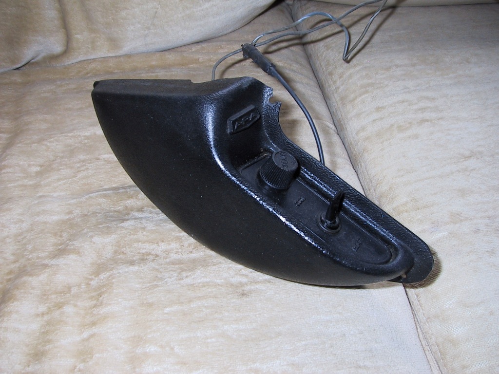

Posted June 24, 200421 yr comment_86297 I will post a pic tomorrow since I am at work at the moment. Basically, I have this interior console piece that has had me baffled since I purchased my 240z. It is a small clamshell or banana shaped plastic "mini console" that bolts onto the side of the existing center console right by where the dash meets the center console. It had 2 buttons on it. One was for the heater, and I believe the other was for the defroster, but I will have to doublecheck when I get home. It has the letters "ARA" on it. Does anyone have any idea if this is an actual factory piece? I've currently modified it to mount my remote VDO tach control pad, which I think will look really cool and discrete once installed! :classic: Link to comment https://www.classiczcars.com/forums/topic/12321-need-help-identifying-interior-console-piece/ Share on other sites More sharing options...

June 25, 200421 yr comment_86460 Here's what mine looks like; I suspect it's the same. Link to comment https://www.classiczcars.com/forums/topic/12321-need-help-identifying-interior-console-piece/#findComment-86460 Share on other sites More sharing options...
June 25, 200421 yr comment_86463 Mike's picture is exactly what was on my 73. The round knob controls the thermostat with the long stiff capillary tube that goes over to the evaporator. The switch is on/off for the compressor clutch. My compressor said "ThermoKing" on it and there was installation paperwork in the glovebox when I bought the car. Thanks for the memories Mike.Chris Link to comment https://www.classiczcars.com/forums/topic/12321-need-help-identifying-interior-console-piece/#findComment-86463 Share on other sites More sharing options...
June 25, 200421 yr comment_86466 ARA is a HVAC company that did a lot of a/c installations for dealers back in the 70s. There's still and ARA shop in Ontario, CA. They repalced some parts and recharged my system back in 1997 before R12 became really expensive. My 78 has the ARA system and has a smaller version of that pod with just a single knob to control the compressor. In 78, you could get Nissan factory air or 'dealer installed air'. Link to comment https://www.classiczcars.com/forums/topic/12321-need-help-identifying-interior-console-piece/#findComment-86466 Share on other sites More sharing options...
