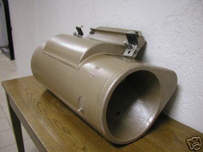

Tanny, is that an original 60's era swamp cooler? My dad bought one of those to use in our '59 Dodge Sierra wagon for our move from So. Ca. to Florida in June of '64. As I recall, it worked pretty good, especially since it was mounted in the rear passenger window next to where my brother and I were sitting!
