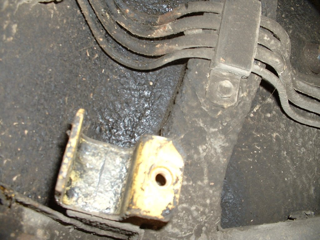

Does this look like the kind of sway bar for a 240Z that does NOT require drilling the chassis to mount?
Doesn't look like the one that I have. Mine mounts to the suspension support brackets, not the chassis
Allen, That is a front-mounted bar. So, 71,72, 73(?) U.S. Spec cars will not have the brakets for mounting this bar and require drilling.
Now, your third photo shows a Z body With the factory front-mounted rear sway bar (wow tonge twister). I'm guessing that's a later car.
Steve (ZVoiture) did a lot of reseach 2 months ago, you should search the forums for his posts. I believe he found that the later bars would not fit the early cars, even if you drilled and installed brackets, as the floorpan was different and the later bars got blocked by the snout fo the diffy.
I can tell you, that the MSA bar (Drill to mount) bar on my car has a major bend in the middle to clear the diffy.
My 73 has those same factory mounts on the chassis. I had no problems installing it. No drilling.

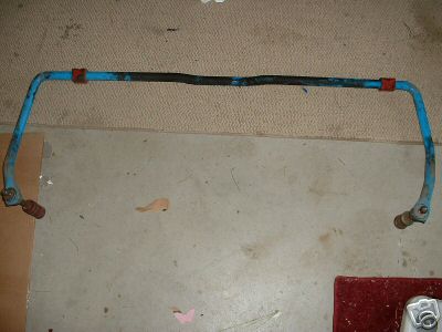

I have the same sway bar that BambiKiller has. Mounts to the rear of the differential on the support bars for the differential.

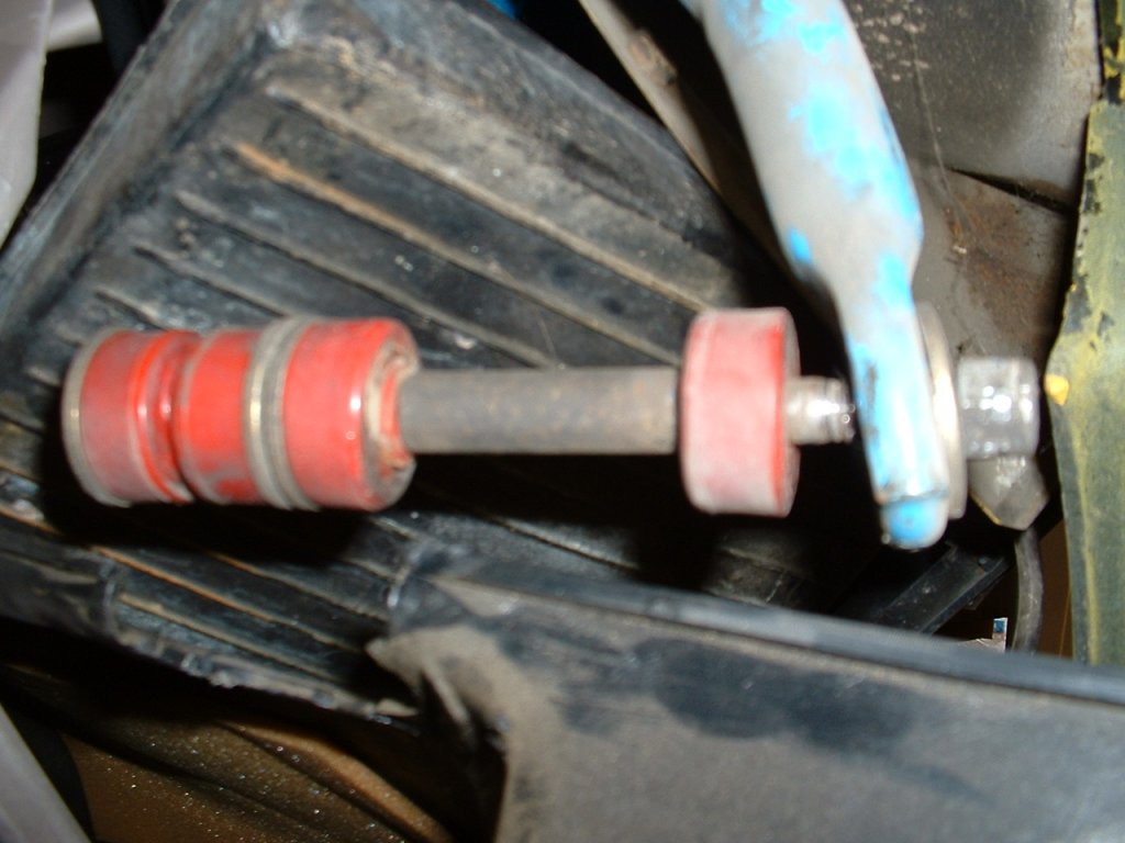

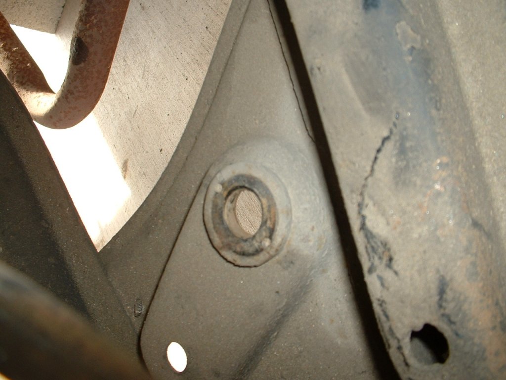

Here is a pic. You can just see the sway bar in the picture.
I pulled my bar from a 260.

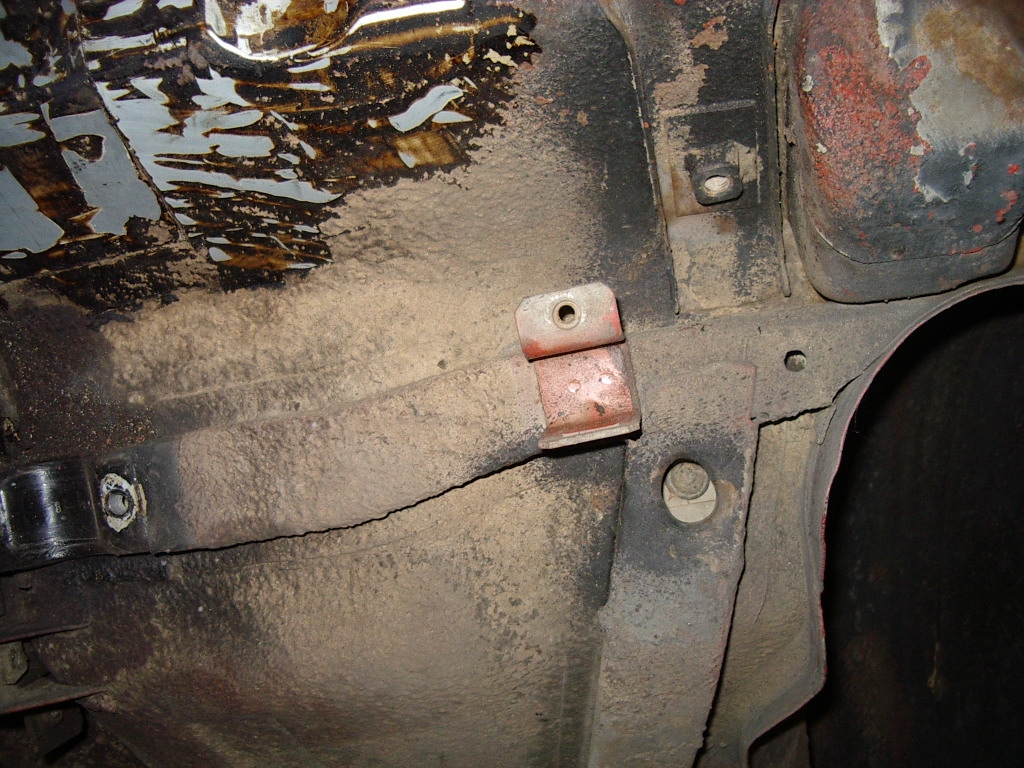

Here is a picture of the factory mount.
