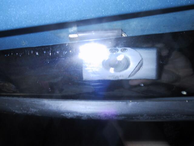

I don't know about Marty but it's not really possible to get a good picture of this piece without taking the bumper off. It's just a very small piece of rubber that goes over each bracket at the ends of the bumper. It only covers the small "ear" or "tab" where the bolt goes through; the bolt actually goes through the rubber and the metal. Attached is an attempted picture from the bottom side looking up at the rear bumper end.

Mike is right. That spot is very hard to photograph. Check out the Banzai site. They have them cheaper than MSA. The inner tube idea is pretty good though. That should do the trick.
