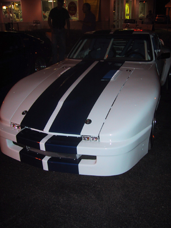

I have kept mine hinged, but my main concerns is not pin location, but securing the reinforcement disk. It has been suggested that I use small machine screws or bolts. This seems sensible. I located my rear pins in the same location as the car you sent. It allows you to take advantage of the reinforced corners of the hood as well as the lip that already exists makes a good mounting location for the pins themselves. I did have to grind off the bosses where the hood stops had previously screwed in so that I could mount the pins in almost that exact location.
