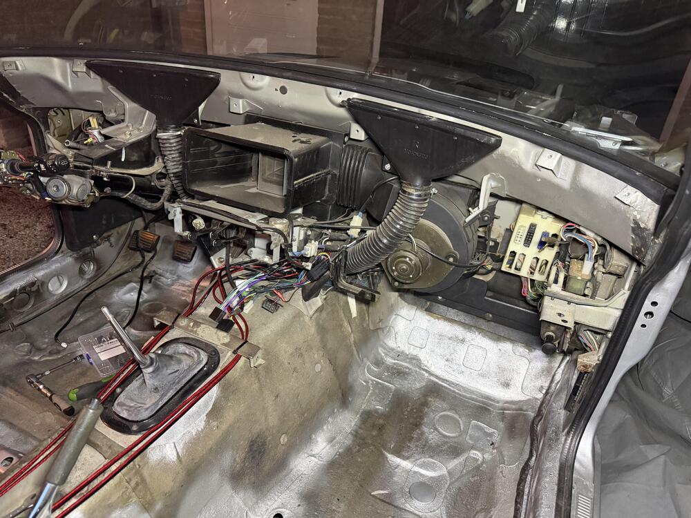

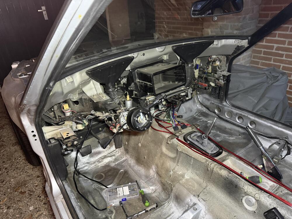

So good news, if you disconnect the three connectors of the dashboard sub harnesses at the white panel on the passenger and then just remove the dashboard the car starts just fine.
As seen in the pictures the dashboard is out and I can start and drive the car just fine!
