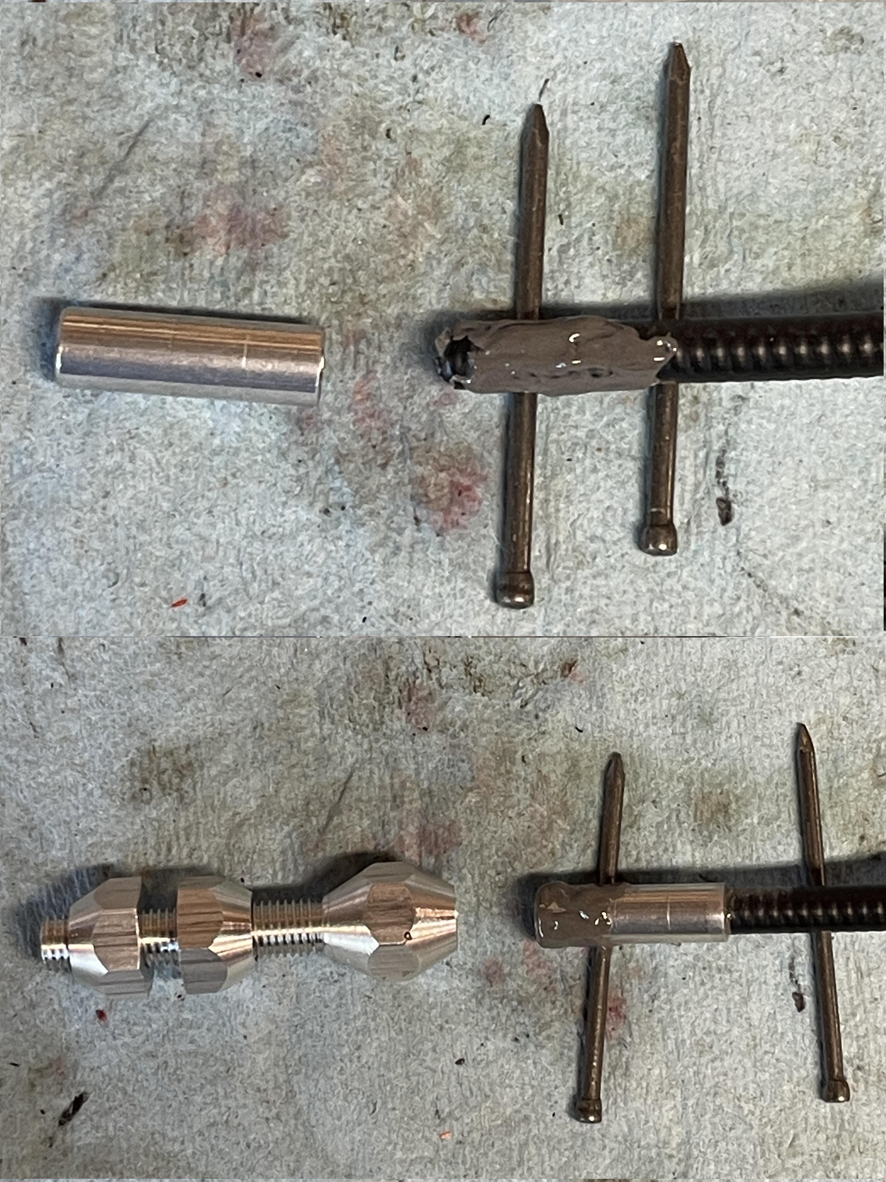

I can't tell much difference between the two as far as the braided sheath or the actual cable.  Not sure about the lining differences between them, they both feel smooth in action.  One big difference is the quality of the hardware, like the included ball & socket fitting.  The Lokar looks of better quality, and has a real adjusting lock nut.  The other doesn't, the hex is for looks, although the cable set screw part is threaded.  The Lokar cable set screw part is metal, the other is aluminum, which I think is a bad idea.  And lastly the Lokar has more room for the loose end of the cable to fit instead the socket fitting, the other only has about 3/8".  Picture shows distance of both.  But the other has crimping around the braided sheath to prevent it from coming apart.  The braided sheath of the Lokar comes apart too easily and is a PITA to get back together.  Mine came apart when I took it out of the box, so be careful. But it is a cut to length universal kit, and the Lokar instructions warn you, you know, after it happens. Maybe wrap a piece of tape around sheath and ferrule until you're done.  I don't think the other's outside sheathing can be shortened.  But 24" is perfect for this kit.
