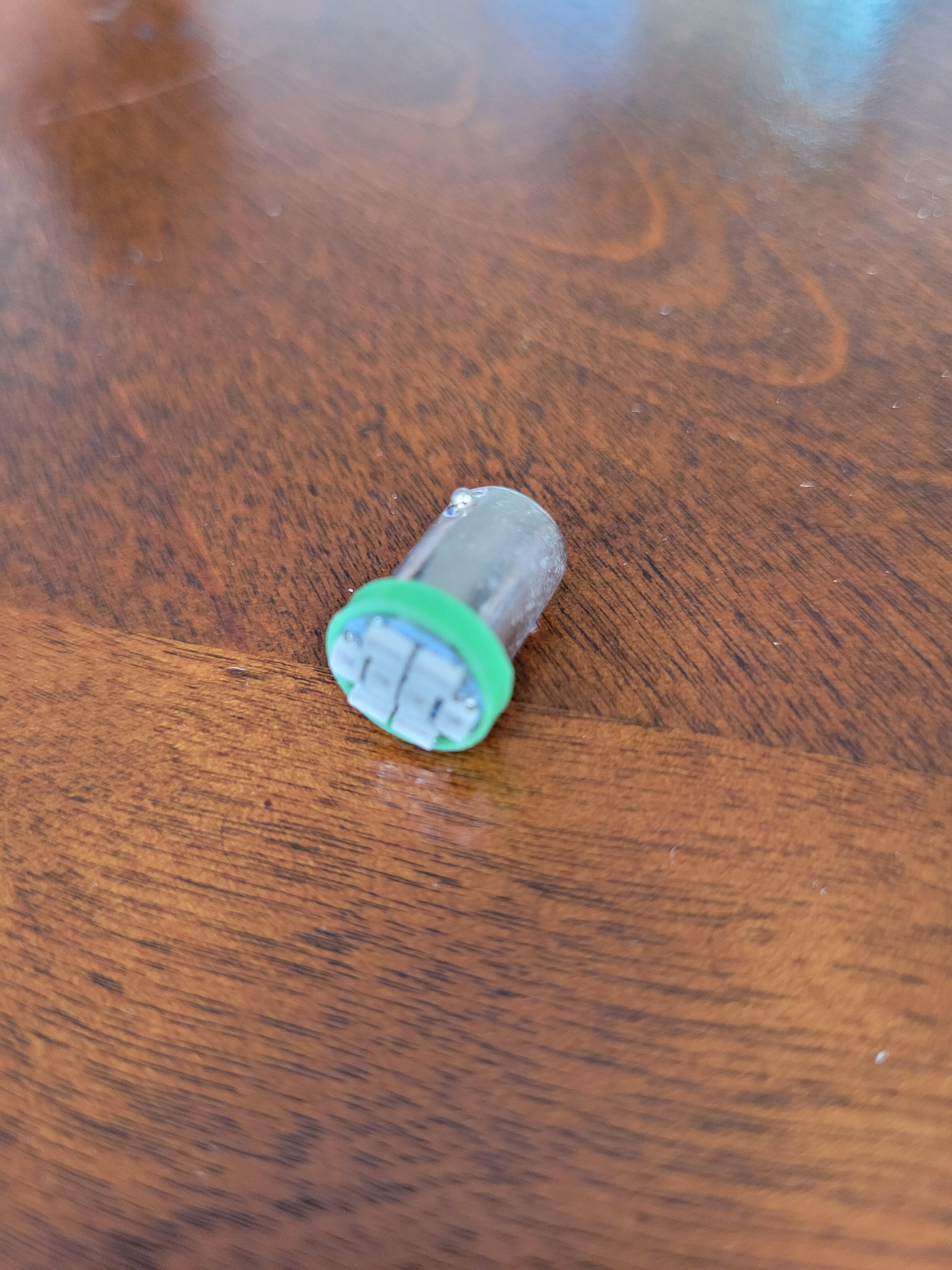

This is the type of led that goes in there!
Hihi.. yeah that's a L.E.D.  (Light emiting diode) as it probably chinese junk, they die..  I got a bulb in my car and after 53 years it still works.. put the standard bulb inthere it will work for many many years.. I;m not against led's but just against cheap junk led's.. 😉
