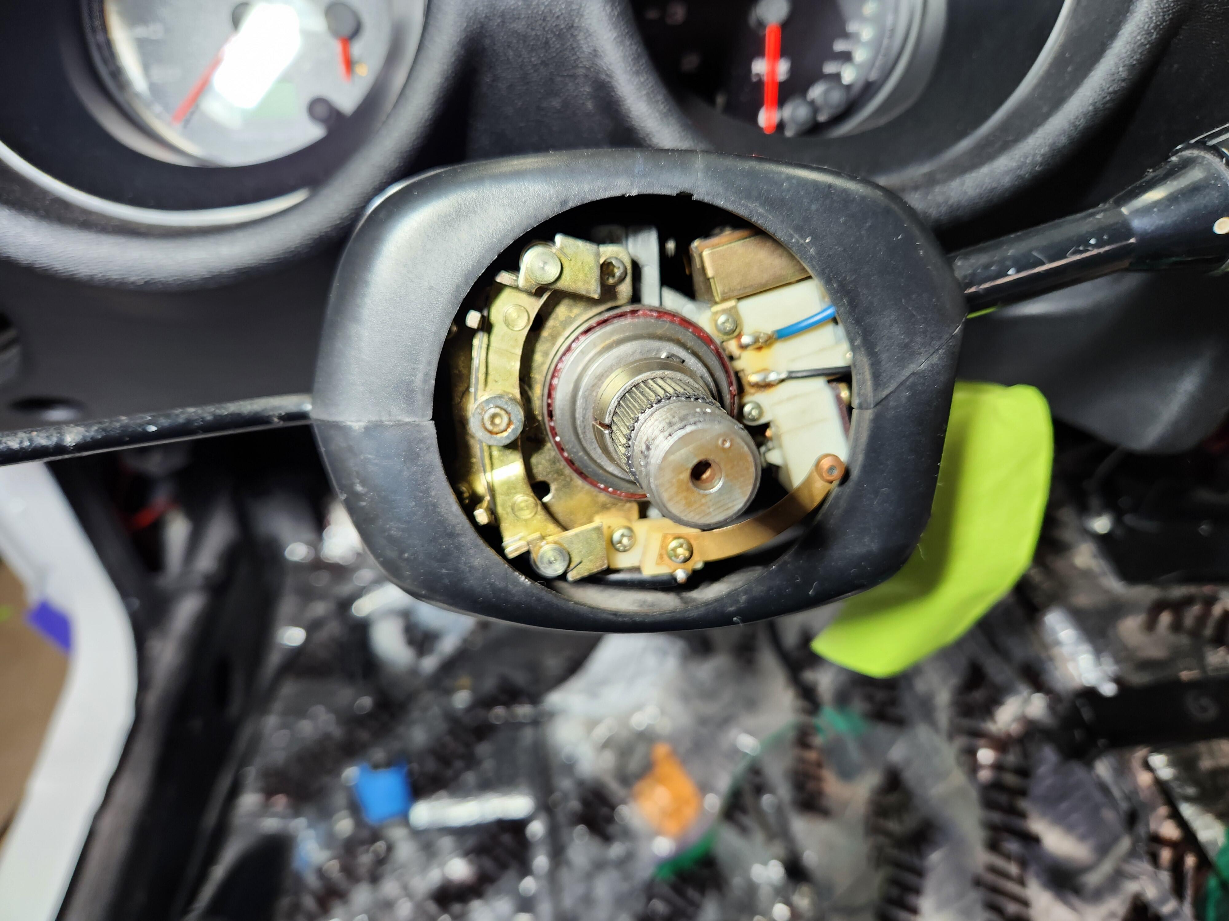

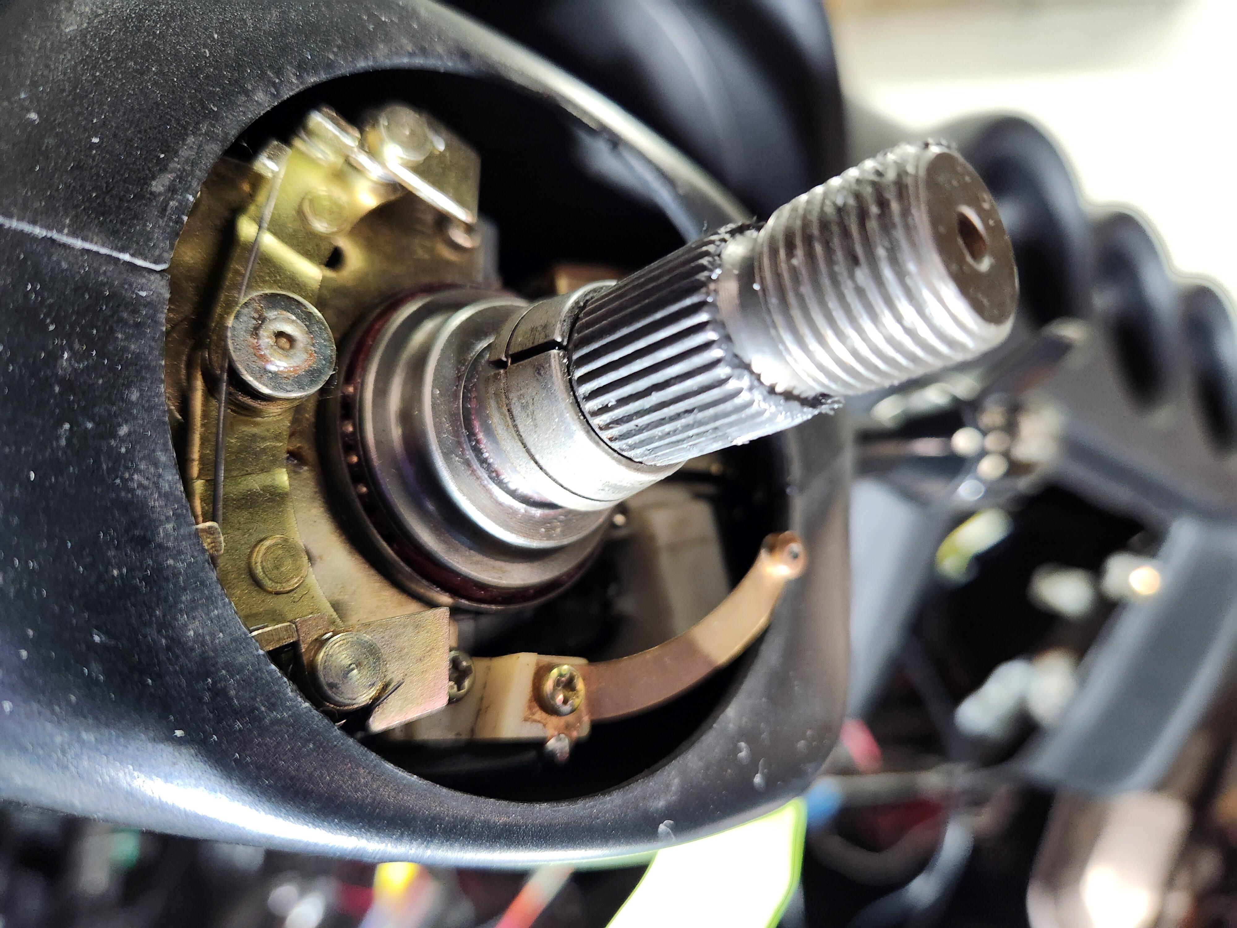

Hello, I have a 76 280z.  I am putting a momo 3503 hub adapter onto my steering shaft.
 Every video I've watched of people putting hub adapters on their s30 it seems they slide right on.

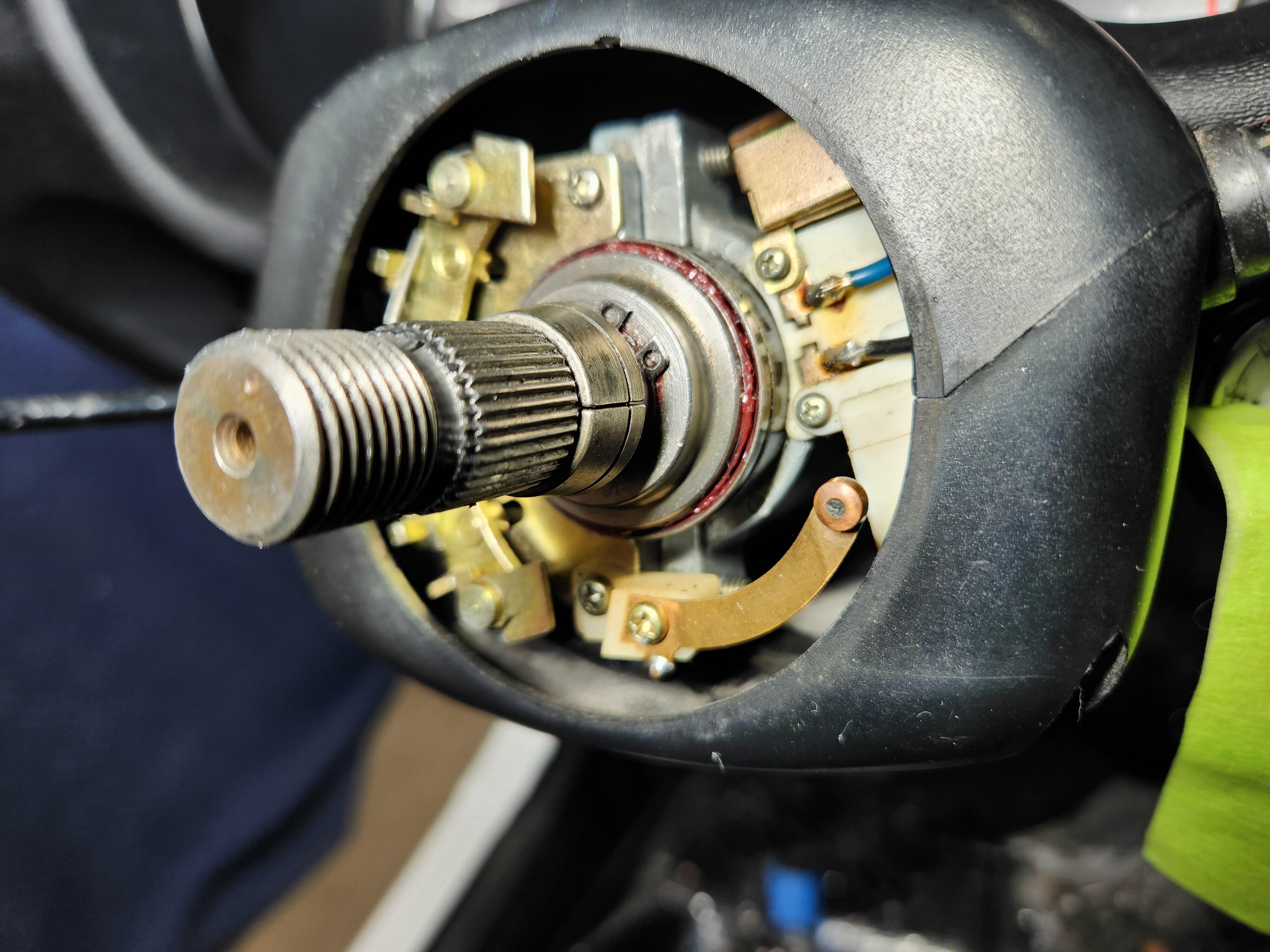

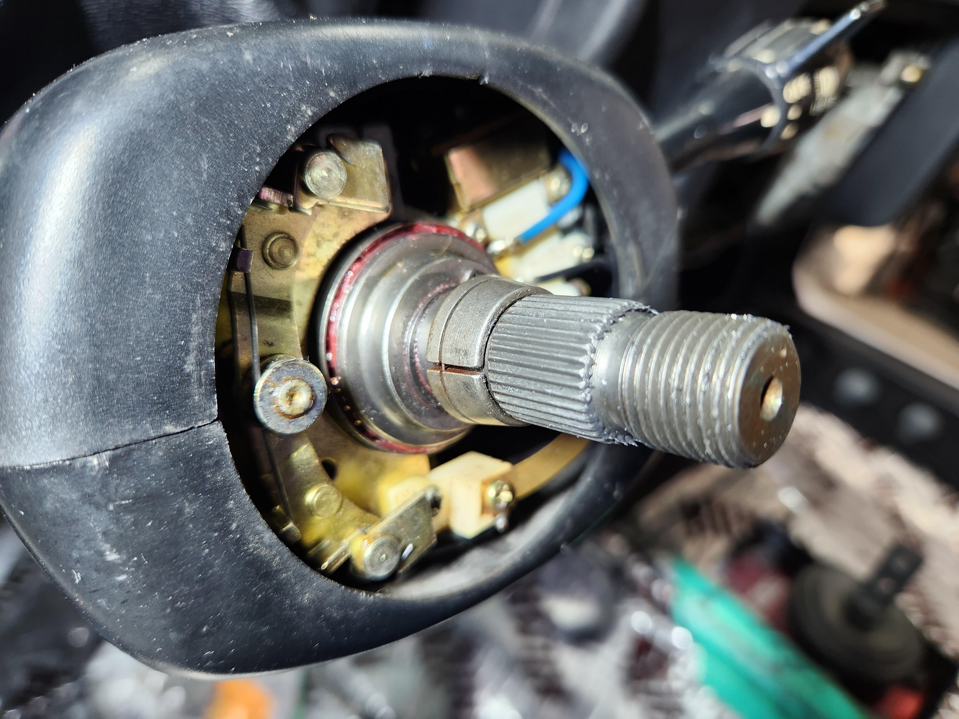

Mine goes on very snug, but I can get it to go on about 6mm or so before it gets really hard.
Maybe I could pound it on, but doesn't seem right and I don't know how I'd ever get it off.  I have checked the splines on both the hub and shaft and they look OK.  I even bought another hub and tried that with no success.   I have 2 other steering shafts laying around and it's always the same thing.

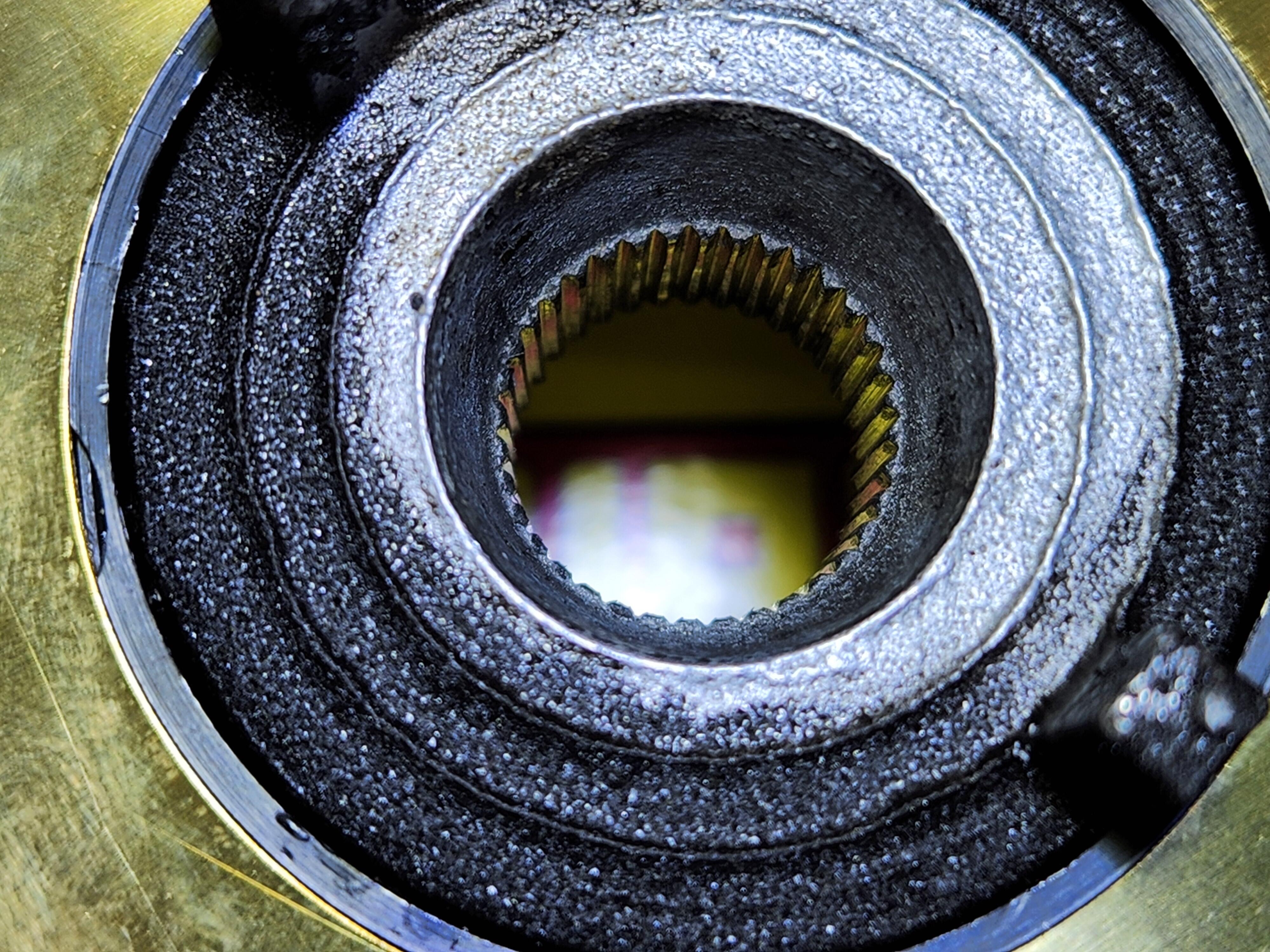

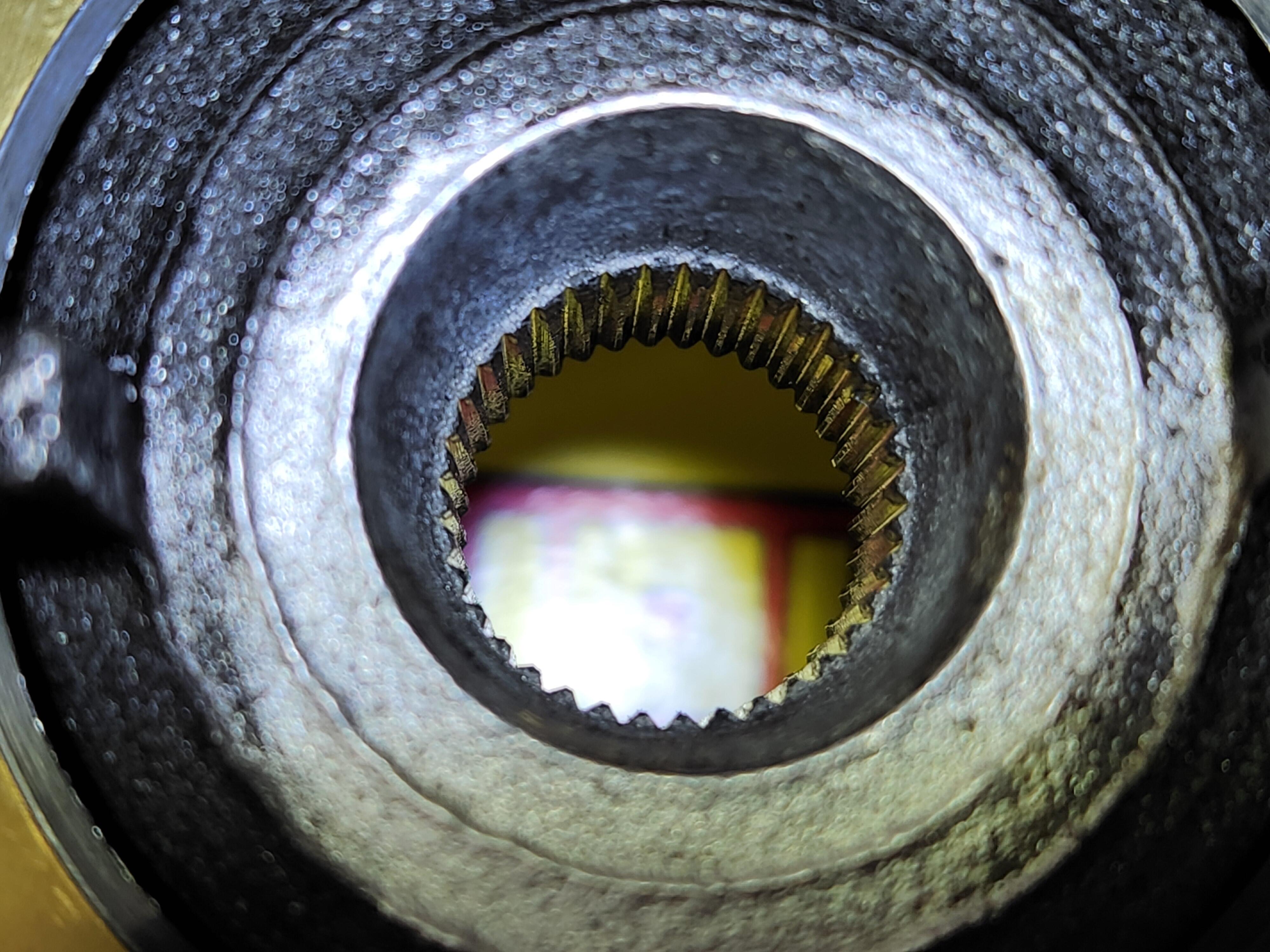

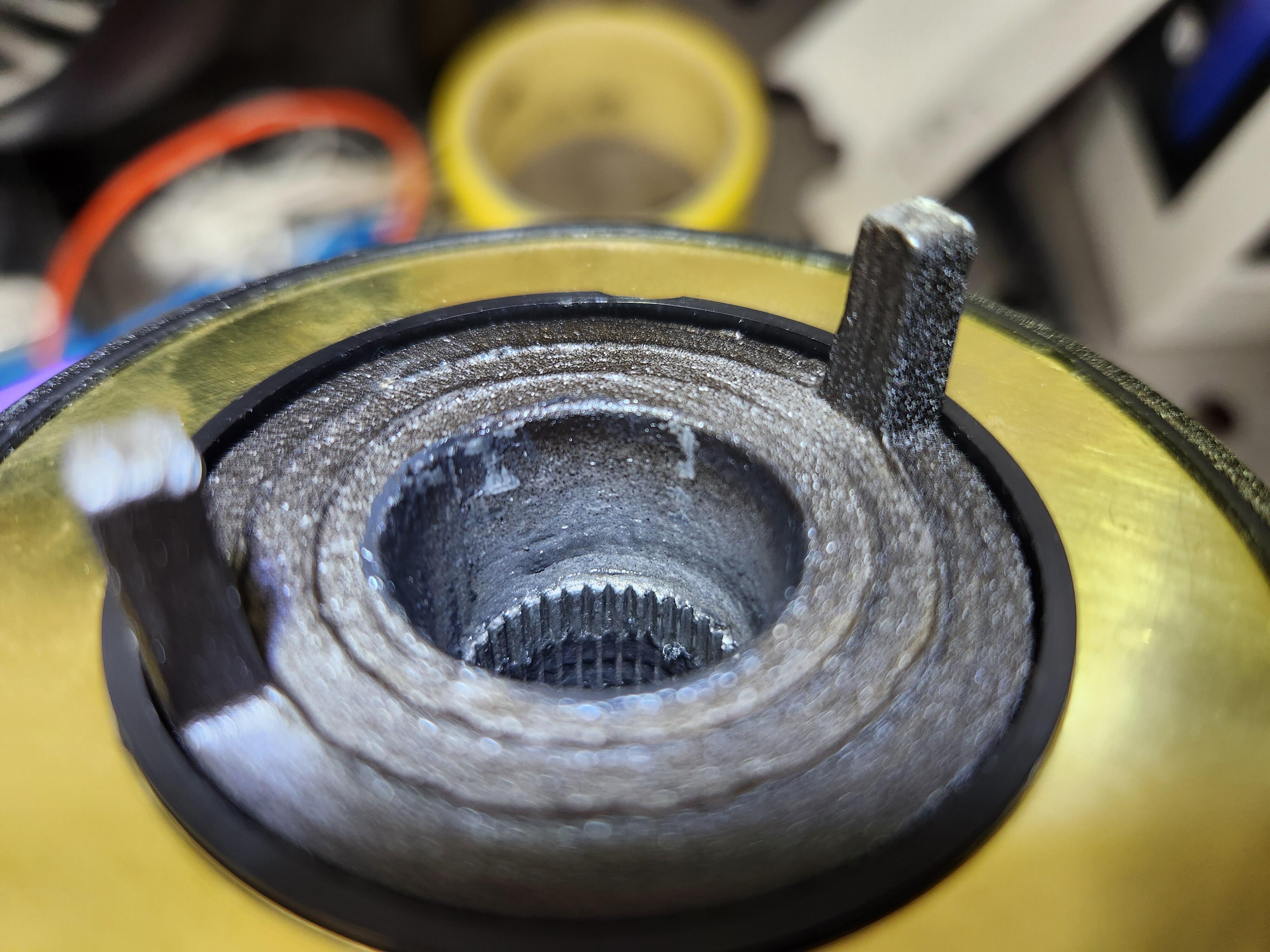

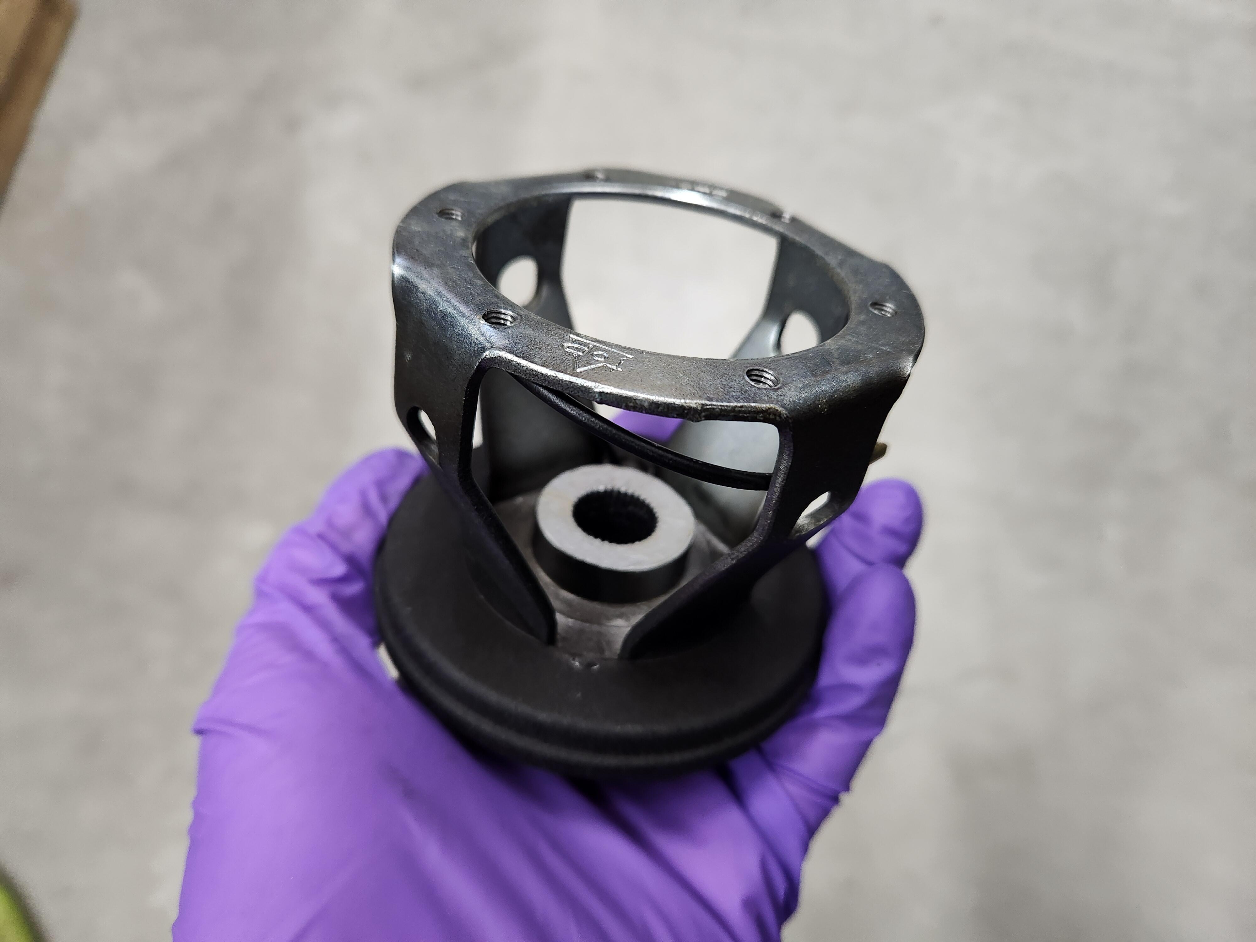

To update this thread:  after further analysis it appears that a portion of the internal splines on the adapter were not fully formed (look at 6 o'clock area on both pictures for comparison)
Good splines:20240228_225942.jpg
Misshapen:
This was the same on both hubs.
I emailed Momo with no response.  I ended up cutting the splines off one of my extra steering shafts and pressed it though the hub as a broach.
It still didn't slide on by hand, but it went on fairly easily with the nut.
