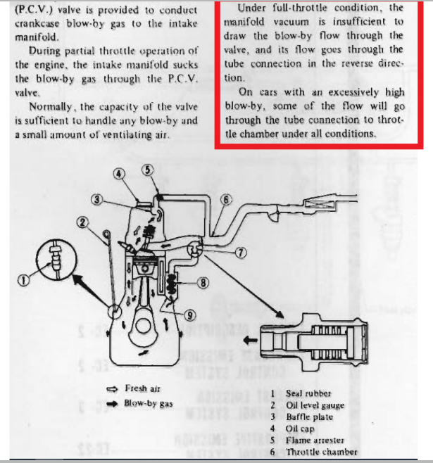

It's the hose connected to part # 7, the PCV valve, in the drawing on Page EC-2.  The Emissions chapter.  I'd post a picture but the function is broke.
It's underneath the intake manifold.
I've ordered that hose kid I've mentioned, eta is on a Monday. So ideally I'll be able to get all the hoses replaced with healthy, fresh material.
Edit: Diagram on EC-2 was a bit interesting to read, but good enough to narrow down the location. I was at least in the right vicinity.

I wanted to replace the hose under the intake manifold, being as how it had an entire side missing, but unfortunately it seems like the side that originates off the bottom of the intake manifold is way smaller of a diameter than bung it connects to at what I think is the BCDD according to the FSM. I started the car to check if either one of those bungs draw vacuum by attempting to plug them with my hand while the car was on and the end on the bottom of the intake manifold seems to do so (which I believe is the PCV valve?), while the other connecting end on the BCDD valve does not.
 Here's an interesting discovery I made:
The engine will idle and run on its own without dying (while continuing to feel like its misfiring) so long as that bung under the intake manifold (PCV valve?) remains open to just suck air in...weird isn't it?
If I plug it, the car will go back to what it was doing, running more rough than it already does, and eventually dying if I don't tap the gas when the rpm's get low.

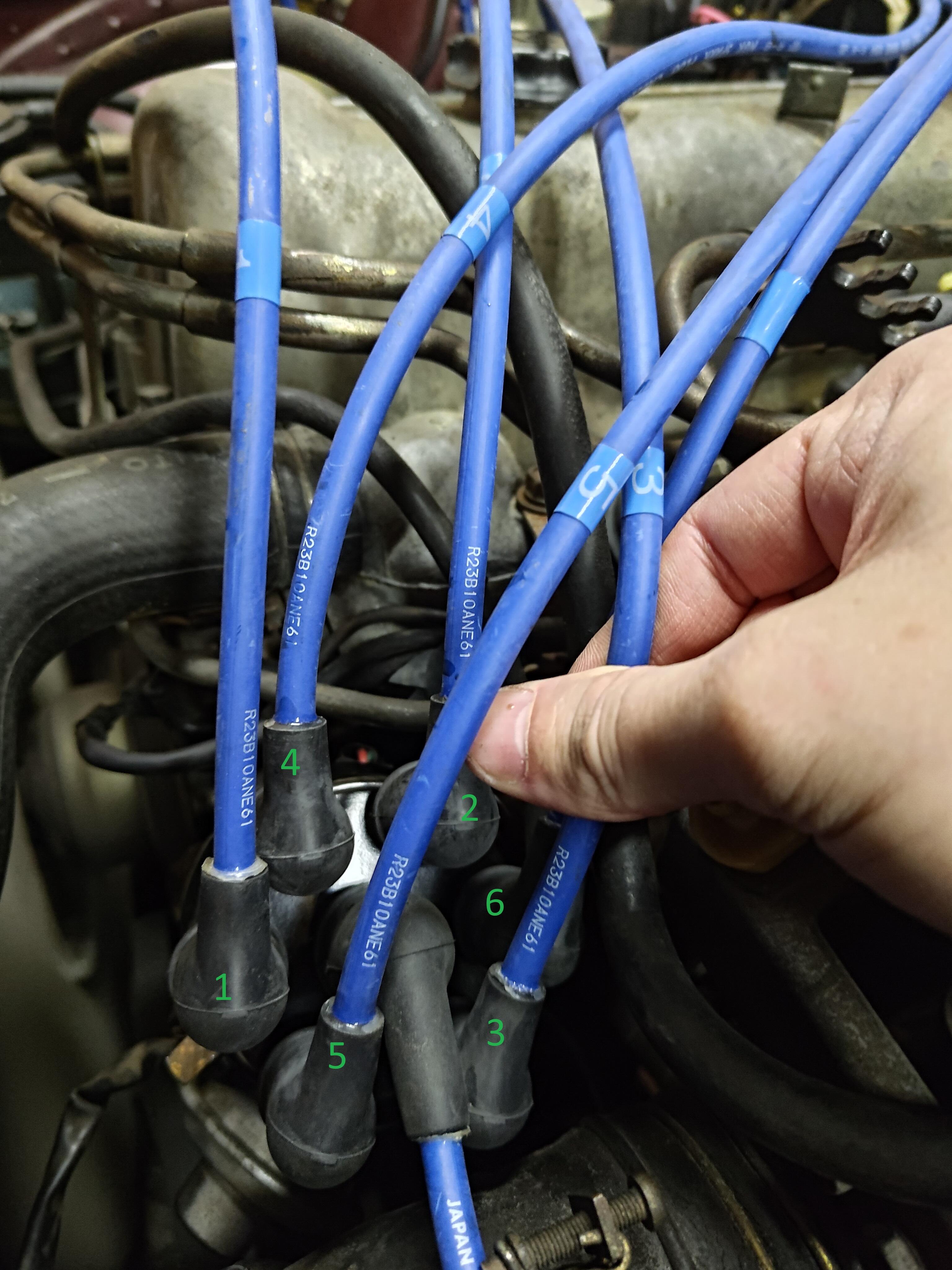

So part of me wanted to check and make sure I have the distributor on right, even though I've checked it before. Can someone verify I have the plug wires connected right? I'd think adjusting the distributor timing should at least prompt an audible change, but it didn't, so I want to verify I have the plugs connected right.  There isn't any line on the side of this distributor cap to aid in any markings of the cylinders.
Also worth mentioning, The car had been running a brand new set of plugs for maybe an extreme total of an hour runtime over the combined past few months of troubleshooting. I checked them and they were black, soot/charcoal black. Absolutely covered. I replaced them with a fresh set today.
Plug wires as they sit:
If anyone has any ideas on what to do further, I'd greatly appreciate it.

That's the PCV valve, not the BCDD.
Yes, the PCV hose from the block to the PV is a specially formed hose.  Yarb referred to it above.  Small one end, big on the other.
When things aren't tuned well the engine will often be non-responsive to tuning efforts.  Kind of a vicious cycle, a rabbit hole.  The missing and break up at higher PRM are probably due to the massive vacccum leak through the PCV valve under the intake manifold and also through the hole in the block.  Air can enter the crankcase through the hole in the side of the block and travel through the engine to the intake manifold.
You can either block the two PCV holes, or get the proper hoses connected.  The EFI system will not work correctly with a partially intact system.
Your firing order is correct.  One possible reason for no change might be that the timing is very retarded.  You need to get a timing light and see where it is.  You'll also be able to see if it's changing when you move the distributor.
