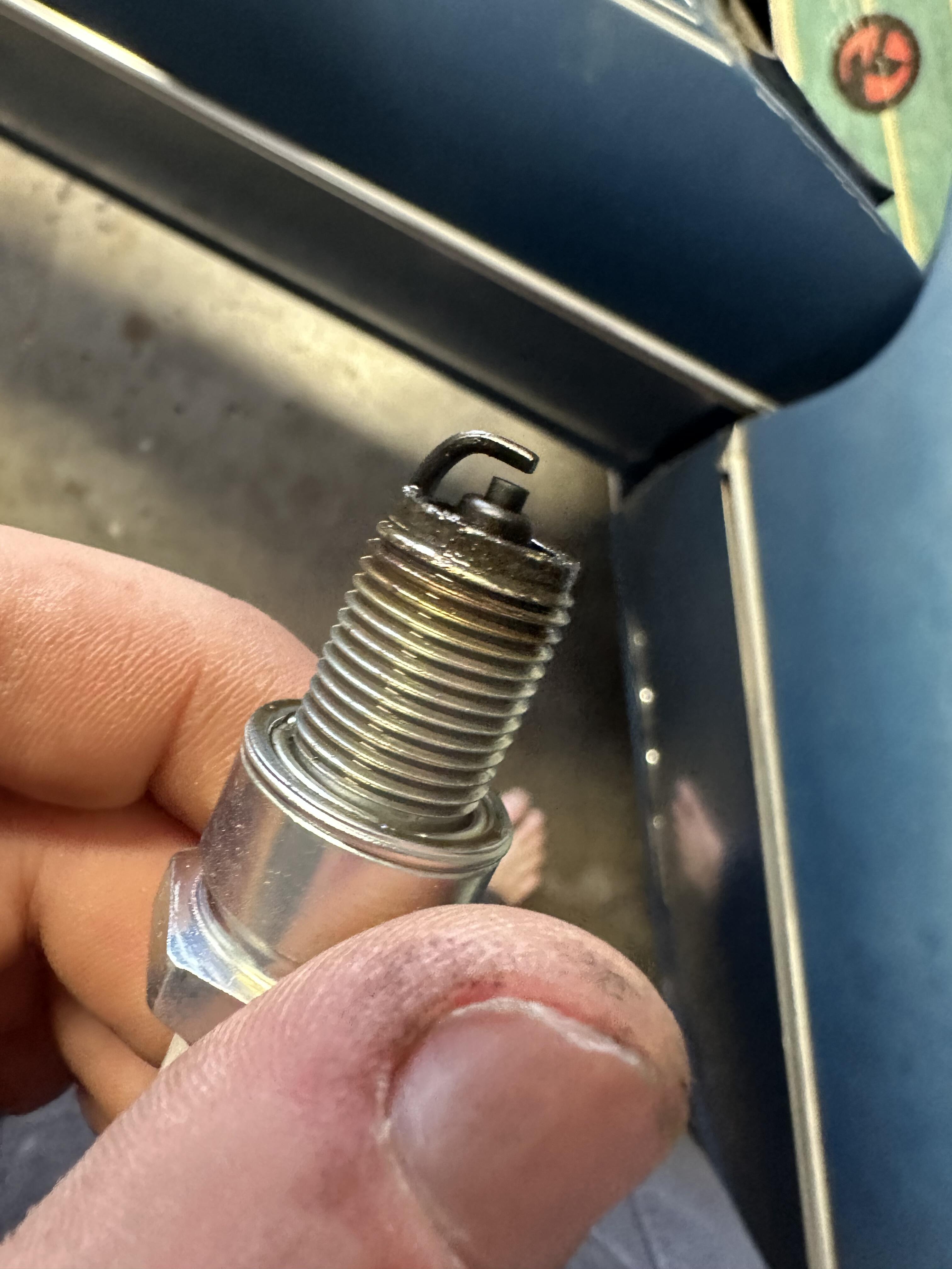

You got me onto the right track @Zed Head. Sad to say it is a bad day, a very bad day. Anyways, pulled #1 plug again and really paid attention. I determined the fluid was oil and not gas. The head gasket looked possible. Okay, compared the smell to the dipstick, and man it matched, so the fluid was indeed not gas. Did a compression check and shows 0psi with the throttle fully depressed. Really was thinking head gasket at this point. All other cylinders showed close to 160psi. Should have just done a compression check first, but the motor has like 300 miles or less on it since a head rebuild, and usually its the Bosche system giving me hell.

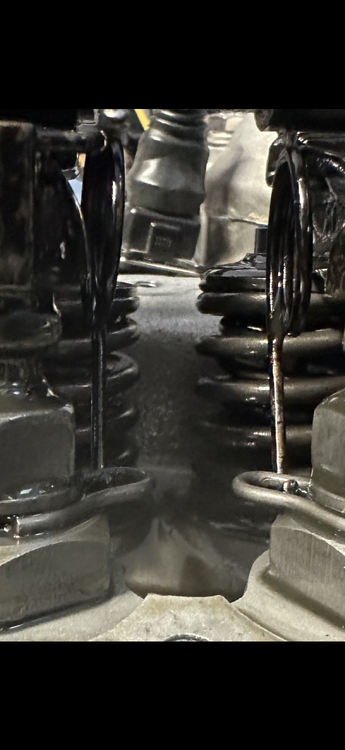

I pulled the valve cover again and performed a closer look. To me, it looks like the intake valve on #1 is stuck slightly open. I have a photo showing the spring looking like it is not all the way up when both cam lobes aren't touching.. I Wish I had a leak down tester to properly diagnose. I am thinking that the valve is bent. I would assume this would be from valve float, but I really did not push the engine hard yesterday, and that would cause immediate damage, not appear once parked.

Turn the engine over by hand and see what the valves do.  If a valve stays down you should be able to pop the rocker arm off.  Might be able to grab the stem and spring retainer and pull it up.  Maybe it's something simple like a broken or weak valve spring.  Or a rolled over valve seal.  It's odd that you would have oil in the cylinder after sitting overnight unless a valve seal wasn't doing its job.  Get #1 up on the compression stroke and that should give the most space between cam lobe and rocker arm.
Hoping for damaged valve seal and no bent valve...
Will check it out later today. Darnit just retorqued the valve cover. Here is a photo of the plug. Really at this point head has to come off anyways:/

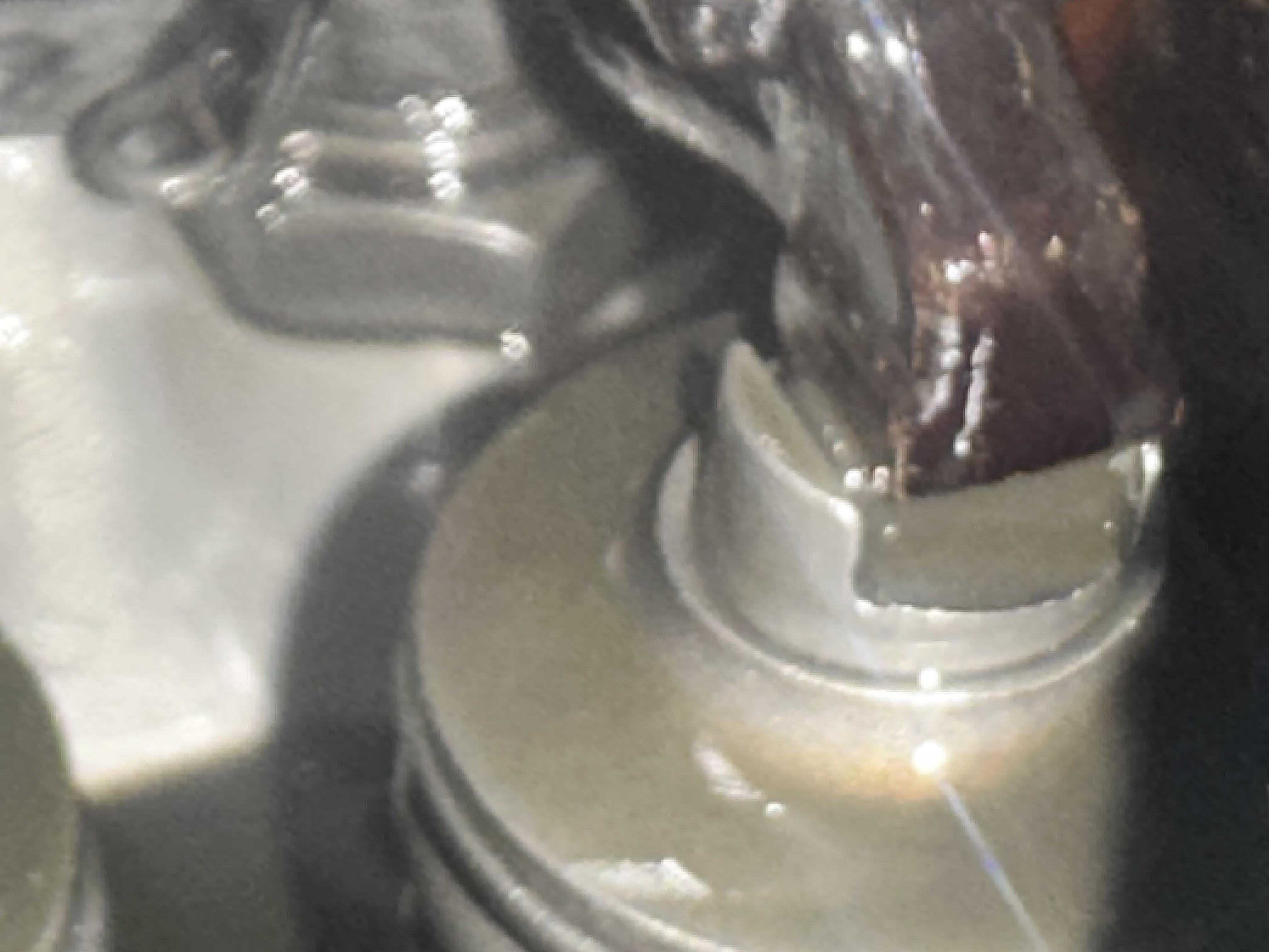

I found this on someone's car about a year ago. Cylinder 2 was reporting zero compression. The valve was mis-adjusted and the lash pad eventually turned on its side.
Mystery solved @Zed Head @SteveJ thank you both. You got it, Steve. Pulled the valve cover again and took a look. The rocker had jumped off the lash pad to rest on top of it. Not sure how I missed this obvious problem.  Anyways, popped it back in place, cleaned the spark plugs, and it now runs like a top. It is cammed and I checked the valve lash and it actually looked perfect for the stage one Comp Cam. Not sure how it popped off then? Must have happened on start-up yesterday, somehow.
Any ideas on why this may occur? I will see if that ticking noise is gone for good once it's cold. I haven't heard it since during this process. It is possible that maybe the rocker had been working its way off for a while, and reached its final straw. Still no conclusions for the oil on plug. Could be that the rocker wash pushing valve at an angle. No smoke out tailpipe again.
