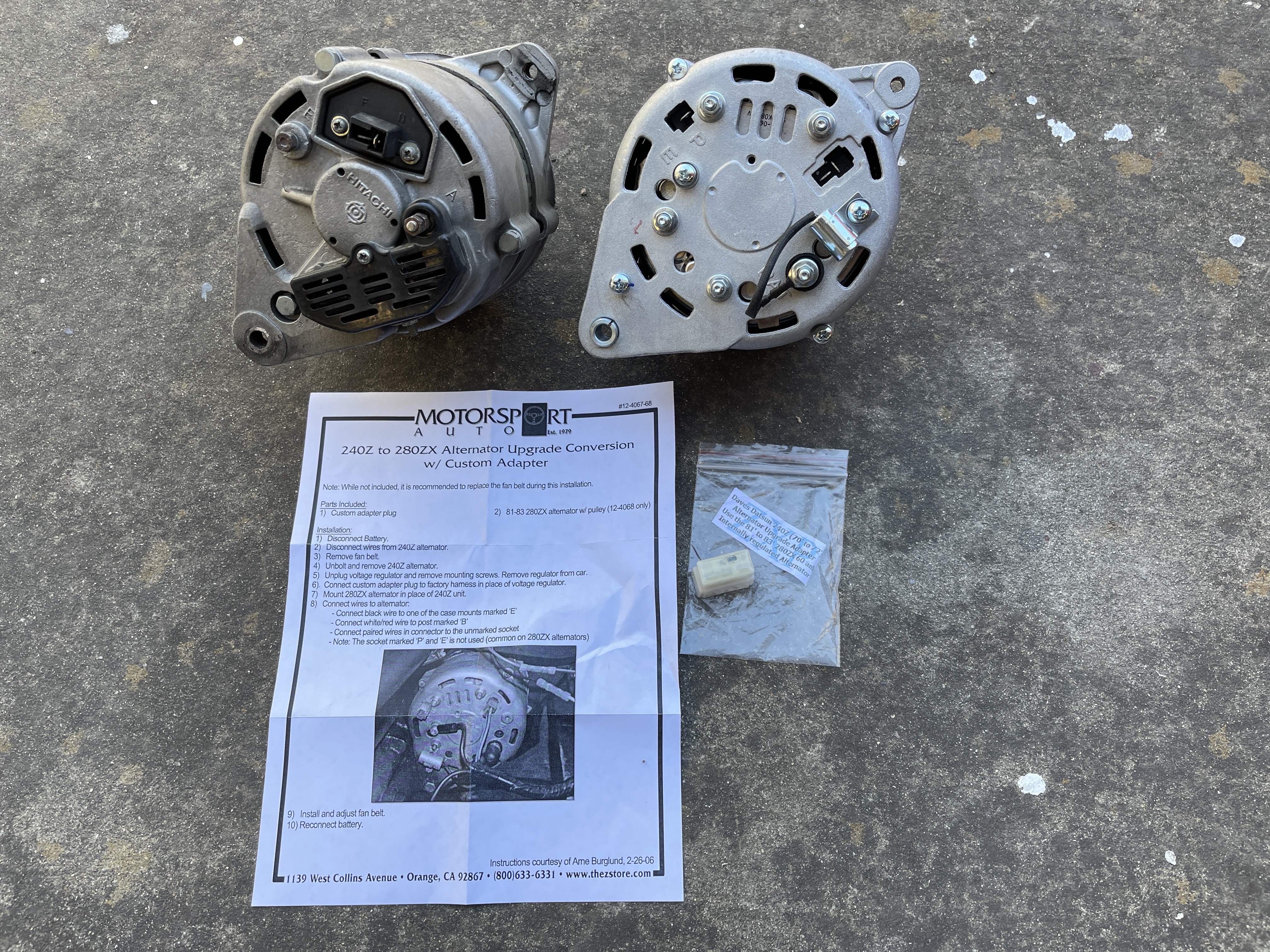

So here's the old and new internally regulated alternator, Dave's plug, and instructions, from MSA.

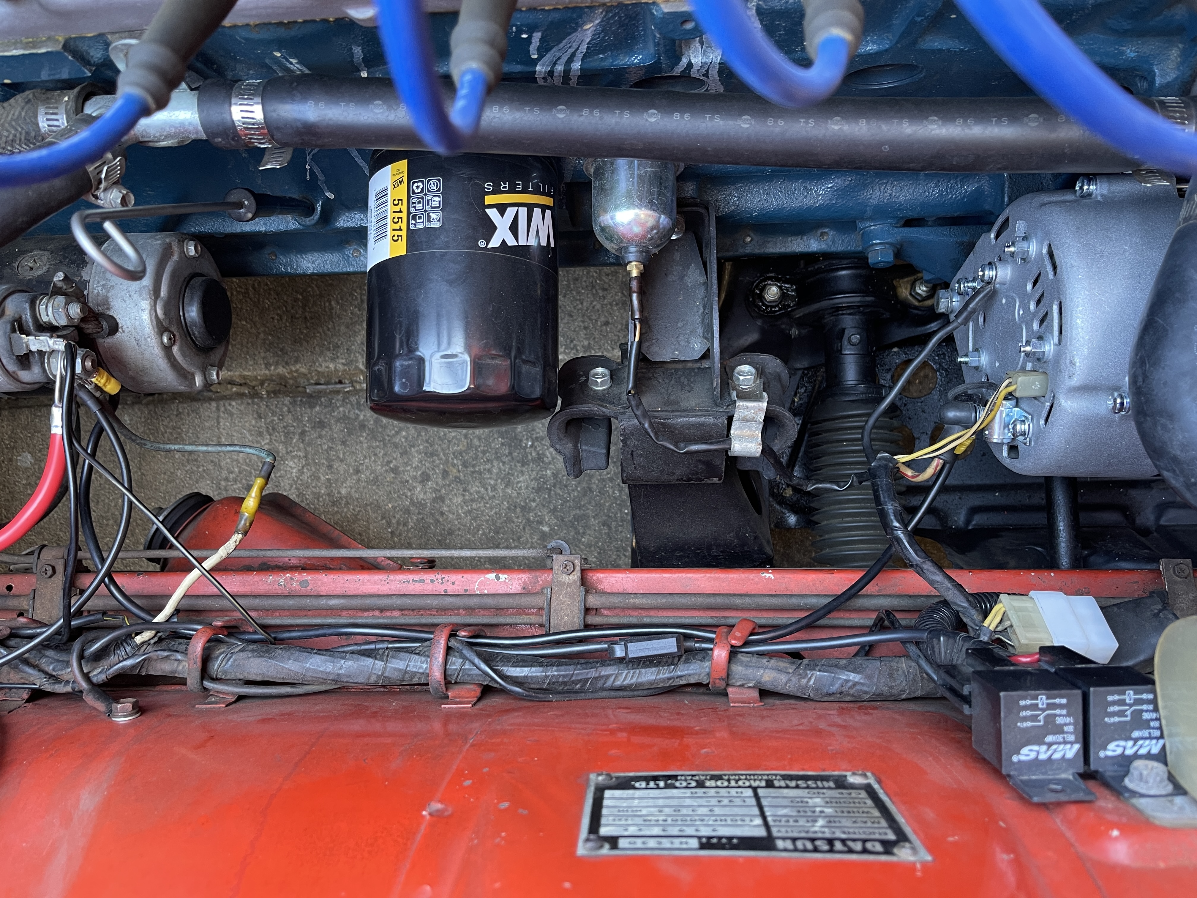

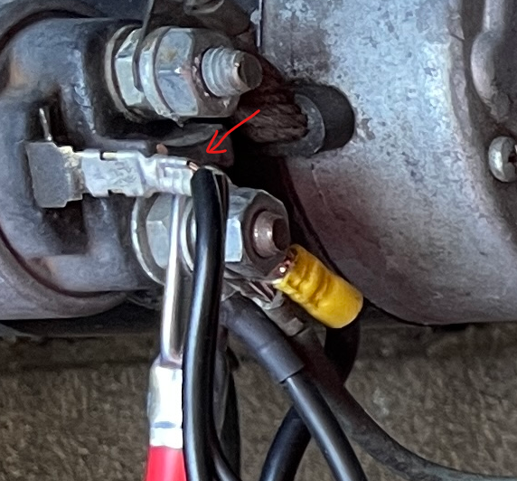

Here's the installed setup.  Seems to work fine.  My starter connection is getting a bit crowded with all the relay connections.  The Pertronix seems to be work better, but maybe it's my imagination.  Amp gauge moves a tiny bit at idle, and little more with hazards on.
Anyway, I just want to make sure I'm good and won't burn my car down!  😏

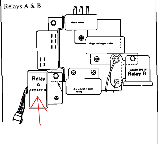

Okay, your car probably has the fuel pump relay modification. It looks like you have two wires at the starter solenoid.
There is no need to cut any wires! Just unplug Relay A.
The relay is located on the passenger kick panel. If the relay is plugged in and you have that alternator mod, you will run your battery down.

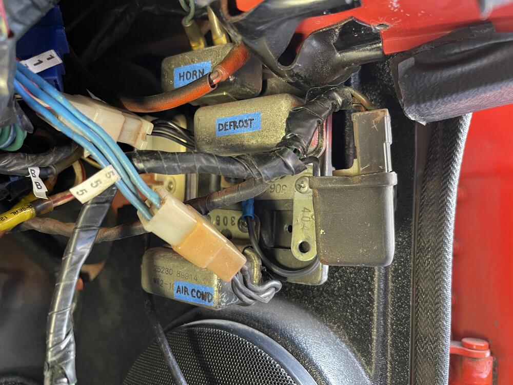

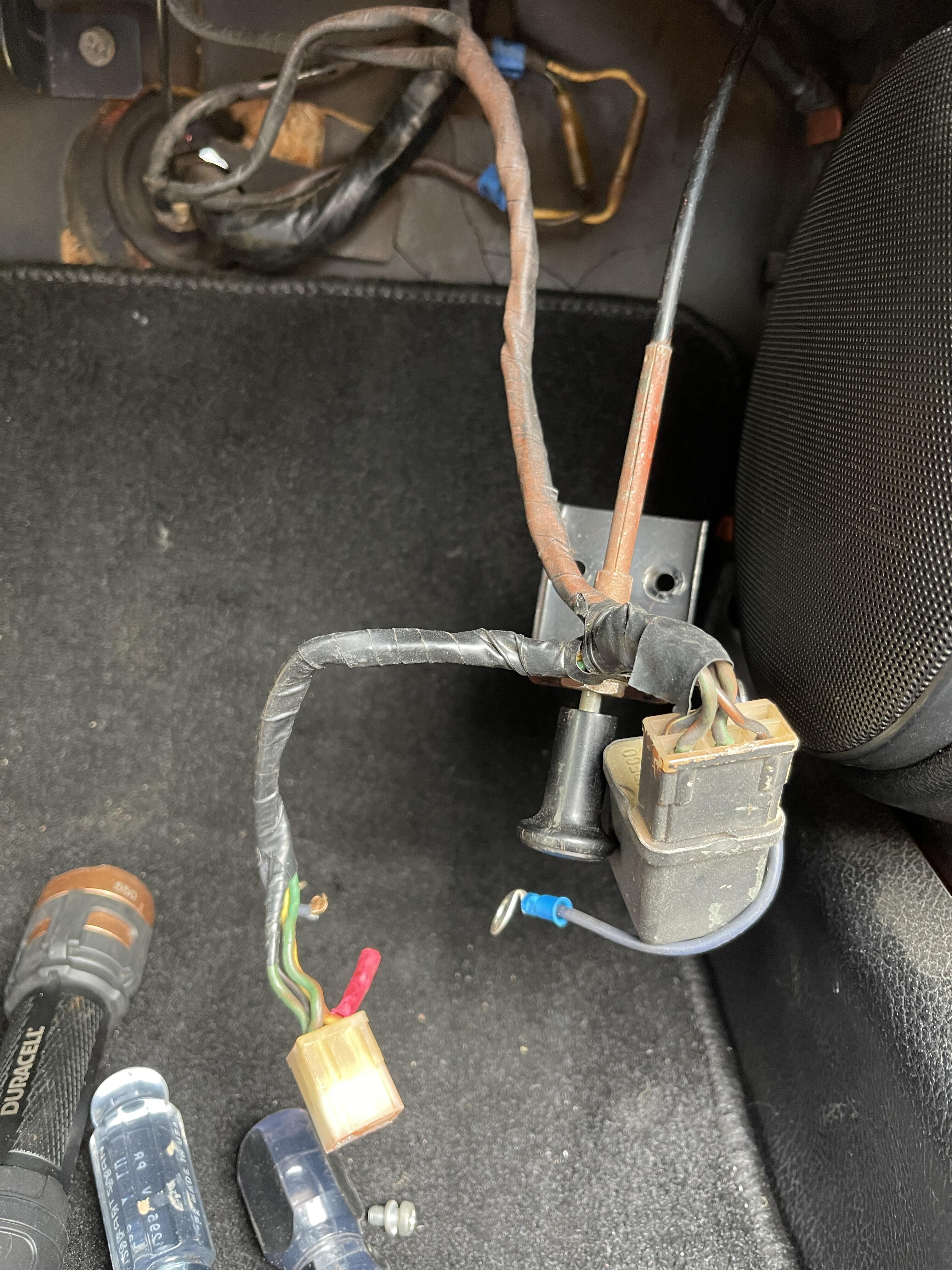

Okay, took some time to cleanup the relay bracket, some were screwed in the wrong location, and labeled them.   It looks like relay A is missing, but B is there.IMG_8565.JPG
This must be part of the fuel pump harness fix, goes out to the starter solenoid and fuse box/ignition.  The relay A connector looks a bit hacked.  Maybe I'll remove it altogether some day.  Battery seemed fine this morning, engine cranked over as usual.

Based on your photos, I concur with your assessment. With Relay A gone, you have no problem with the alternator upgrade.
