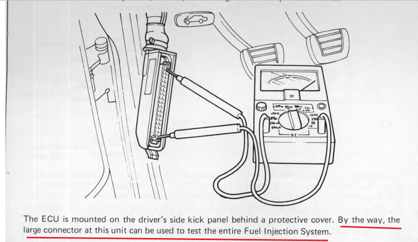

Sitting in the driver's seat the plastic panel would be directly left of your left knee.  It has a rectangular hole in it that allows you to see the tag on the ECU.  There are two or three screws holding it, one of them does not need to be removed all of the way.
Borrowed this from the BAT 8000 mile Z.
I thought the coolant temperature sensor was the one that screws into the block close to where the upper radiator hose attaches to the block. Is the coolant temperature probe you are talking about part of large plug that plugs into the ECU? Thanks!
When you check the wires at the ECU you're checking exactly what the ECU sees.  If it's not right then you move down the wires to find the source of the wrong numbers.
