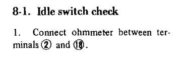

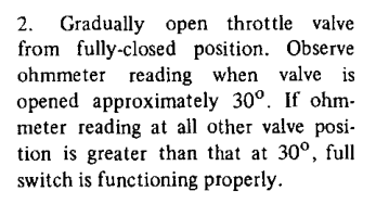

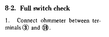

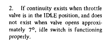

That's a good point Cliff.  I glossed over the fact that the TPS was connected before but is not now.  Having the TPS disconnected would be like having the throttle pedal partially open.  No idle enrichment and no full throttle enrichment.  According to the FSM.  Not clear what "bypassed " means though, above.
Another switch that might be disconnected is the AFM plug.  Not uncommon for it to fall off as you're trying to get the AFM plugged in and back in its hole.
Really at this point it would be a good idea to go through the electrical tests in the EFI Guide Book.  Lots of other stuff that could be unplugged and affecting things.  Coolant temperature sensor, for example.
Electrical tests here.  Good practice with the meter.
Nissan has some weird formatting in the FSM.

According to the FSM there are three states for the switch.  Idle contact (2) connected to 18, full throttle contact (3) connected to 18, and none of the contacts connected to anything (inside the switch).  There is no state where 2 is connected to 3.  So what you described is an odd thing.

Regarding the TPS bypass i thought that by connecting a wire between full throttle and idle it would give me neither and therefore bypassing it. I think I seen / read somewhere someone doing that but.. now looking at the diagram above that wouldnt do anything to anything haha I think I am gonna have to go back over that then and see if it makes a difference to anything at all

You said that you tested the TPS (actually TVS).  Did you test at the ECU connector?  Best to do all tests at the ECU connector as described in the 1980 EFI Book I linked above.
