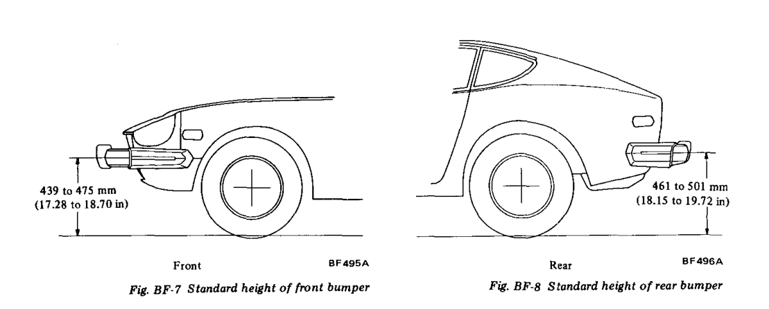

Since they increased the ride height on the rear of the car for the 280 means that when it was sold new it had a bit of a rake to it where the rear was higher than the front then?
55 minutes ago, EuroDat said:
I have no idea why they increased the height on the US version 260Z and the 280Z.
I think it was so the bumpers would be at the regulated height.

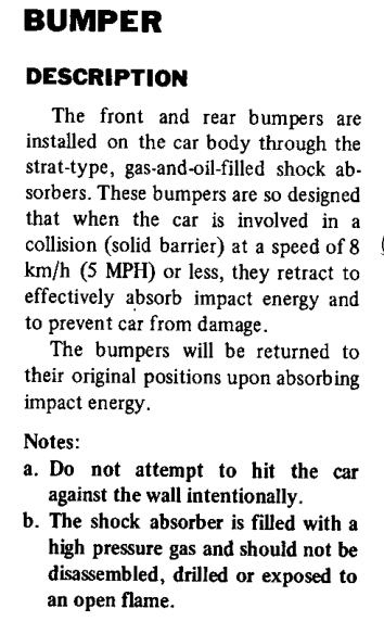

Found an interesting Hagerty article.  I've also read somewhere that part of the reason for the big bumpers was for insurance purposes.  The insurance companies were paying out too much for minor parking lot bumper bumps.  Can't remember where I read it but it stuck in my brain.  A congressman was involved.  They're called "safety bumpers" but the safety is for the insurance companies.  5 mph.
It seems so.  There's overlap though.  Kind of doesn't make sense in light of the 5 mph requirement.  The front bumper is usually hitting the back bumper of the car ahead.  Bureaucratic nonsense.

It sounded like from your post/the fsm pic that adding their spacer to get back to 'stock' ride height for the 280 gave it a rake out of the factory where the body was higher in the back than the front and not using the spacer would get you/us a level-sitting car, no?
Well, there's bumper height and then there's body level.  I guess rake might be measured by wheel arch gap?  Don't know.  It's a visual thing.
