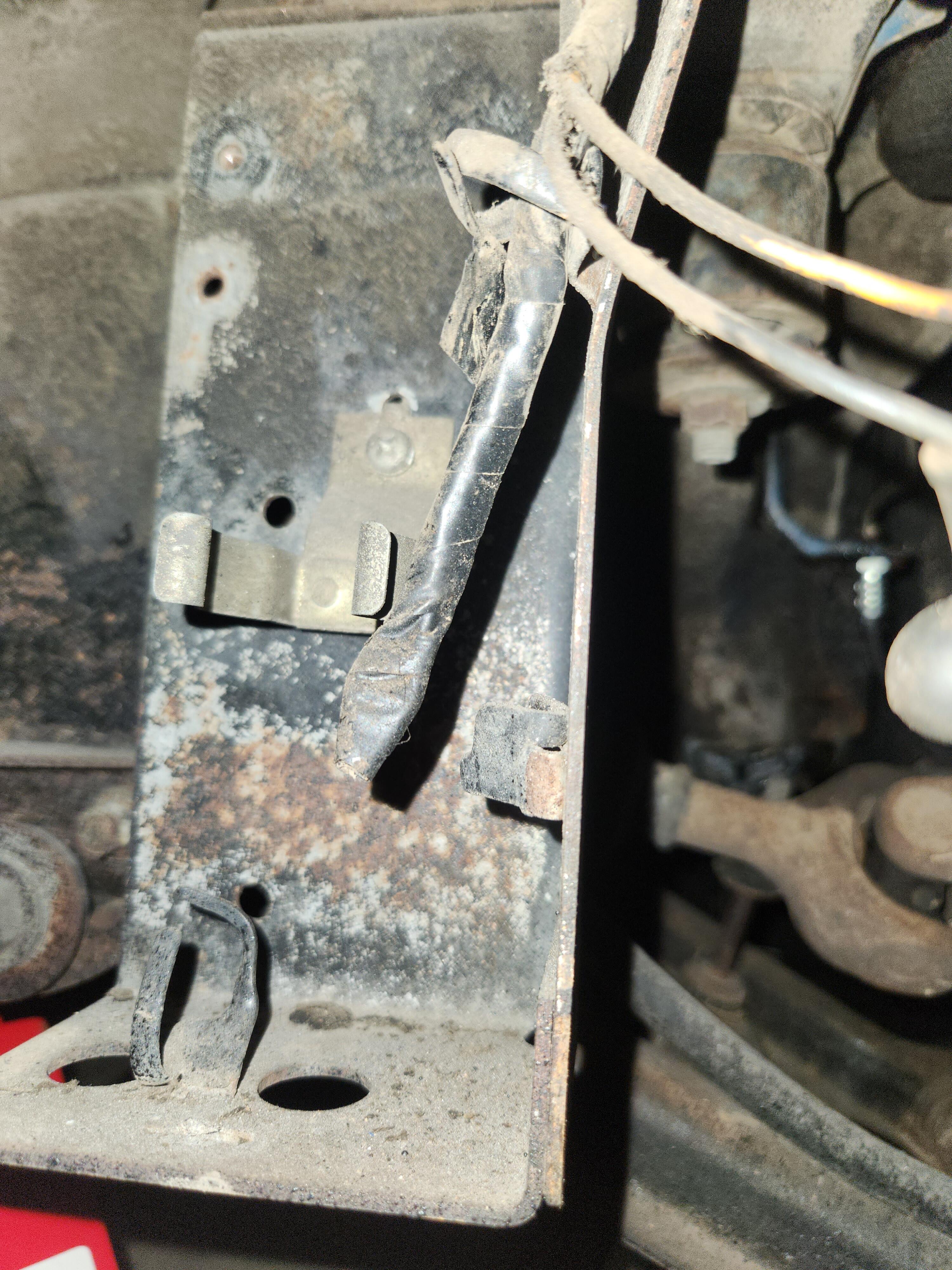

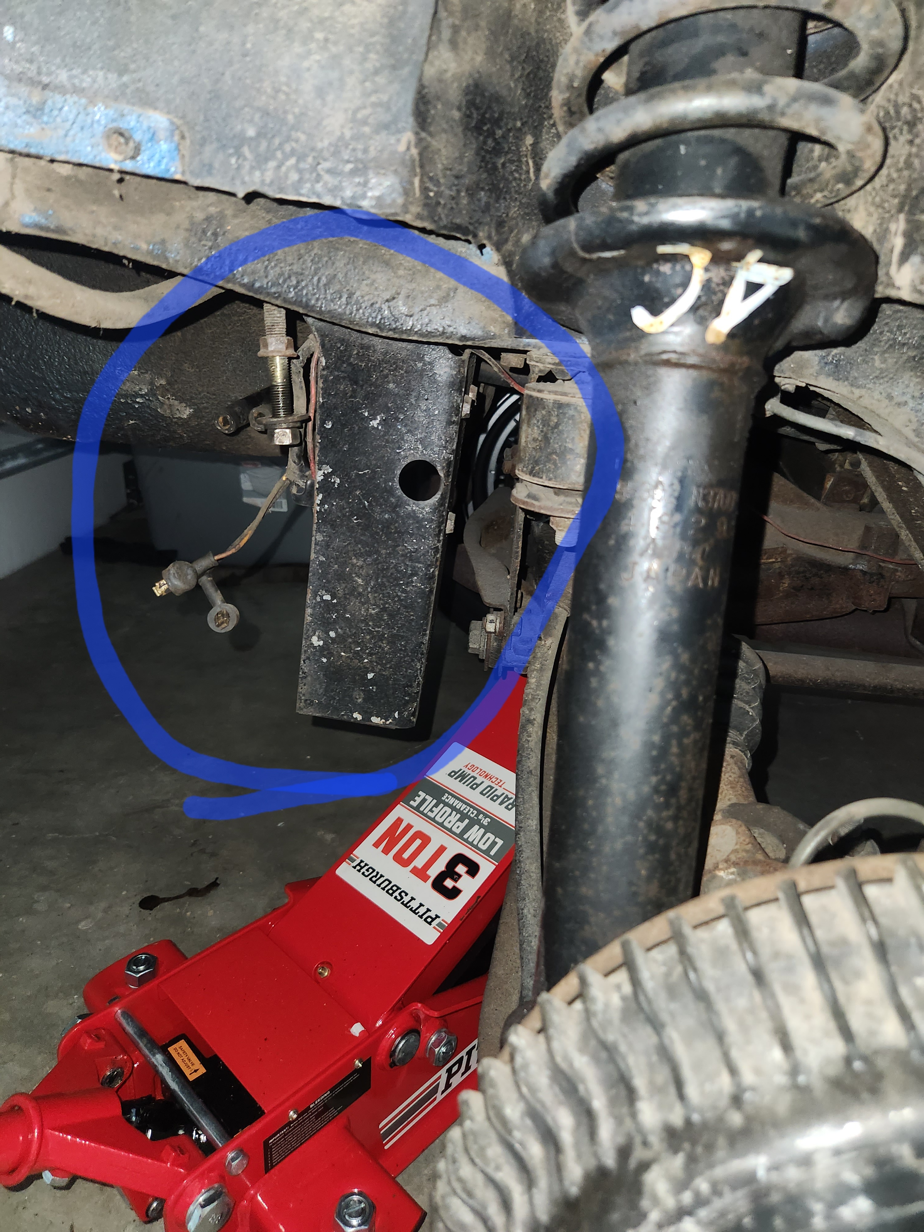

While taking the gas tank off our 260z 2+2, 4/74 build date, I noticed a bracket that is not currently used. I looked through the FSM and didnt see this. Can someone tell me what this was for originally?
It was for the helper electric fuel pump. If you don't want it, I'll buy it from you for $40+shipping. If you're going to use an electric fuel pump, then keep it.
Thanks for the answer. I didn't even know that was an option. I think i'll keep it for now incase I need to add that later. The car seems to run well with the mechanical fuel pump, but I do have to crank the starter for a while when its cold then it finally sputters to life. I could see how an electric fuel pump could help prime the system. Will read up on this. Thanks again!

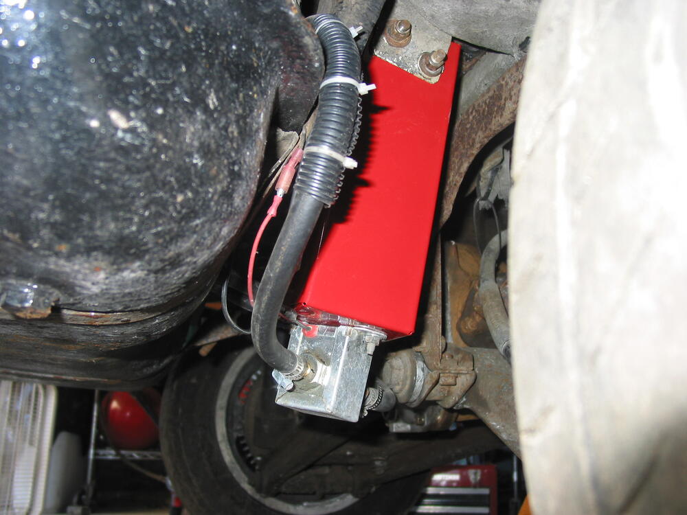

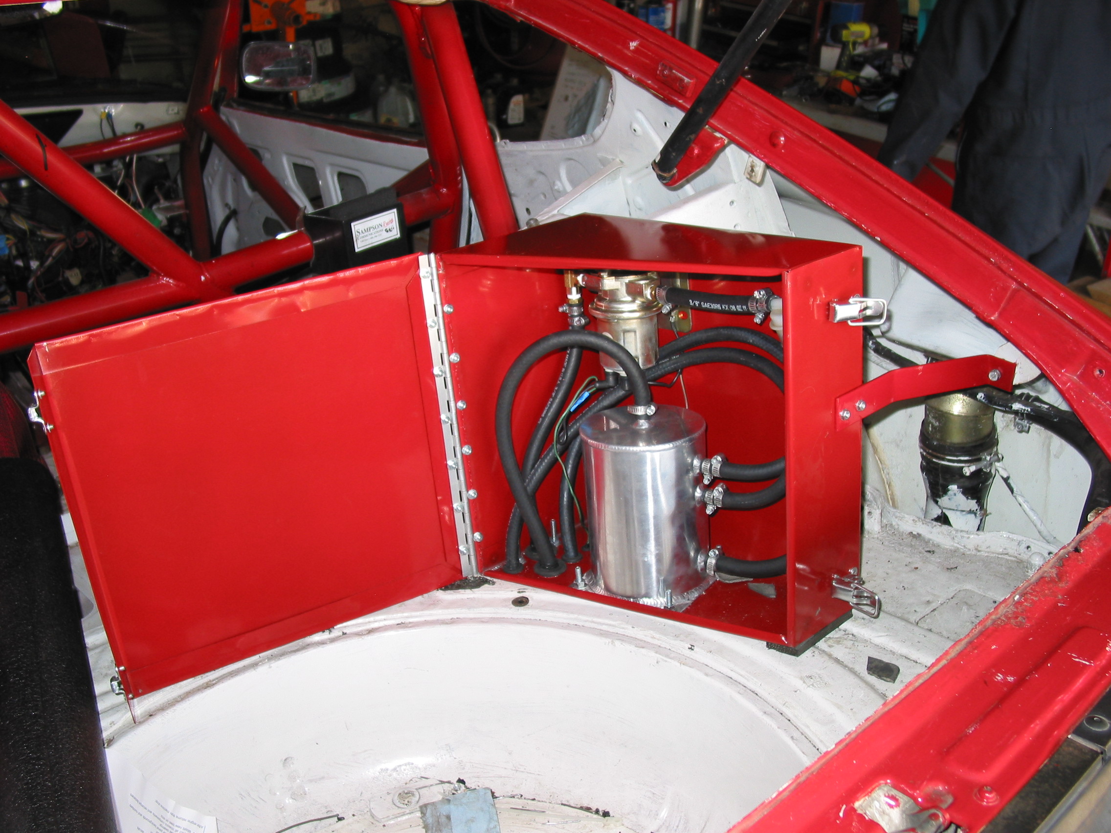

On my race car, I made a drop bracket for the Facet fuel pump so it would prime better when hot.  That pump just moved the fuel into the swirl tank where another pump fed the engine.  The drop bracket really helped on hot restarts after fuel stops.

Ironically, if you look in the EF section of the FSM, you'll find that the power to the fuel pump is cut during cranking. You don't say what carburetors you are using, but there should be enough fuel in the float bowls for starting.
Thats very interesting and good point about there being enough fuel in the float bowls. We have roundtop SU carbs.  I'll have to study this more closely after I get the tank back. We took the gas tank to a local radiator shop to be cleaned out and sealed. I was looking through the FSM after you replied yesterday and one thing I noticed is the wires that go to that bracket on my car, don't match the colors shown in the FSM and they're routed back in a peculiar way that doesnt look stock. Looks like a previous owner may have added some wiring for a fuelpump then removed it. I'll need to trace that back and see whats going on. Thanks again!
