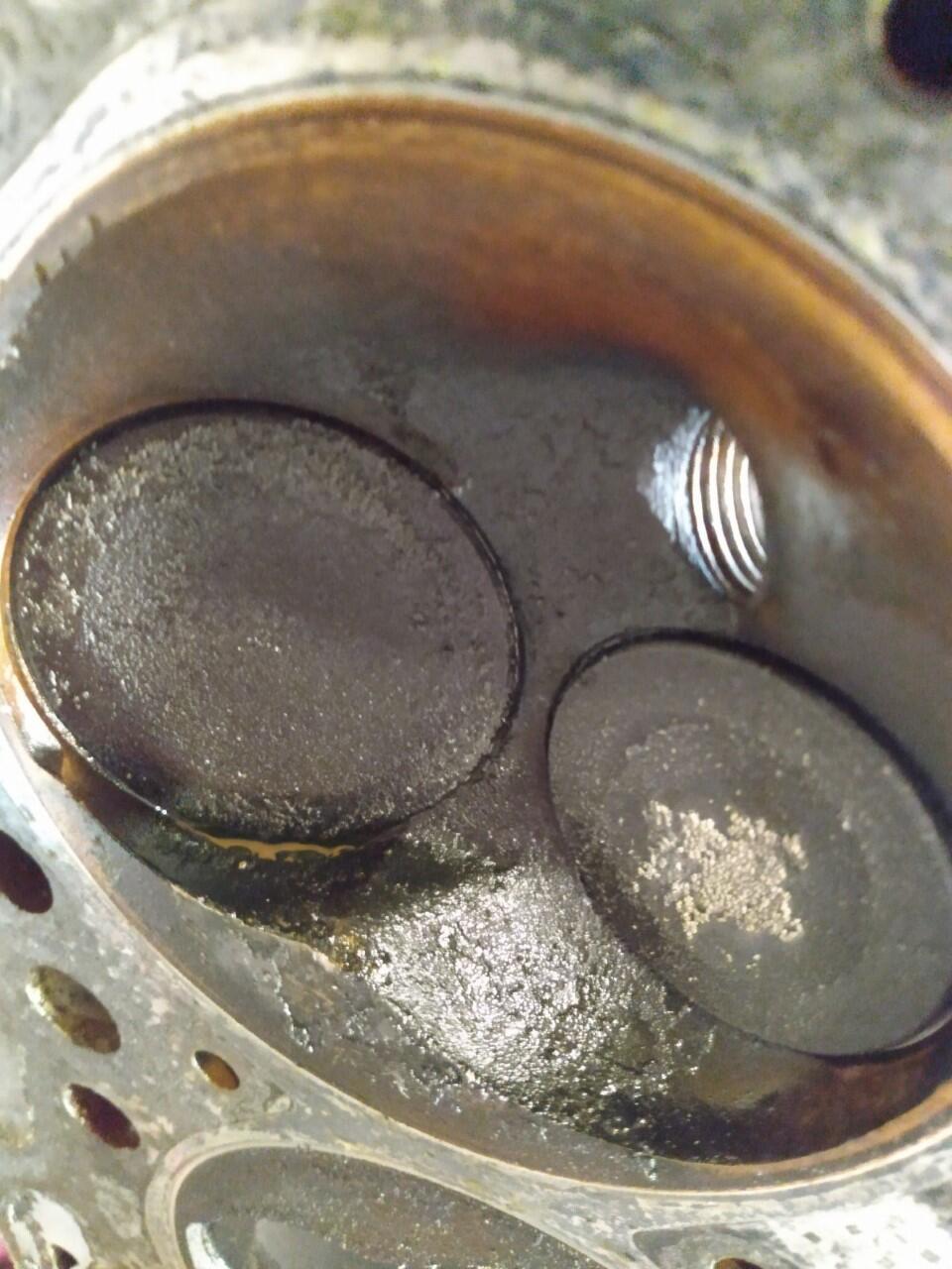

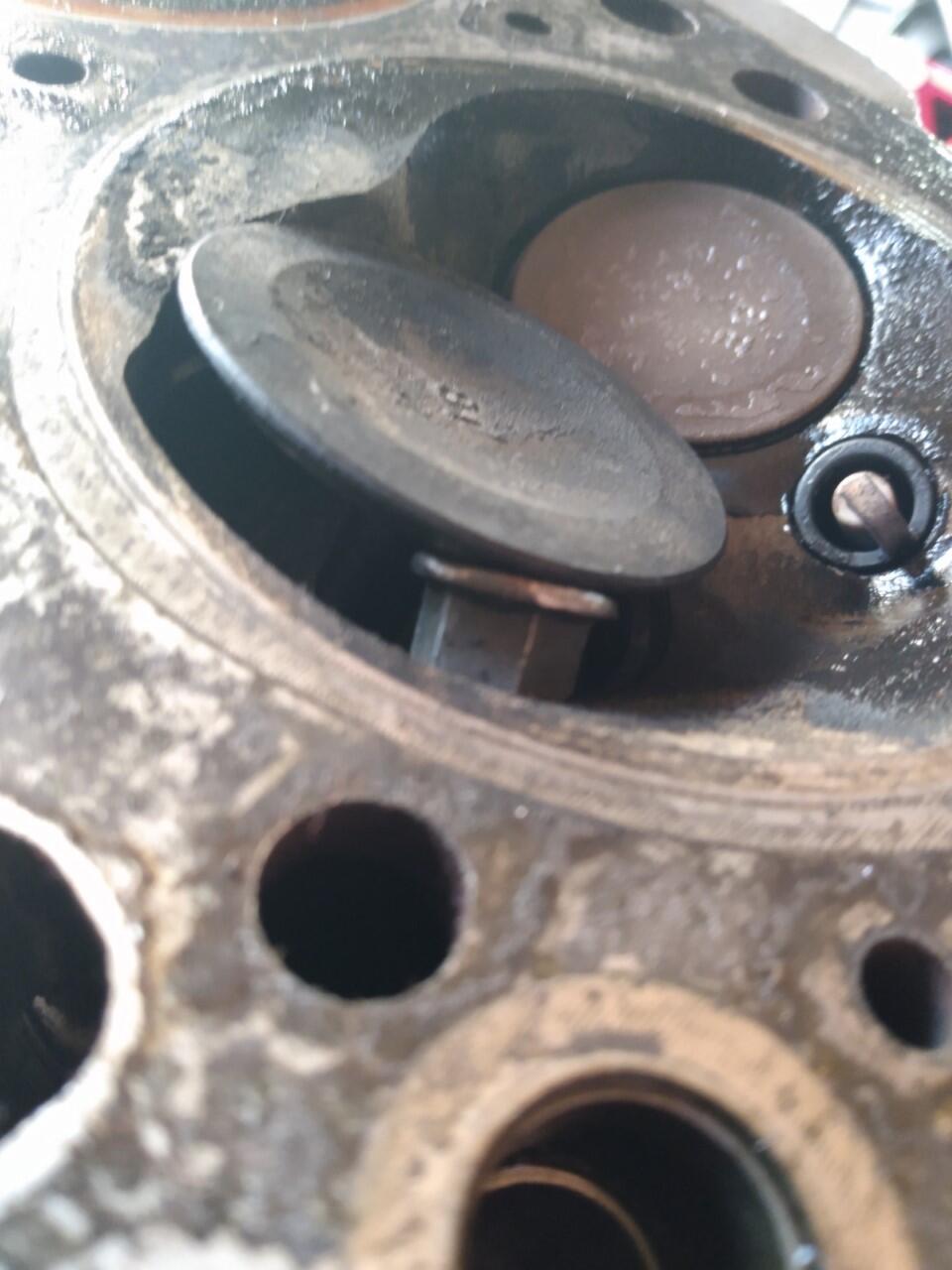

This didn't happen to my Z, but i thought you guys would find this amusing.  I have a 1991 Mazda B2200 pickup, and about a week ago it started making an awful noise just as i was pulling up to my garage.  I immediately shut the engine down.  Upon inspection I noticed one of the nuts used to hold the air cleaner assy. to the carburetor was missing.  Oh boy.

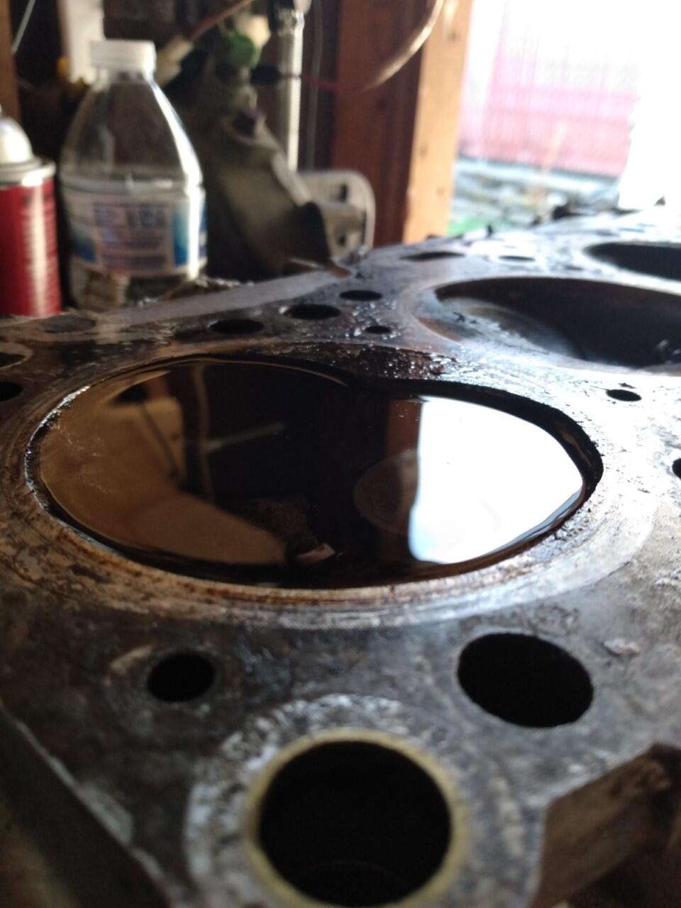

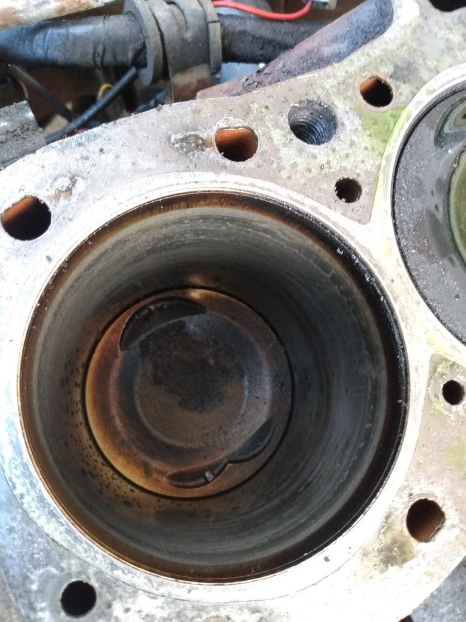

I figured it thrashed an entire cylinder, piston/valves/cylinder walls etc.  When I pulled the head I found it wedged between the valve seat and the #4 intake valve.  It never entered the bottom end or made contact with the piston.  When I removed the nut I put mineral spirits in the combustion chamber with the valves closed/head upside down and could see only a little bit of fluid escaping the seat of of the #4 intake runner.  Still enough to call it a bad seal, but trivial compared to what could've happened.  The other ones hold fluid for hours.
I ordered a new intake valve,some valve seals, and new hydraulic lash adjusters while I have the rocker arms assy. off.  I'll lap it in and hopefully it'll be ok.
