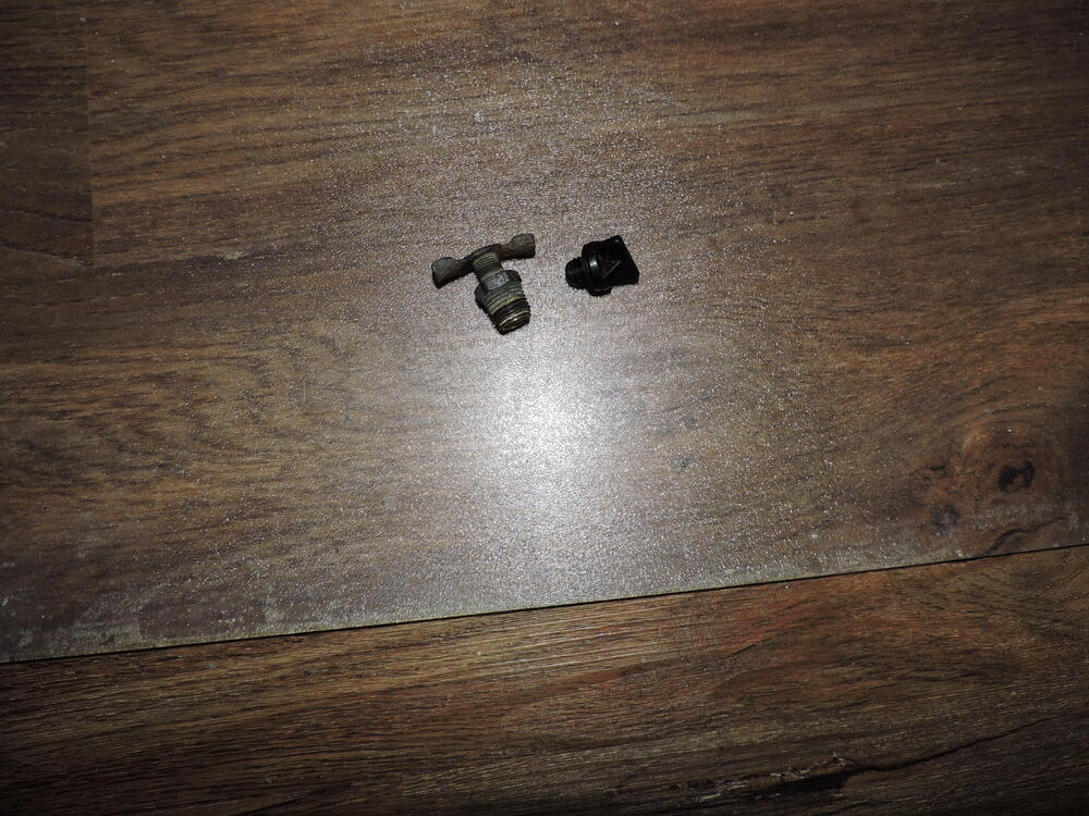

I have two 240Z rads.  I'm trying to keep the car as original as practical, but have found that one rad has a common brass petcock , while the other has a threaded plastic plug.
Can anyone tell me which is stock for a late-1971 240?

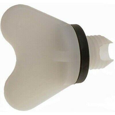

The fiche image indicates that the radiator drain plug you need is Nissan part No. 24180-18000 "Handle - Drain ****", and the sealing washer, Nissan part No. 21481-18000 "Packing- Drain ****".
