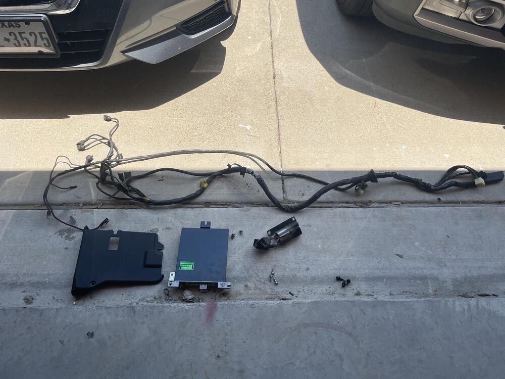

I am getting closer to dropping a rebello with SU carbs into my 77’ 280Z. I removed the EFI cables and EFI computer out of the vehicle.
Will removing the EFI computer and cables affect any other operation of the vehicle or am I good to go since I’m using carburetors?

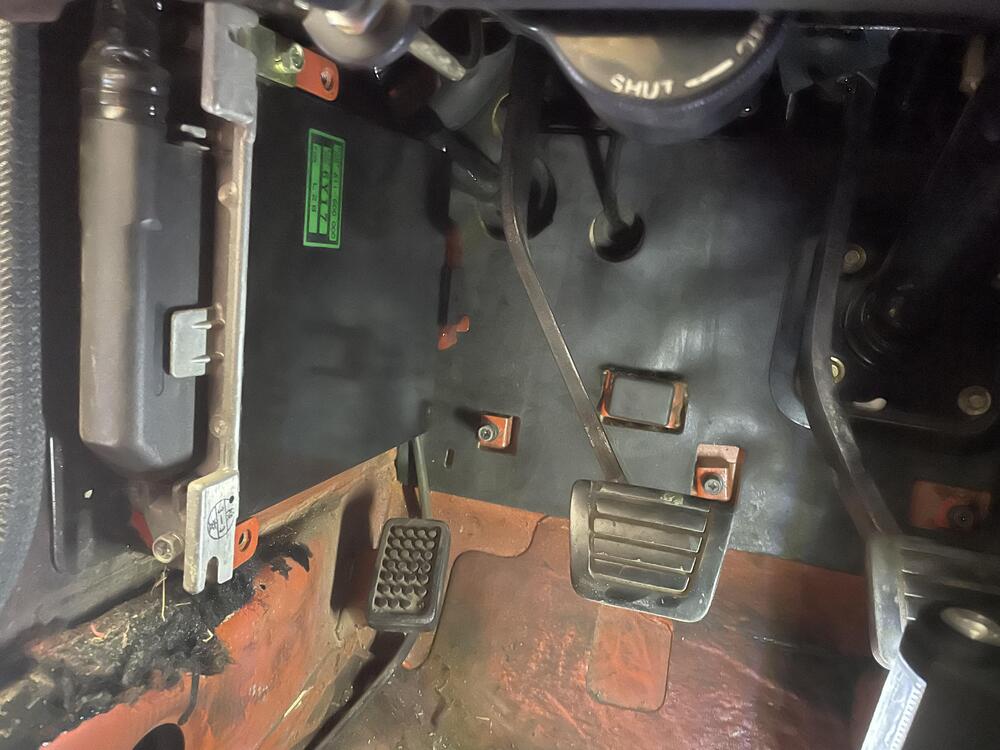

The 280z EFI system is pretty much standalone, but off the top of my head I think you would just have to wire a different switch / relay to drive the fuel pump if you’re planning to keep it electric.
