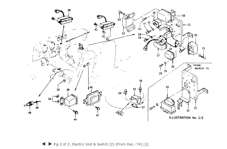

looks about right. could not find the correct PN in the car parts manual site, so not sure how to find an OE switch.

@Dave WM I think you'll find the part numbers on this page: http://www.carpartsmanual.com/datsun/Z-1969-1978/electrical/electric-unit-switch/section-2/280z.
Start around part 31 and work your way down.
Be sure to go to figure 2 of 2.

ok since it has been an intermittent issue, I think I will start with just jumping the floor switch. IF the light still acts up (stays on when not cranking) I can assume my relay is at fault. This beat me trying to do continuity test with intermittent devices.. I will just keep an eye on it for a few weeks to see how things go.
