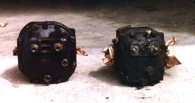

I don't know if I have an R200.. or an R180...
I have a 1978 280Z with an automatic tranny....
so my differential.. i dunno.. i think it's an open R200
