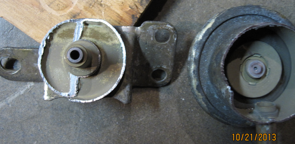

Two leaky FPR's.  I had several at one time and found that most of them leaked.  The sealing surface is metal on metal.  Any rust or imperfections will allow it to leak.
I tore one apart quite a while ago.  The tube on the left is machined flat and seats on the flat surface on the right, with the round marks on it.
