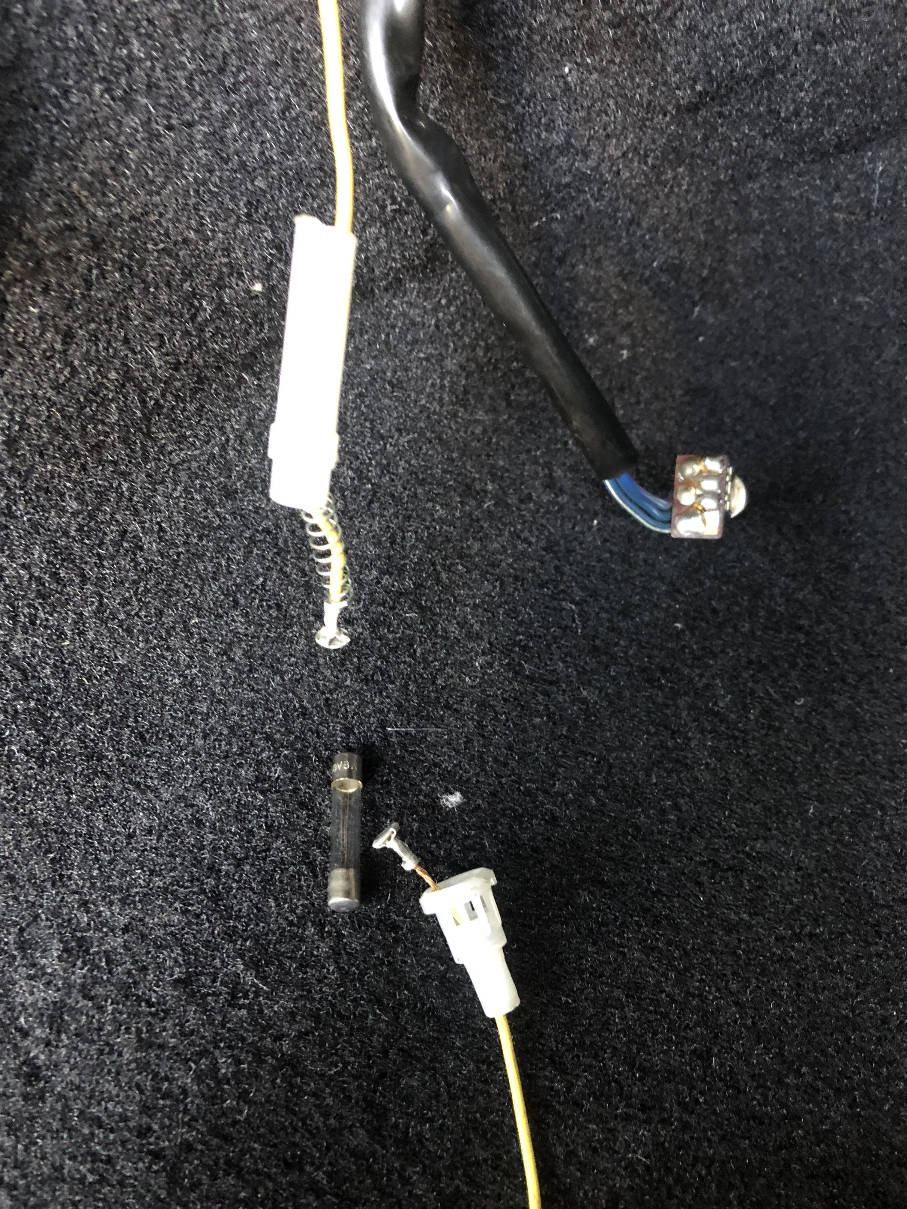

Hi Guys,
Anybody knows what u call this thing? There are two of them one on the red wire and one on yellow going to the stereo. My Stereo stopped working all together and i saw one fuse fell out due to loose holder. The other is totally damaged. What u call these?
Also, the fuse says 250v 3A? are the fuses both same as i misplaced one 🙂 why does it says 250v?
Inline glass fuse holder. I can only find pre-wired ones now. I bought some on Amazon 4 years ago that were not pre-wired, but they are no longer available.
250V is the voltage rating. Since you have a 12 volt system, there isn't a problem.
