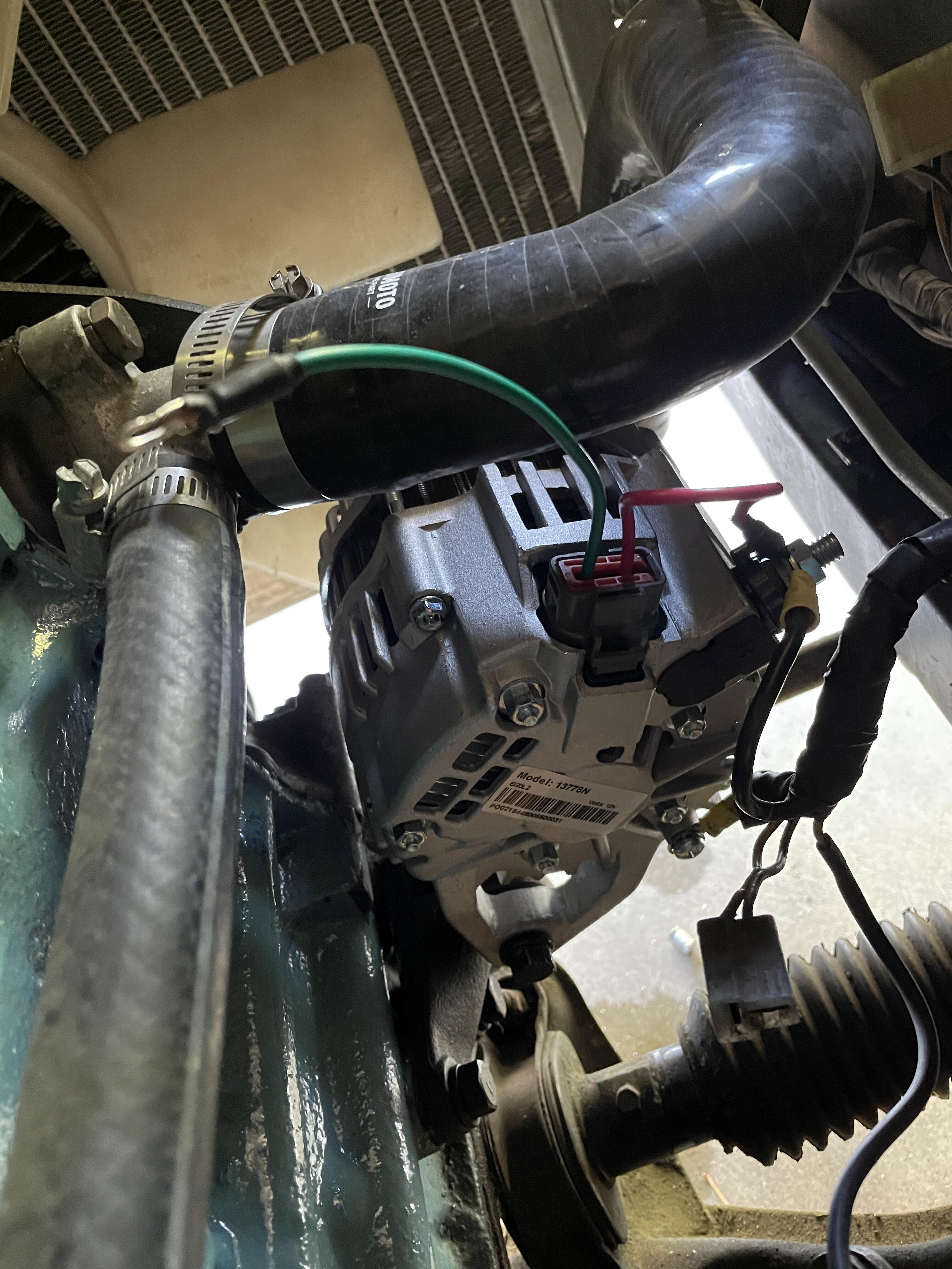

Post pictures of what you're talking about with regard to the new alternator.

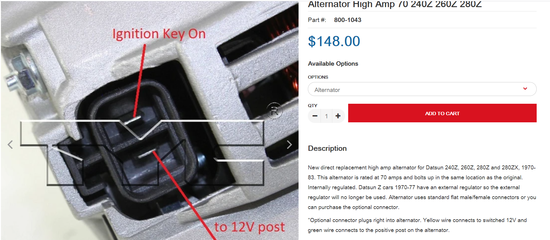

This is why I asked @RJK to post photos. What @Zed Headposted is 100% correct for a 280ZX alternator. HOWEVER, I believe @RJK could conflating the 280ZX alternator with another 70 Amp alternator sold by ZCarDepot.
This is the other alternator that is explicitly listed at ZCarDepot.
I don't think that any of the 70 amp alternators are externally regulated.  The only external is a 60.
https://zcardepot.com/search?q=alternator&type=product
https://zcardepot.com/products/alternator-reman-240z-260z-280z-510-70-77?_pos=12&_sid=673ff5c1a&_ss=r
The guy at ZCarDepot is being disingenuous in his ad copy (surprise).  He says that it is a "direct replacement".  But it's not.  Caveat emptor.  Or, also possible, the guy at ZCarDepot is ignorant of how the alternators work.
https://zcardepot.com/products/alternator-high-amp-80-240z-260z-280z?_pos=1&_sid=673ff5c1a&_ss=r&variant=19280584015985
New direct replacement high amp alternator for Datsun 240Z, 260Z, 280Z and 280ZX, 1970-83. This alternator is rated at 70 amps and bolts up in the same location as the original. Internally regulated. Datsun Z cars 1970-77 have an external regulator so the external regulator will no longer be used. Alternator uses standard flat male/female connectors or you can purchase the optional connector.
*Optional connector plugs right into alternator. Yellow wire connects to switched 12V and green wire connects to the positive post on the alternator

Ok, so this is the alternator I'm going in with:
https://zcardepot.com/collections/charging-starting/products/alternator-high-amp-80-240z-260z-280z?variant=19280584015985

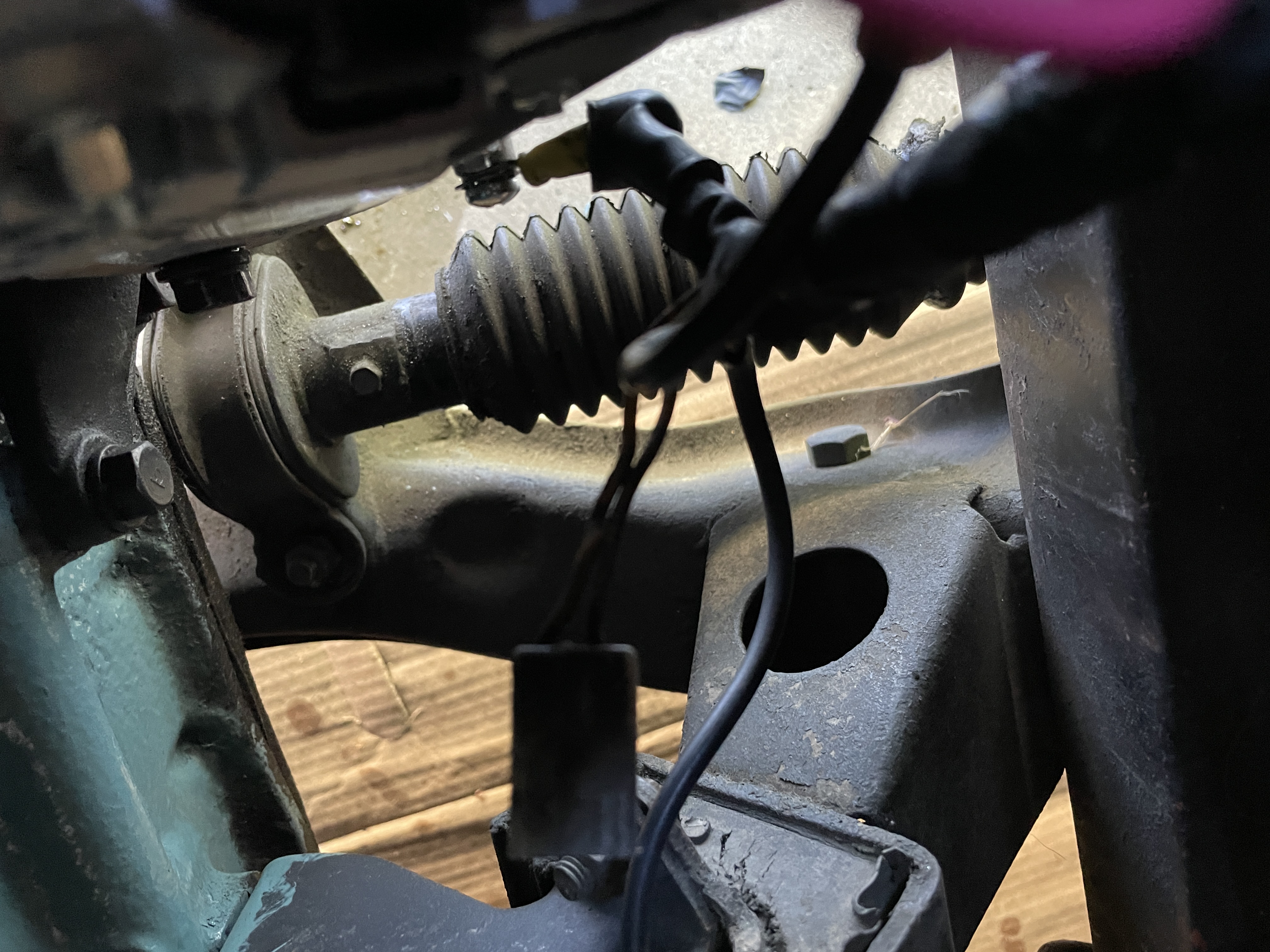

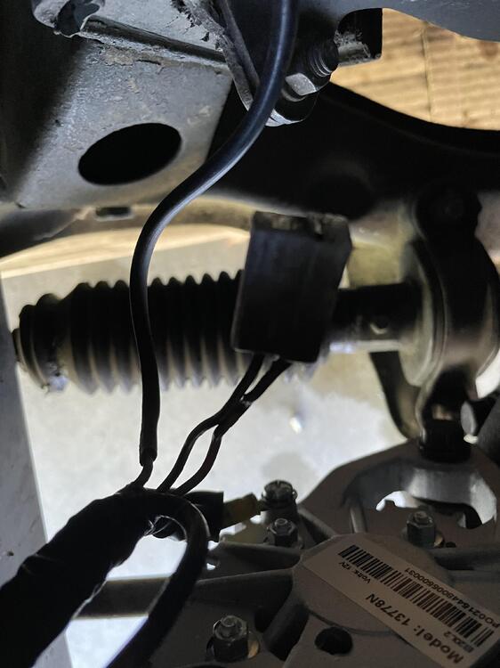

harness is kinda hard to see, but one wire is yellow, one is white/black.
Have you jumpered out the external VR?
For the switched wired, you may want to get a 6.3mm 2 pin connector from http://vintageconnections.com/Products/Connectors
On the wiring harness T connector, the vertical part of the T is the switched wire. As @Zed Head said, you will probably need a diode on the switched wire, otherwise, you may backfeed the ignition circuit. The arrow (line) on the diode points toward the alternator. The diode can go between the green wire and the connector, or it can be integrated into the jumper for remove the external VR from the circuit.
SteveJ, I think that he has been bamboozled by the "direct replacement" words on the ZCD site.
The instructions on the ZCD site are incomplete/wrong.  And you could have bought a 60 amp 1978 280Z alternator at your local parts store for about $65.  You do get an extra 10 amps though.
Not worth trying to get a refund.  Read that atlanticz link.
