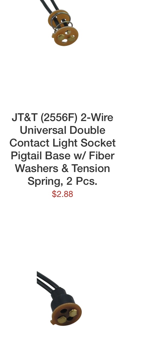

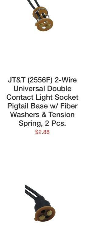

Yes, I think a video will be best especially for me who usually needs some visual. There are two options one with a spring and the other with a boot, which do I purchase? I also have a crimping tool but the most basic one, if needed I can go to home-depot and buy a wrench action one. Thank you.
