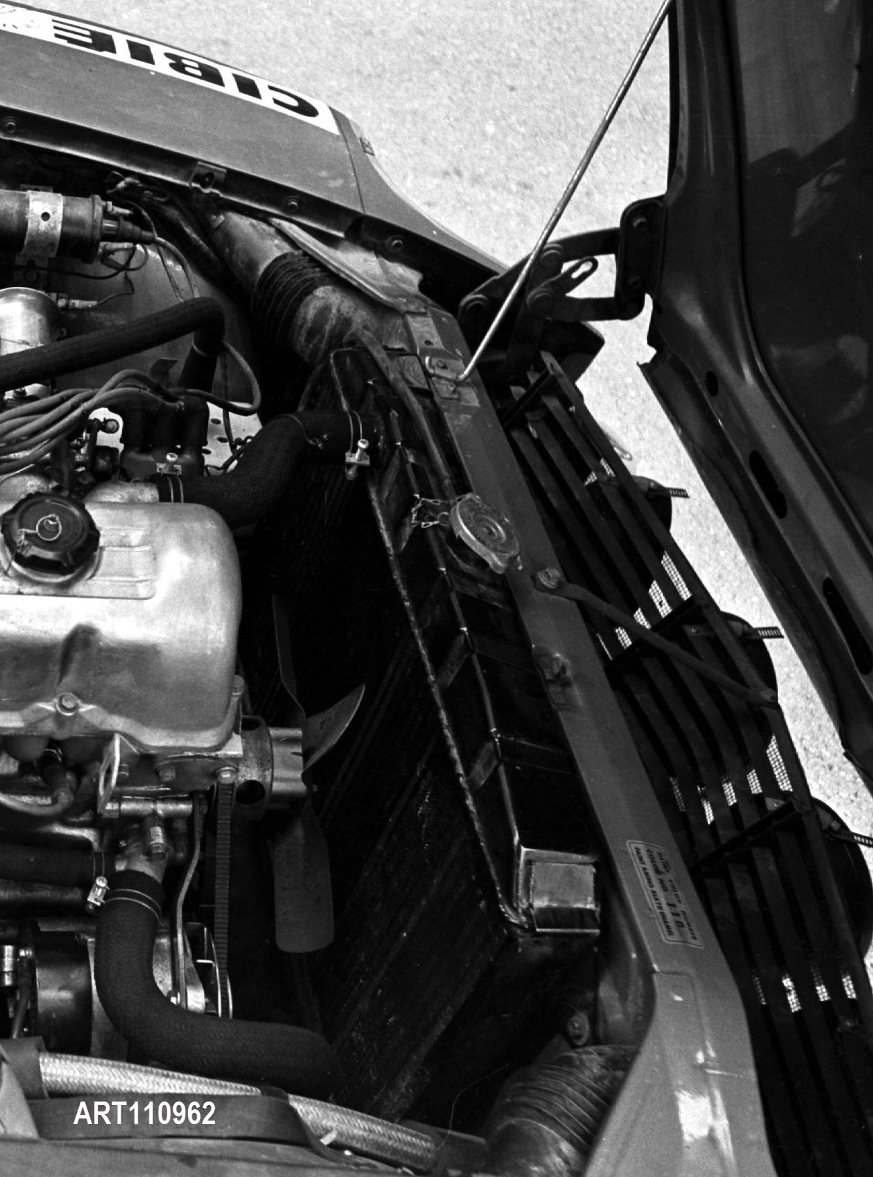

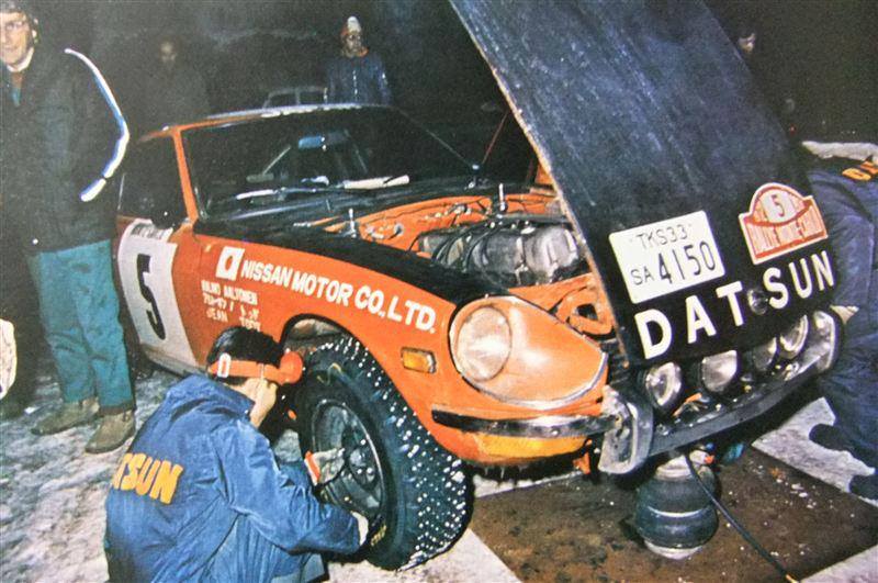

As part of the homologation process, the 'Drop Bumper' was in fact given a factory part number and made available to the general public. Part number was 62650-E8700.
In Works rally team use there was a fairly complex arrangement of braces and supports for the lamp units themselves; the lamp mounting brackets were braced to the front valance as well as the centre part of the bumper, and the whole affair was linked to the sump guard and the sump guard mounts. Little of that would be relevant to, or necessary on, a road car but care in bracing the lamps is quite important in order to avoid 'beam shake'/flicker, as well as stress fractures.
You'd struggle (to put it mildly) to find an original E8700 bumper in live captivity, but you could make your own version and this has been done quite successfully by others.
Photos save a thousand words:

Yes again. The design allowed the bonnet to pivot open normally on stock hinges, with the front edge swinging over the lamp units. Again, easier to illustrate than to describe:

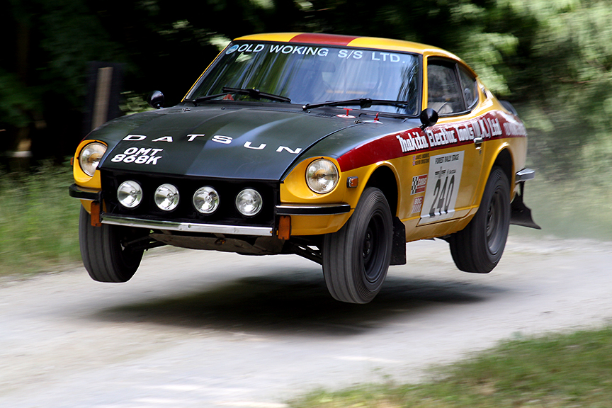

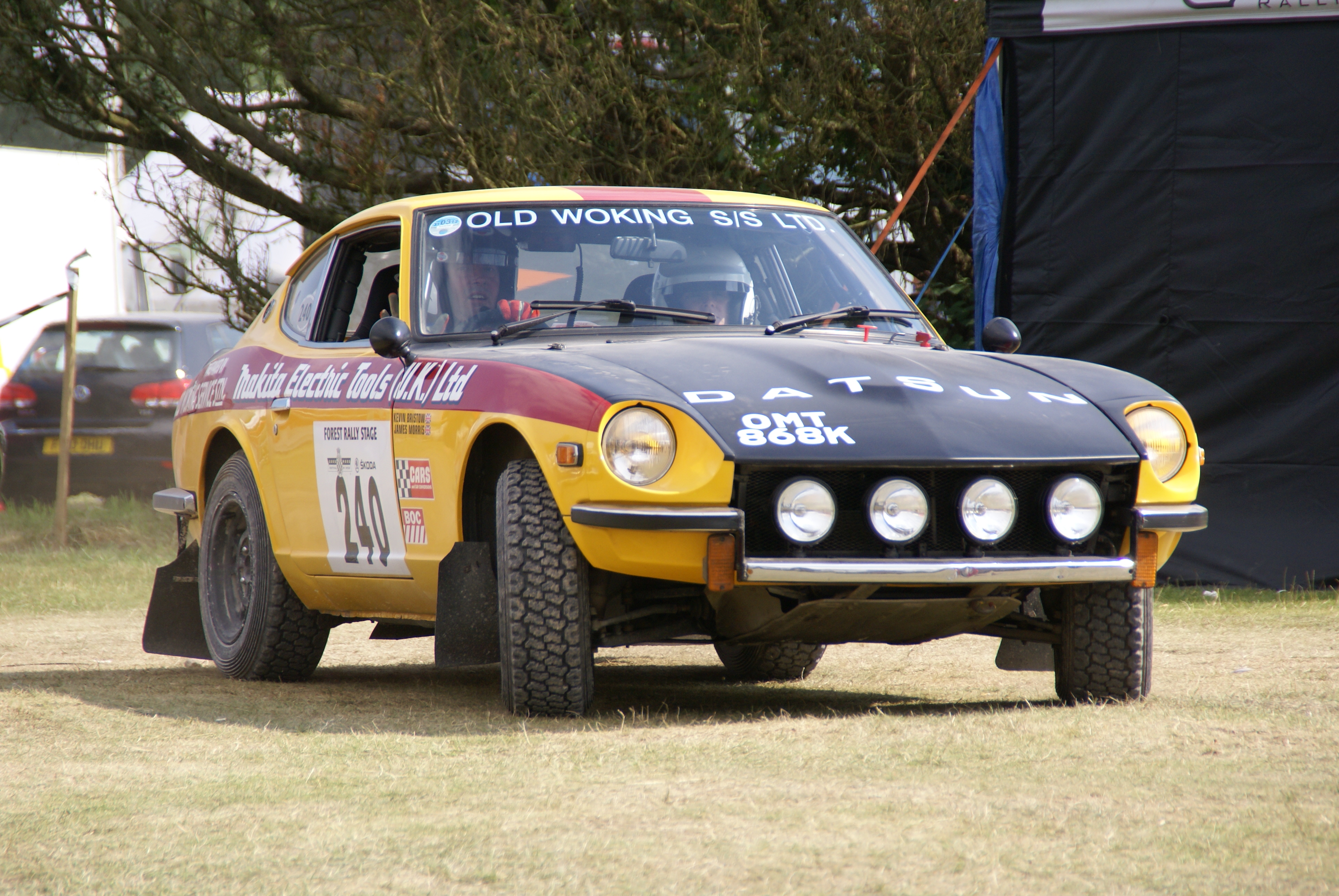

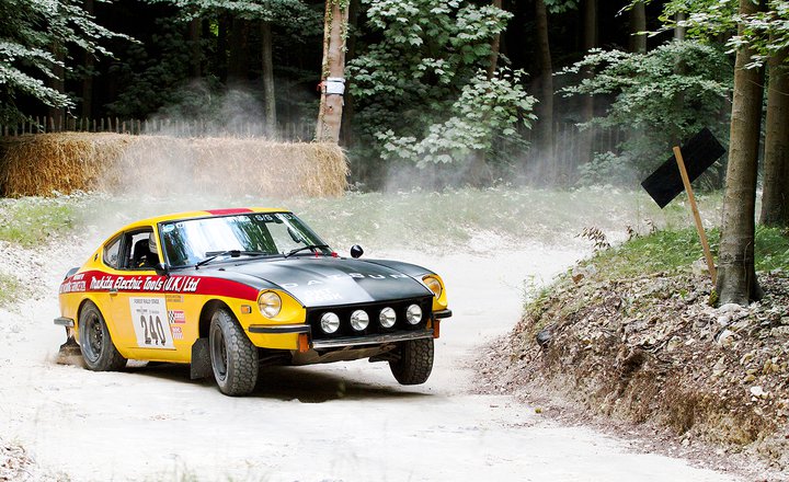

Here's an example of the simplest - non-Works - solution, on my good friend Kevin Bristow's historic 'OMT 868K' car at the Goodwood Festival of Speed Forest Rally Stage back in 2011.
The bumper is cut into three and the centre section 'dropped' via the addition of vertical brackets. Fairly easy to do, and this style was used by privateers in period so there's an historic link which satisfies certain regulations when necessary:

  • Popular Post
57 minutes ago, Patcon said:
Love the airborne pic!
Here's a great shot - by pro photographer Dan Redrup - at the same event. Kevin is a past British Historic Rally Championship winner in this car:
