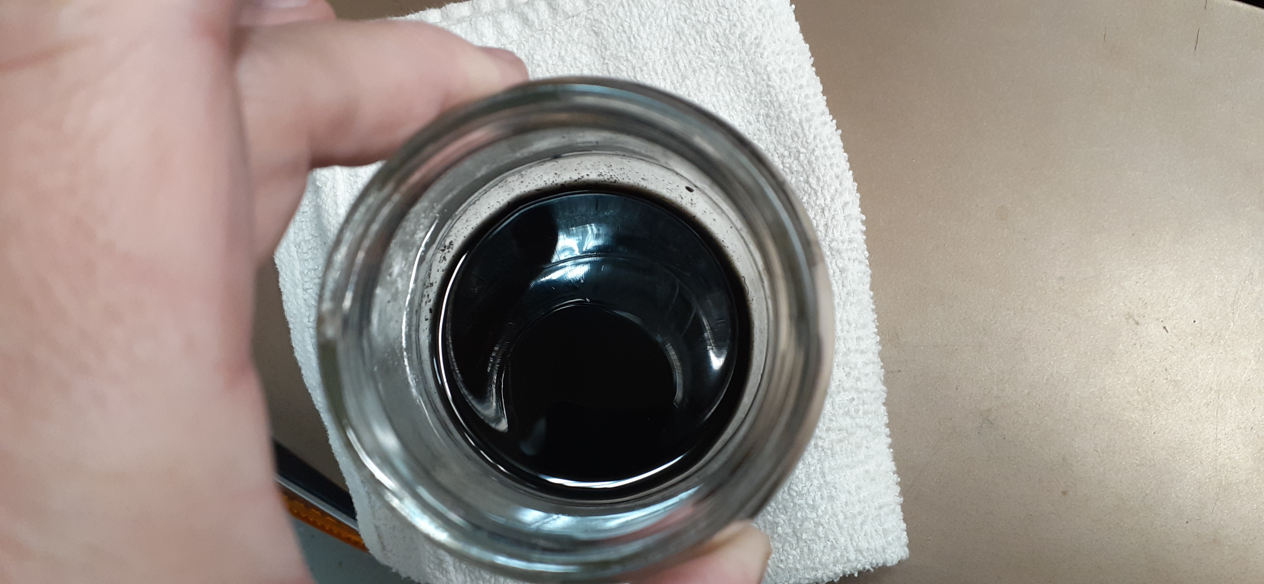

I received the master and slave cylinders today, so I decided that would be on this evening's agenda. I used my master cylinder fluid removal tool, known colloquially as a turkey baster, to remove the remaining fluid from the clutch master. The fluid was approaching vantablack in coloration, though it was still reflecting some light.

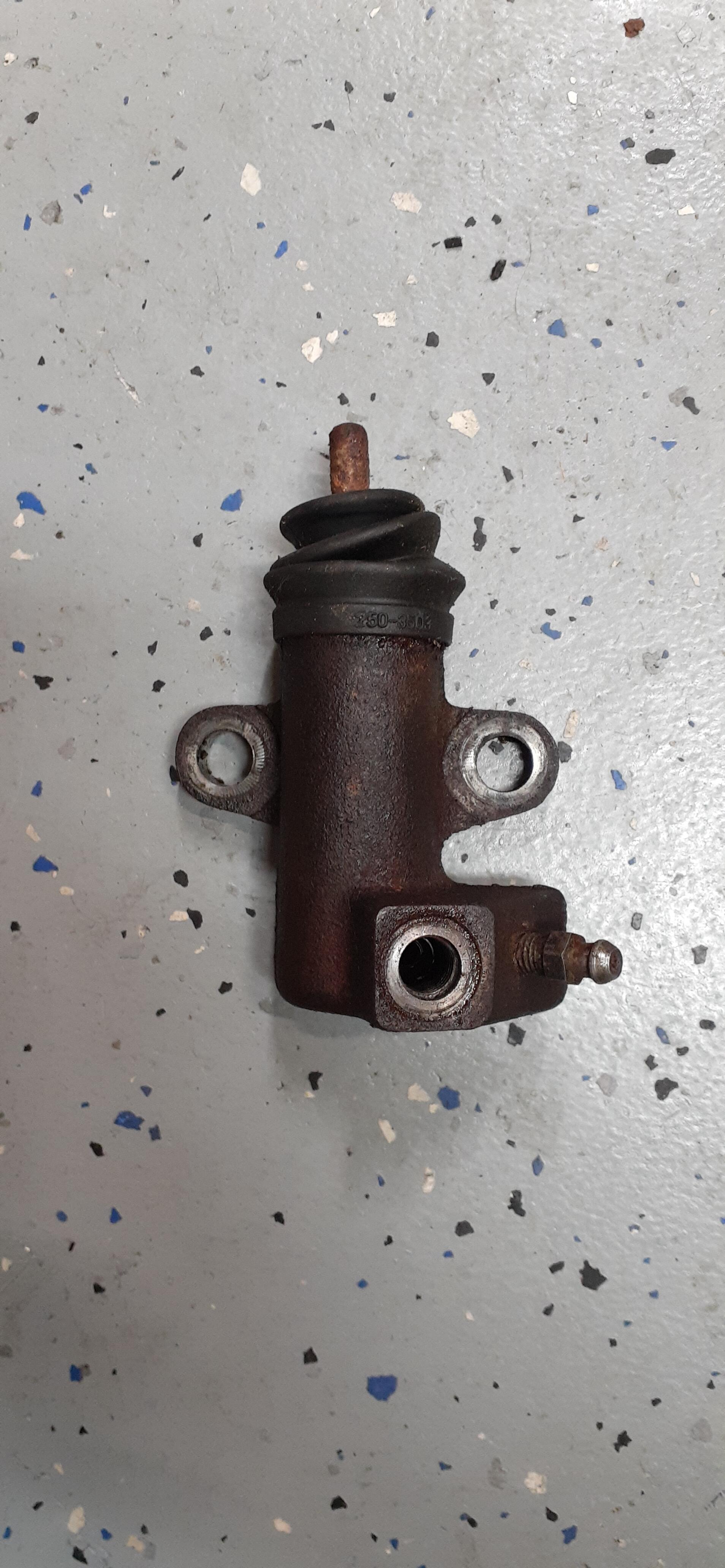

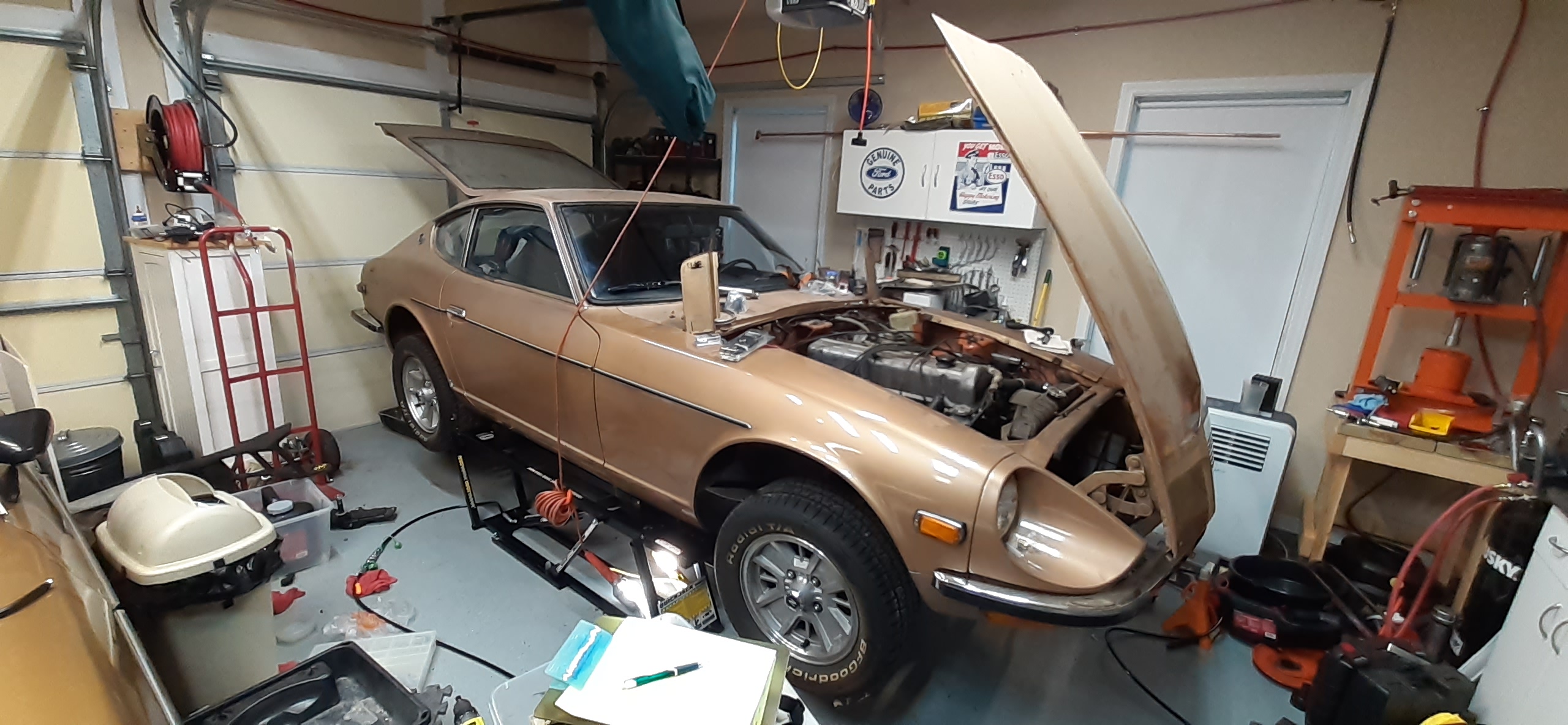

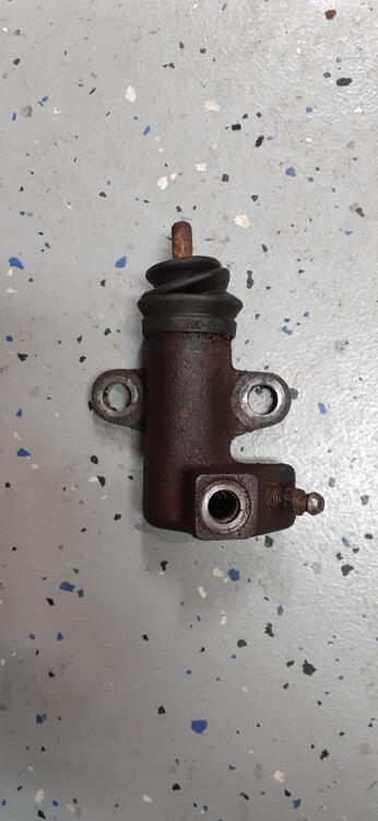

I then decided to move to replace the slave cylinder. I put the car up in the air with the Quickjacks. I can't say enough good things about them. I slid under the car to evaluate the task at hand. I grabbed my wrenches and bleeder bottle and set about trying to pull any fluid through that I could coax out. Of course, none came out because no one was depressing the clutch pedal. Okay, so then I broke the connection loose at the soft hose. For this, the 17 mm banjo wrench I grabbed could not get a good grip on the nut on the hose. Fortunately, I managed to use a conventional open-ended wrench without rounding off anything. The bolts holding the slave to the transmission did not put up a fight, and soon I was able to remove the old, grungy slave cylinder. It was on there for 27 years, but I did not drive the car very often since 2002, and none at all since 2010. However, brake fluid is not too kind over the years, especially when it is probably the same fluid that was put in 27 years ago.

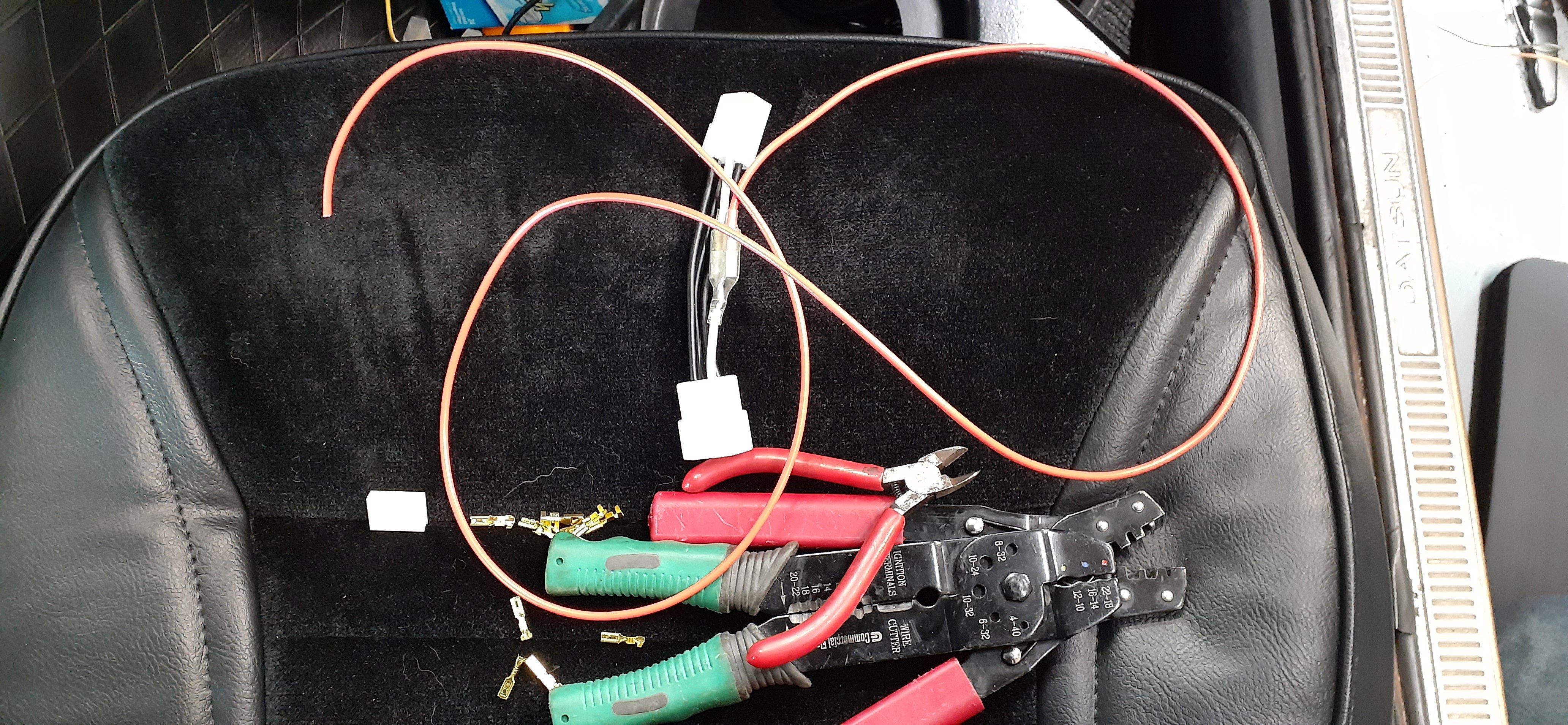

Early in the week I purchased a premium $20 Dual brand receiver from Walmart to install in the car. No CD, no tape deck, but it has USB, Aux, and Bluetooth. I wrestled out the old Audiovox tape deck and shook my head on how I wired it 28 years ago. The only good thing was that it was an excellent benchmark to show how far I have progressed over that timeframe with regard to my wiring skills. One of the challenges was finding a source for the constant 12VDC source. A long time ago, I jury-rigged getting the power from the map light. Yeah, that wasn't happening twice. Using the FSM wiring diagram and my multimeter I figured out my solution. The 12VDC switched source would be coming from the 3 wire connector for the radio. The ground would come from the 3 wire connector for the rear defrost switch. The 12VDC constant would come from the rear defrost relay. I made jumper harnesses for the ground and 12VDC constant.

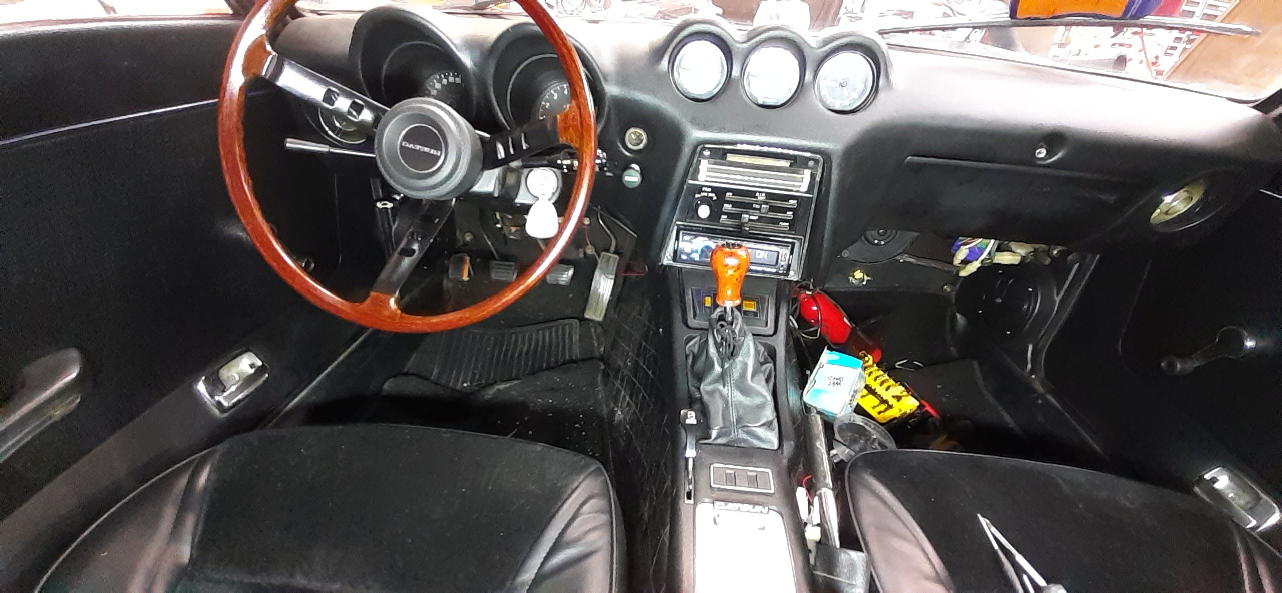

I connected everything and tested the stereo. It worked...except for the right front speaker. I tested the wiring, and found the positive wire was broken somewhere. I decided to start looking at how to install the speaker enclosures. Early on I discovered the old speakers were too deep. Fortunately I had to source speakers for the 260Z to fit the enclosures, so all I had to do was order another set of Pyle speakers from Amazon. Again, nothing but top shelf stereo equipment for me.
After the speakers arrived, I put the stereo end of the speaker wires into a connector. I also started fitting the enclosures. I had to trim the driver's side to clear the dead pedal. I also had to get some longer M6 bolts for the hood release bracket, but I plugged the wires into the speaker and got the enclosure mounted. Then I went to work on the passenger side. I decided to remove the fuel pump relays since they are not being used any more, and I removed the relay bracket. I did dry fit of the enclosure and trimmed it to go in more easily. After plugging in the speaker I went to install the relay bracket...Well, that took a lot longer than I hoped. It doesn't line up that great, especially with regard to the top bolt when you have the lower bolts cinched down. It doesn't help that you can't see how misaligned thing are unless you can miniaturize yourself and contort your body just right. Anyway, after an hour or so, I finally got the bracket mounted. I plugged in the stereo and tested. Yes, I have tunes for my next road trip.
