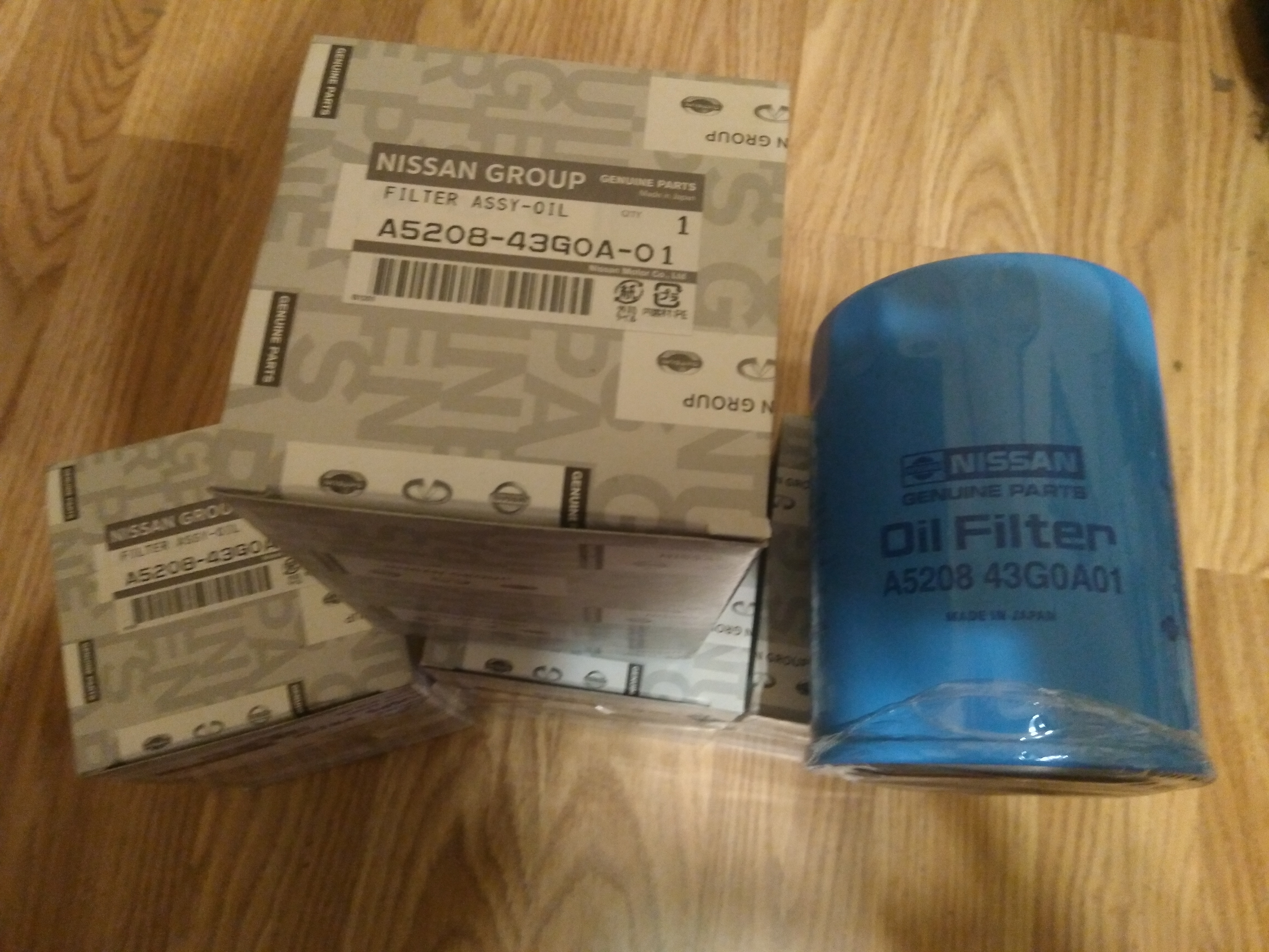

What filter are you running? I'll see if I can dig up details on the internals.
This is the filter I have always used and currently installed ...
I should have expected that. Unfortunately I couldn't find any details about the internals of the Nissan stock filter. Not surprising, but unfortunate. So I don't know if Nissan included a bypass valve inside their filters or not.
