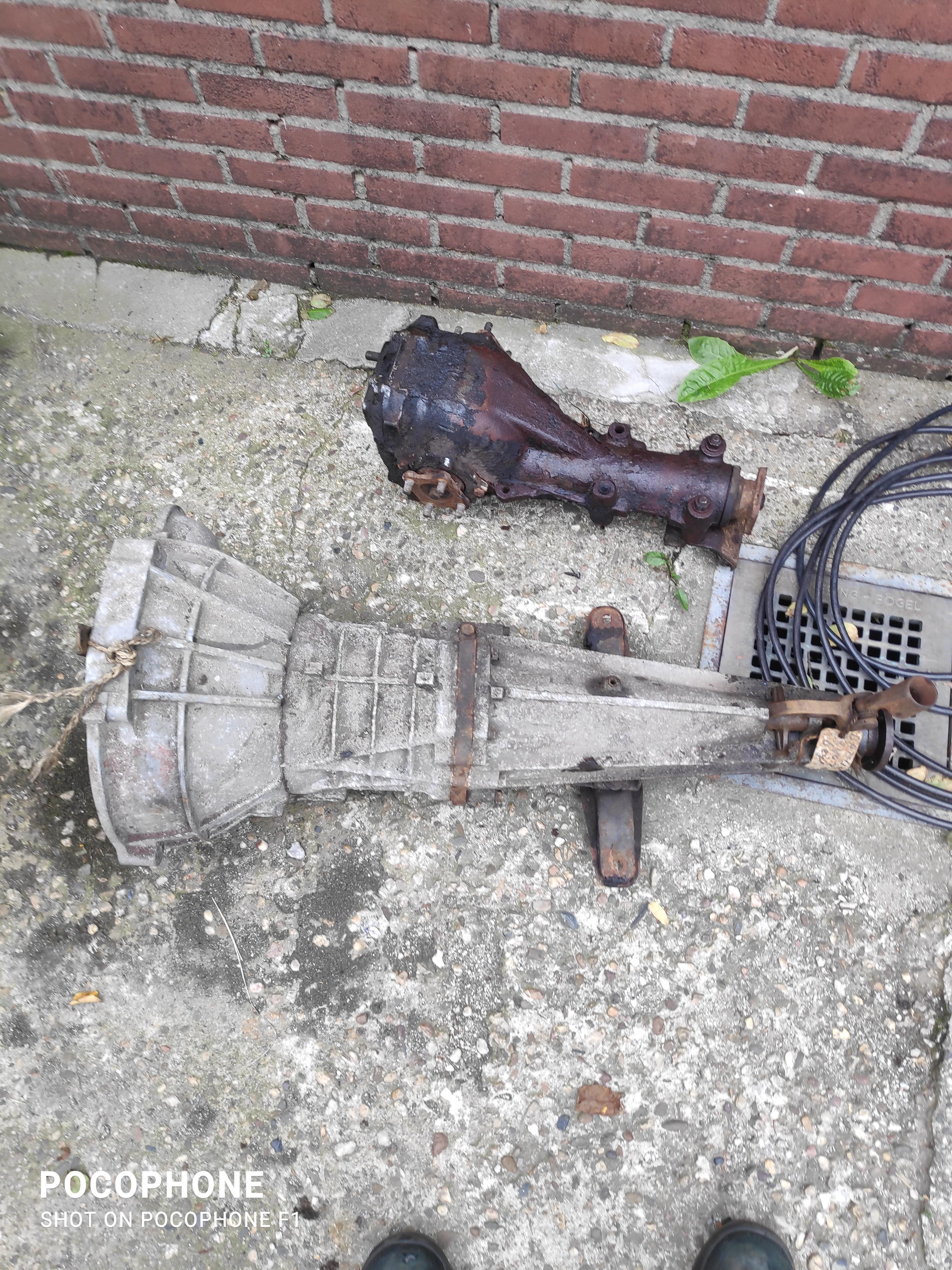

June 23, 20214 yr Author comment_623979 Picked it up today including the 3.90 r180 ( counted it and it's around 4-1 so it's either a 4.11 or 3.90 ? Hè Will search for the driveshaft couldnt find it so quickly. Link to comment https://www.classiczcars.com/forums/topic/65482-need-help-5-speed-identification/?&page=2#findComment-623979 Share on other sites More sharing options...
June 29, 20214 yr Author comment_624249 Seems it's the early a type, pretty rare find. and the diff also ! Hope he can find the driveshaft.. then I have a complete swap for my 240z Link to comment https://www.classiczcars.com/forums/topic/65482-need-help-5-speed-identification/?&page=2#findComment-624249 Share on other sites More sharing options...
