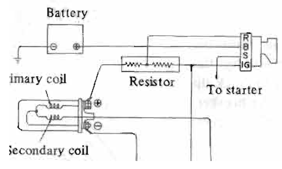

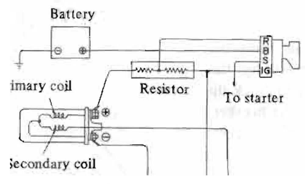

June 9, 20213 yr Author comment_623172 here is a video using the test light... why no power out of balast? https://photos.app.goo.gl/wTuyQYuAueTwDbvU9 coil.MOV Link to comment https://www.classiczcars.com/forums/topic/65481-74-260z-distributor-on-wrong/?&page=6#findComment-623172 Share on other sites More sharing options...

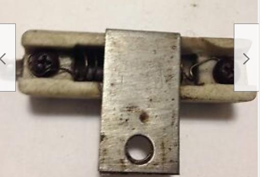

June 9, 20213 yr comment_623175 Disconnect the wires, remove the ballast resistor and turn it over. Looks like it might be damaged. The wire is probably broken. Link to comment https://www.classiczcars.com/forums/topic/65481-74-260z-distributor-on-wrong/?&page=6#findComment-623175 Share on other sites More sharing options...

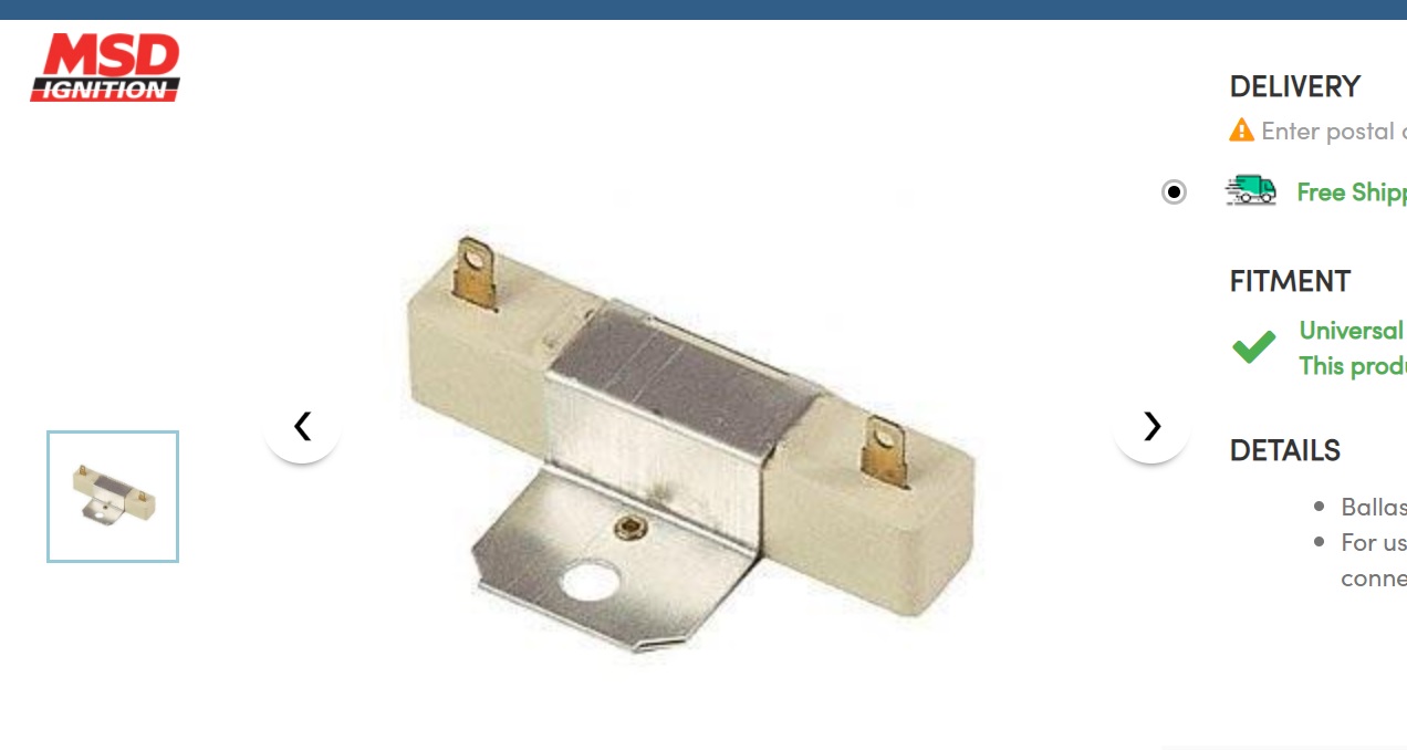

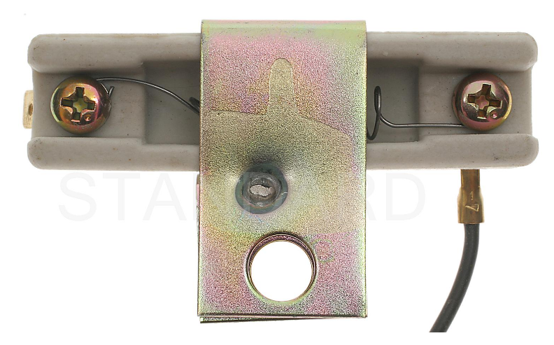

June 10, 20213 yr Author comment_623182 ok... that is something to check .. i never knew there was a wire under there - thought it was a solid block... i have this one.. will it work?? only two prongs on this one.. came with coil,,,, my balast resistor did get pretty toast when trying to start car.. Link to comment https://www.classiczcars.com/forums/topic/65481-74-260z-distributor-on-wrong/?&page=6#findComment-623182 Share on other sites More sharing options...
