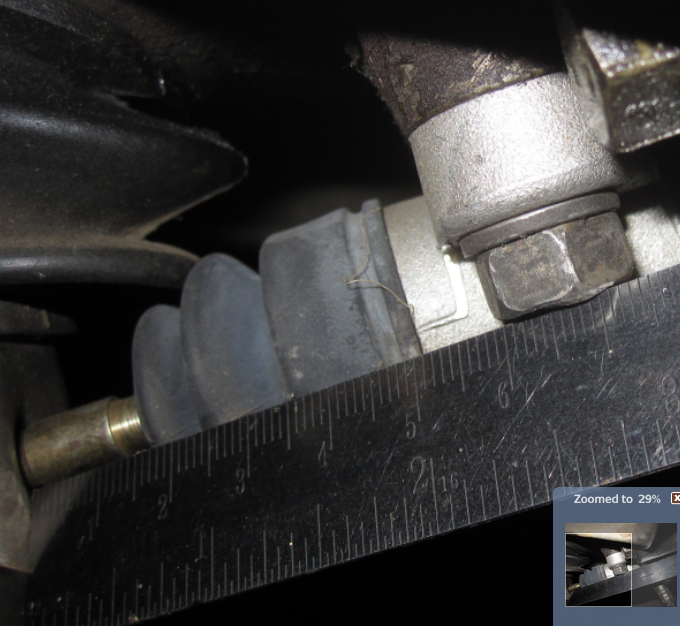

Looks like I got about 58 mm on my 76 with 5 speed and perfectly working clutch.
To clarify - this is the measurement from the bolt head to the fork, at rest.  Just to give an idea of how tall or short the TOB sleeve is
