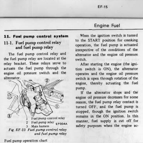

Only if you remove the oil pump switch plug on 1978 280Z.  It's a flaw.  A 280Z fuel pump will only run with the key at Run if the operator intentionally changes something or there is an error in the system.  It is well described in each individual 280Z Factory Service Manual in the Engine Fuel chapters.
Except for the flaw in the 1978 fuel pump control system, which is described on one of the AtlanticZ.CA pages.

9 minutes ago, chaseincats said:
My car and my friends' 78 work like that and our oil pump switches are plugged in 🤷‍♂️
Two non-rights do not make a non-wrong.
1 hour ago, chaseincats said:
When I primed the pump by turning the key to "on", the gauge read 10psi.  I cleared the gauge and primed the pump with the key again, this time it read 5psi.  I cranked the car, and after a bit, the gauge hit 36 psi
Explain the above in terms of the below.  Obviously your pump is not working the way you think it is.  Good luck..
The pump (when I last used a gauge between the filter and rail a few years back) read 36 when the pump was primed and during operation.  Today, it reads 10 during priming and 36 during operation which seems to be the issue.
Whatever was malfunctioning back then fixed itself, possibly.  Switches do stick.  Even a bad connection could cause it.
Why not assume that the system works as Nissan intended it to and take the appropriate actions?
Edited by Zed Head
So I went down just now with a fuel pressure gauge and unplugged the oil pressure switch connector and the pump indeed did come on.  Does that mean my fuel pressure control relay was stuck open all these years?
