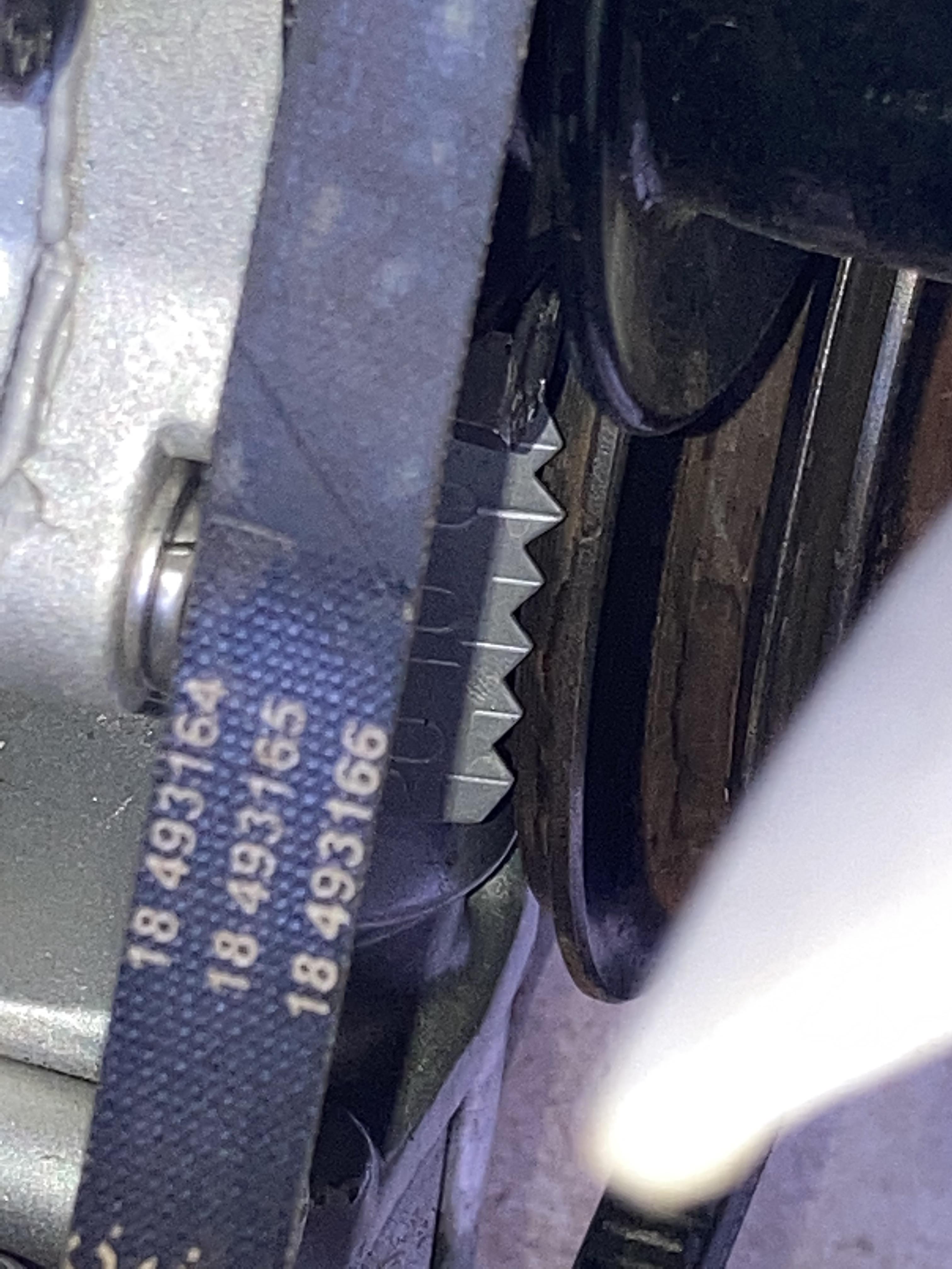

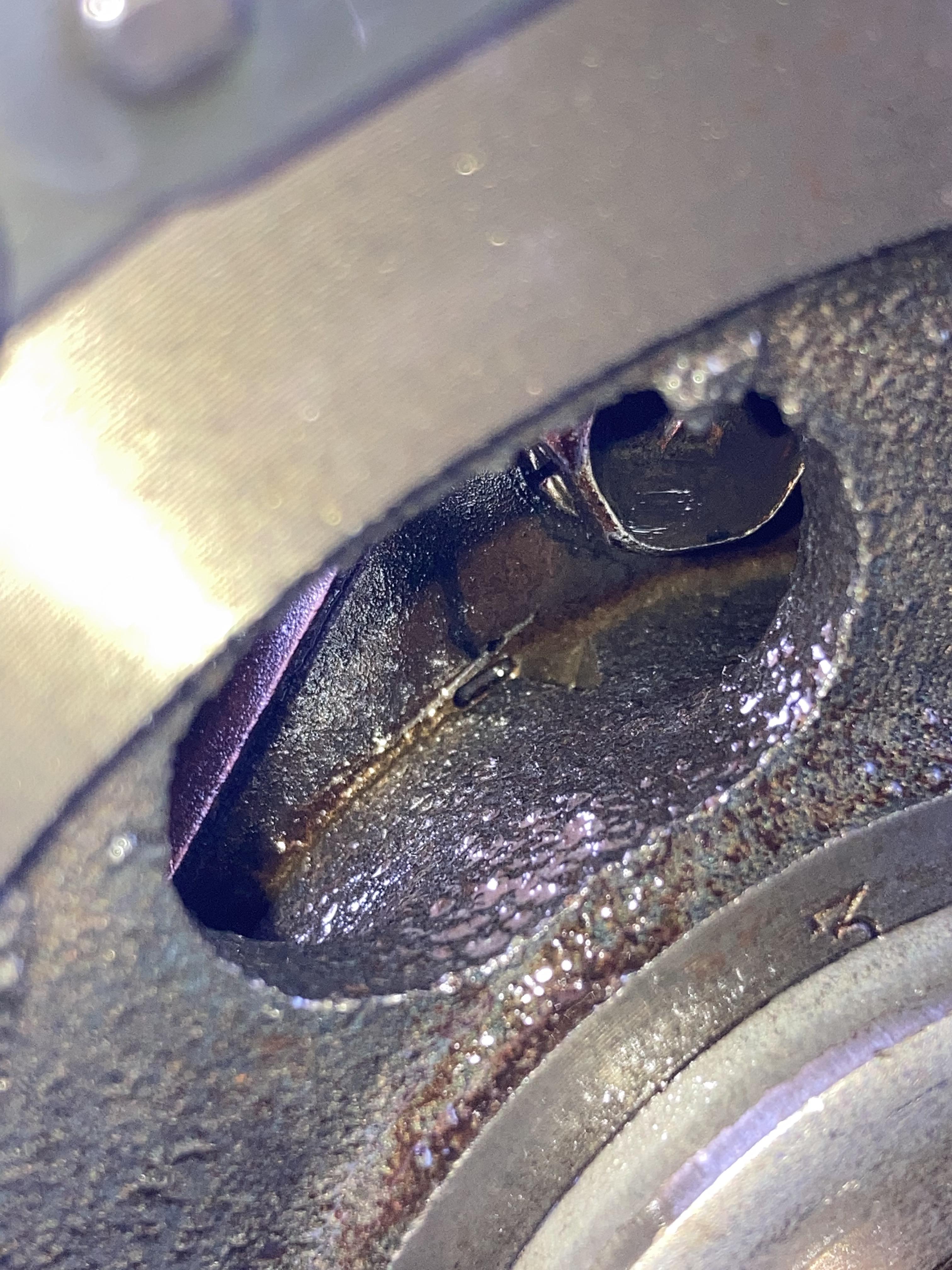

May 18, 20214 yr Author comment_621804 Just did a valve adjustment. A lot of them had way to loose of clearance. Only one I didn't need to touch. Weird cause I already did the adjustment once. I would say it was a warm adjustment. I also agree it sounds cammy, but I don't know why. Everything seems stock under the valve cover, but I don't know how to tell if it is an aftermarket cam. In addition, sometimes it smoothes out like when cold, so it makes me think it is just missing or stumbling. I rotated the engine clockwise carefully until I got to TDC. I have it on mark 3, so obviously the chain has wear. However, it looks like at this position the cam is advanced still. Is that ok? This is where the crank pulley lines up and how the cam timing marks look correlated to it.  Edited May 18, 20214 yr by ckurtz2 Link to comment https://www.classiczcars.com/forums/topic/65230-1977-280z-efi-nightmare/?&page=9#findComment-621804 Share on other sites More sharing options...
May 19, 20214 yr comment_621805 I'm not entirely sure if yours is within acceptable parameters, but this is how i understand it is supposed to look. This is taken when reassembling my motor, which seems to be running just fine. Most people say turning the engine over with the cam bolt is bad, and it is better to use the crank bolt, or a remote starter. I have used the cam bolt in the past, without causing any apparent damage, but since have started using a remote starter. Link to comment https://www.classiczcars.com/forums/topic/65230-1977-280z-efi-nightmare/?&page=9#findComment-621805 Share on other sites More sharing options...

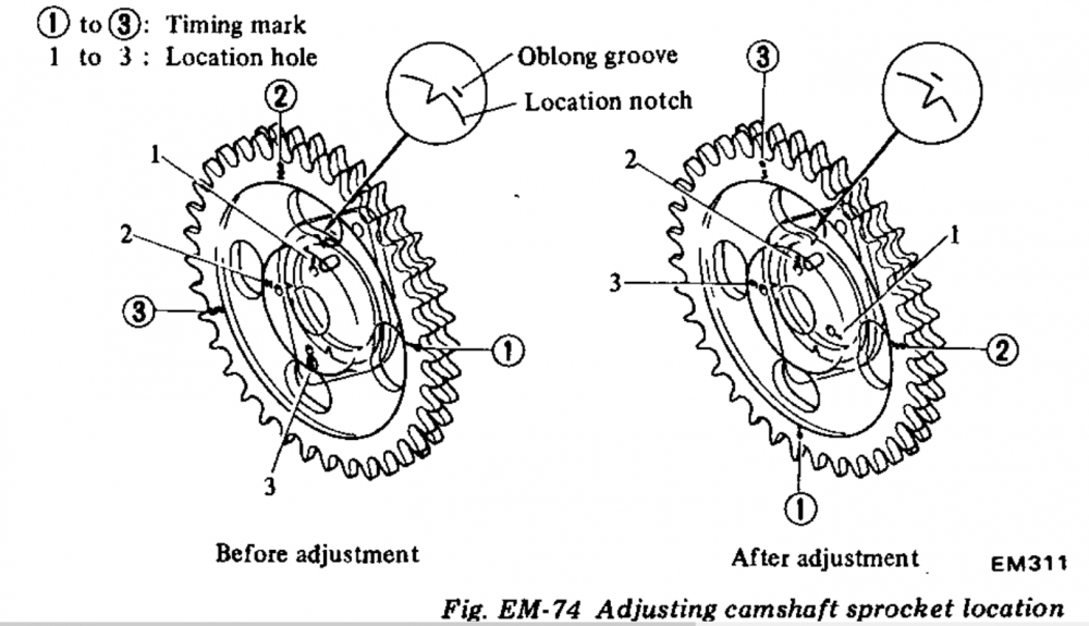

May 19, 20214 yr comment_621809 1 hour ago, ckurtz2 said: A lot of them had way to loose of clearance. How did the cam lobes look? Did you check the wipe pattern after installing the camshaft? You said "reinstalled and so on", but.... Your cam is in the "after adjustment" spot, which is good. It does indicate that your chain is worn but cam timing should be right.  Link to comment https://www.classiczcars.com/forums/topic/65230-1977-280z-efi-nightmare/?&page=9#findComment-621809 Share on other sites More sharing options...

May 19, 20214 yr Author comment_621816 @Reptoid Overlords thanks for the confirmation photo! My chain is definitely stretched, but the #3 cam pulley position compensated. Mine may be running a tad more advanced then yours, but it looks to be in spec as well. I wish my cam sprocket looked as clean as yours! 😎 Link to comment https://www.classiczcars.com/forums/topic/65230-1977-280z-efi-nightmare/?&page=9#findComment-621816 Share on other sites More sharing options...
