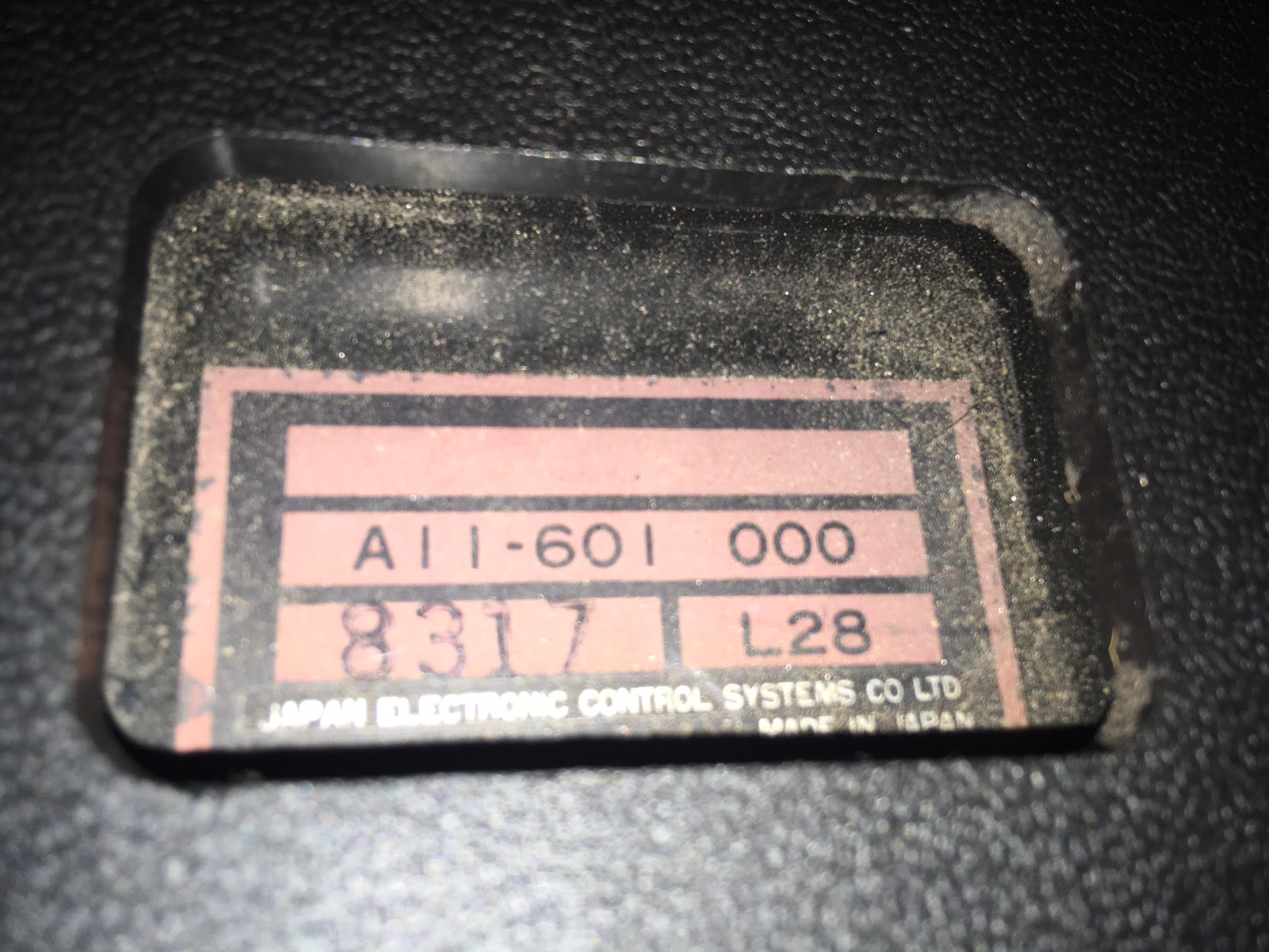

I just went to check and this is my ECU's version label like we were talking about: unnamed.jpg
I'll see what I have for ECUs here. I don't know if I can tell anything from the label, but I'll look.

I removed/opened my ecu for my new problem here: https://www.classiczcars.com/forums/topic/65578-sudden-engine-shutoff/?tab=comments#comment-624753.  But since we were discussing what my ECU looked like, here it is too lol
Edited by chaseincats
OK, so that's an original 78 ECU and there's no software in it. In other words... I don't think there's anything inside that can that would cause a lean-boot that would last the length of the drive and then be reset by a reboot. Still sounds like a software issue to me.
