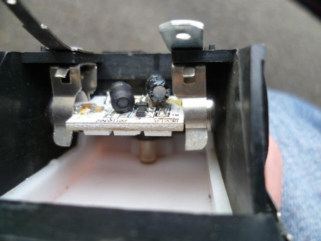

Yeah, it was a little bit of work to get the larger 6-LED bulb in there, but I really like the way it turned out. Great brightness, and warm white, so no blueish harsh stuff going on. If you didn't know better, you would assume it's an incandescent.
As for the old dead photobucket sucks pics... I think I can post them here.

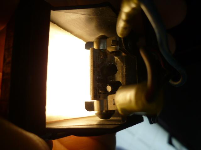

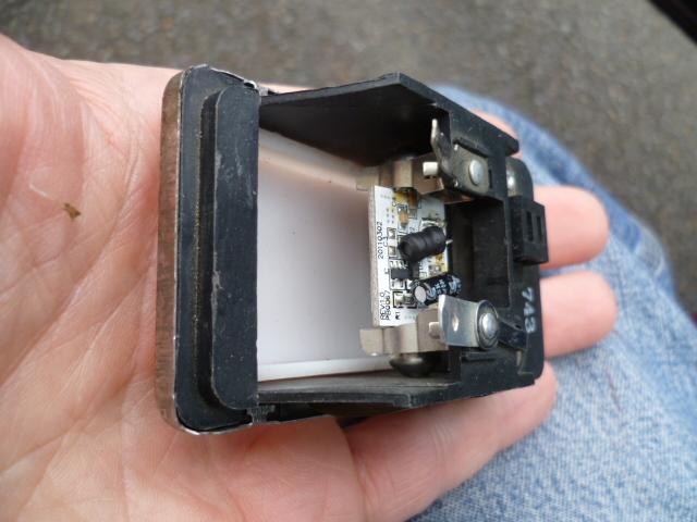

Here's some pics showing what I had to do to the mounting clips to get the bulb to fit. I used a carbide burr on a dremel. Don't get tiny brass slivers stuck in your fingers (or eyes):
And even though you can't tell much because there's nothing else to compare it to, here's the obligatory "ON" pic:
And again, if you don't want to deal with grinding off a little of the brass fingers to fit the 6 LED festoon in there, you can get a 4 emitter version instead. And since they keep making LEDs brighter and brighter, I wouldn't be surprised to learn that todays 4 LED bulbs are as bright as the 6 LED bulbs from 7 years ago when I did this mod.

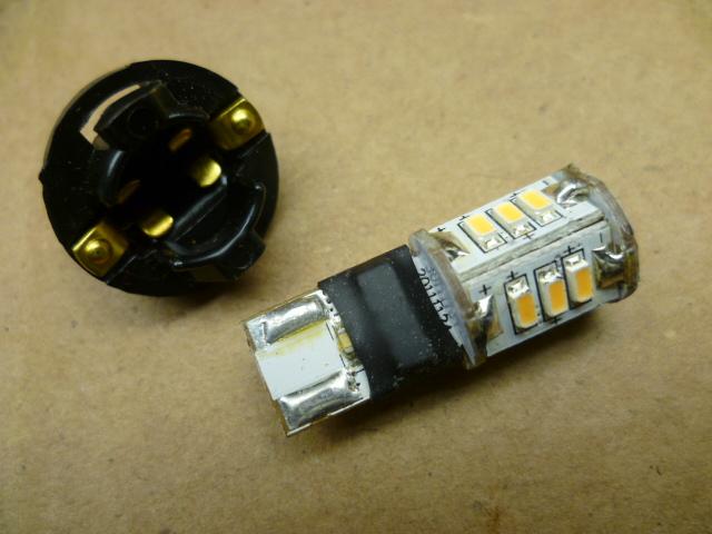

I did the map light as well. I think I posted some details about that somewhere... But if I did, the pics are probably dead on that too.
Here's what I used and I think it's fantastic!

I dug out my order info for the map light. I got that map light from superbright as well.
The part I ordered (five years ago) was WLED-WWHP15-TAC
But it appears they have changed the numbers and that part is now listed as 921-WWHP15-TAC
https://www.superbrightleds.com/moreinfo/miniature-and-subminiature-bulbs/921-led-landscape-light-bulb-15-smd-led-tower-miniature-wedge-retrofit-100-lumens/2508/
There are different tabs for the different "colors" I like warm white (because I'm old).

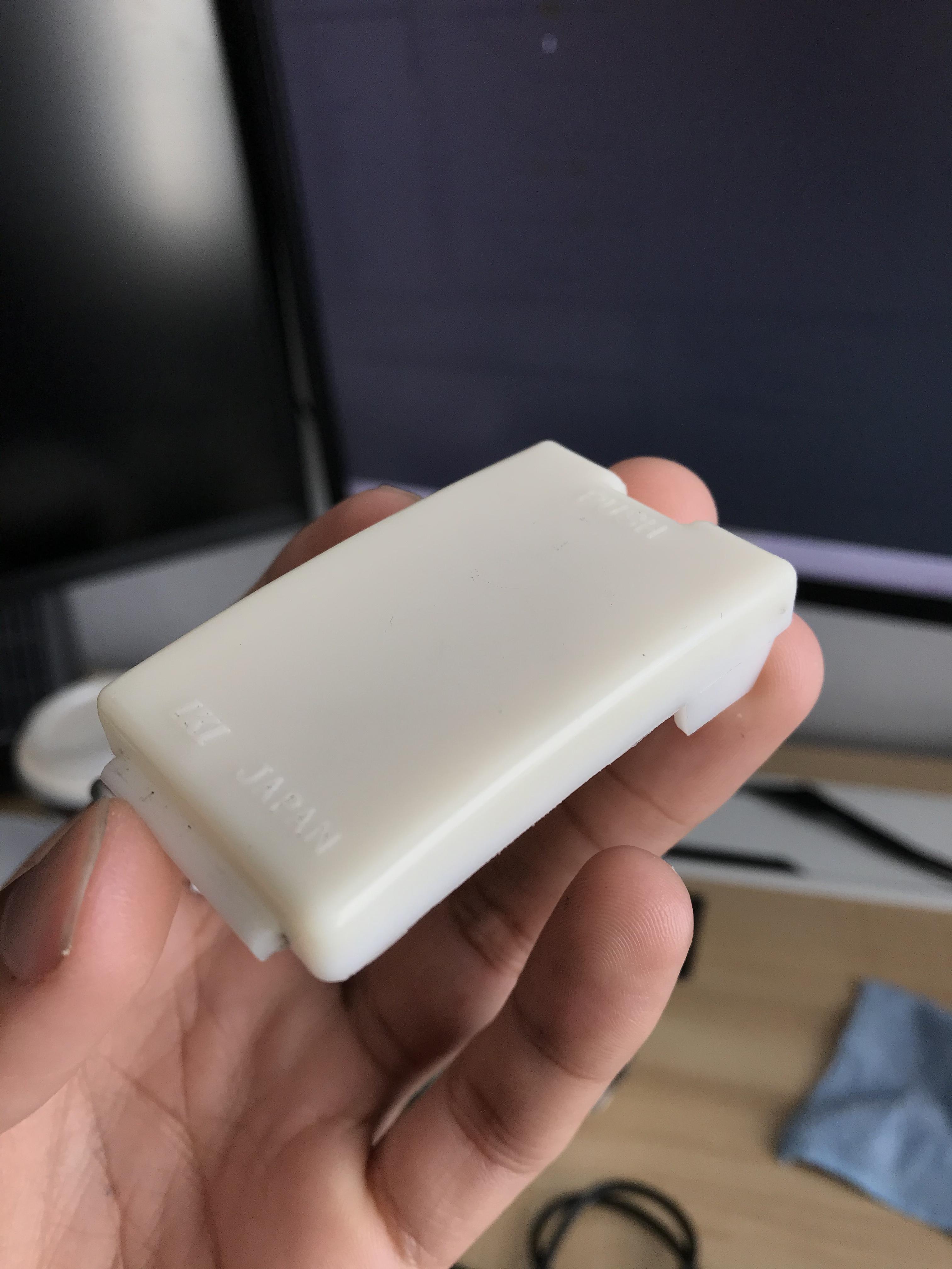

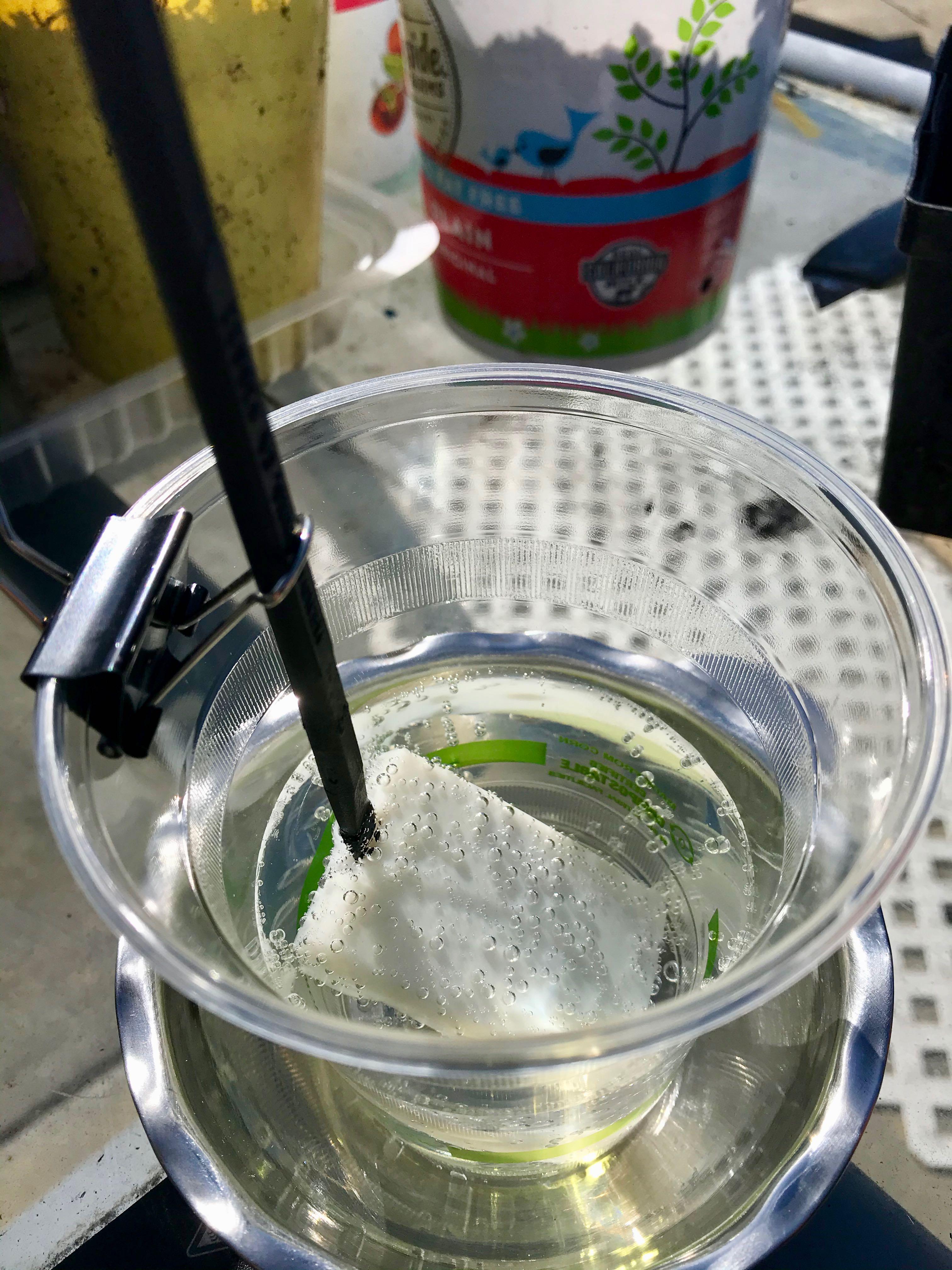

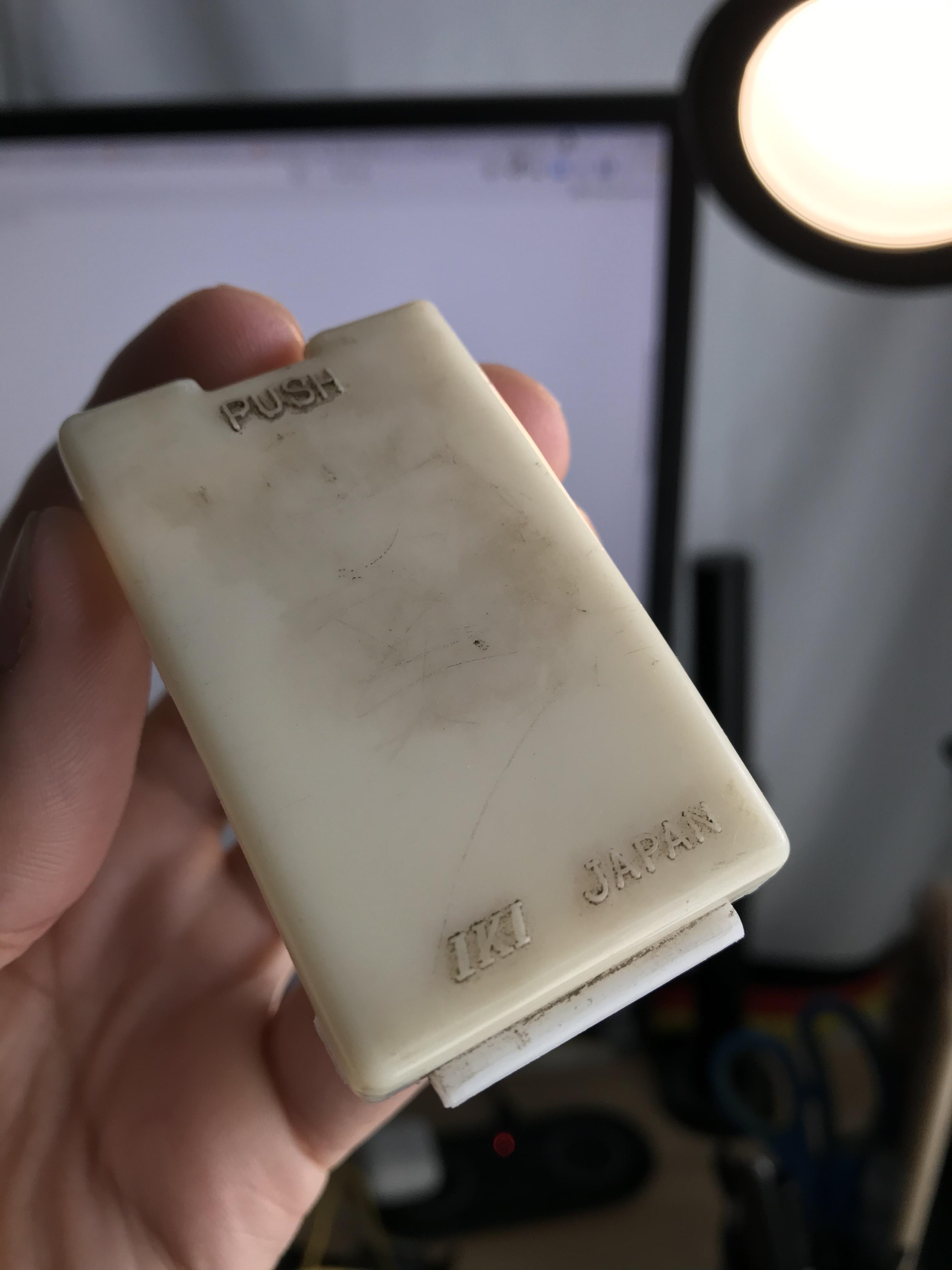

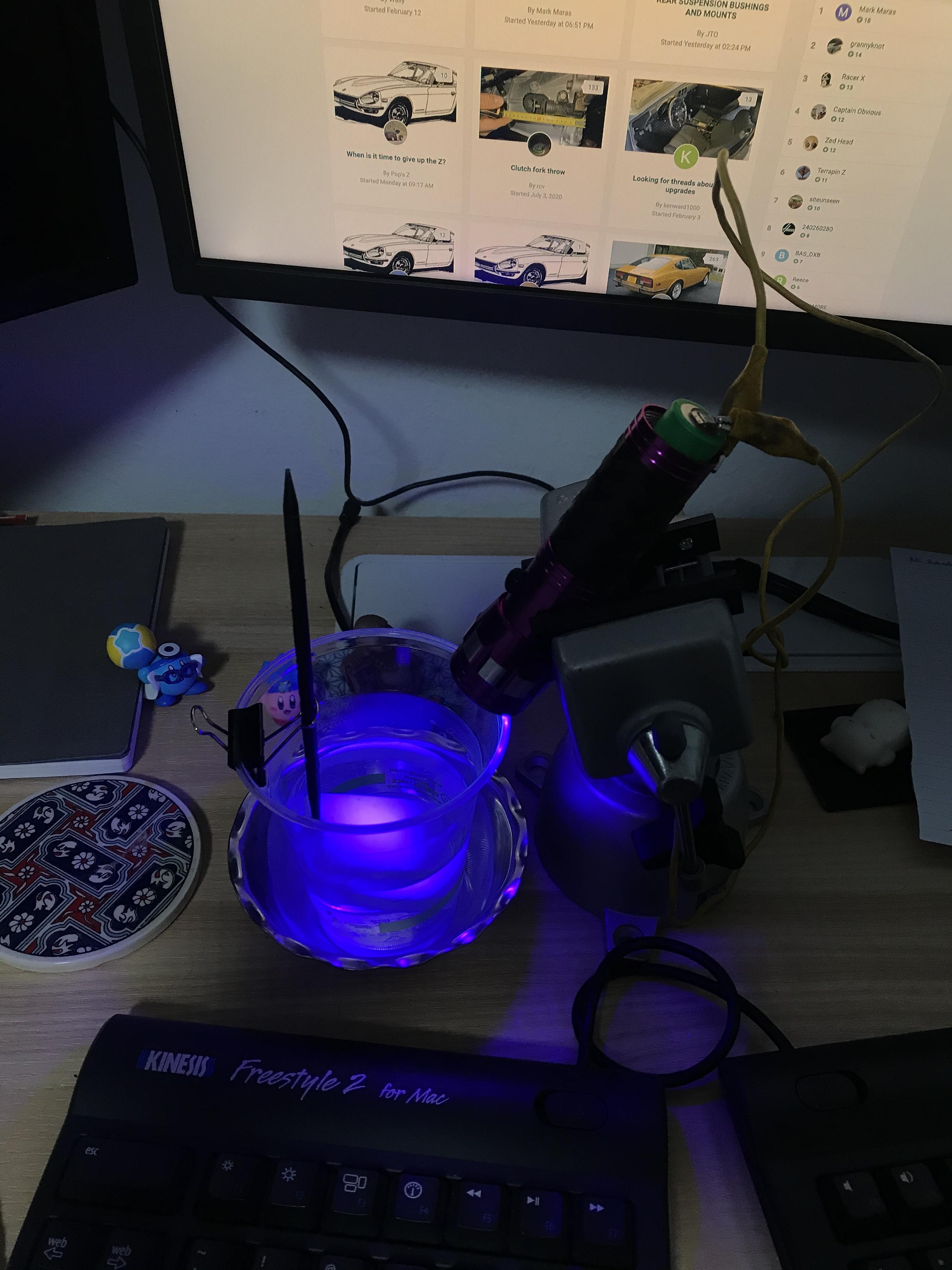

Trying to de-yellow the plastic, I cleaned it off with some purple power and a toothbrush to remove the grime. The solution is hydrogen peroxide, and the UV light is one that I used to locate AC leaks. I threw on a rechargeable lithium battery so I can leave it on for several hours. Shall see in the morning. Hopefully it’s still there.

So far it looks pretty good, I let it sit all day in the sun to use the free UV radiation.
Put it back outside for the rest of the day, I’m pretty happy with the results.
Edited by heyitsrama
Yeah, that looks good. I would probably stop there.
So this peroxide and UV combination thing... Is this internets science? Most times UV makes plastic worse, not better. Not arguing with the results, but wondering if the UV was really adding any value?

To be honest @Captain Obvious i have no idea how it works, some people say its the UV that is catalyzing the peroxide.
https://www.quora.com/What-is-happening-in-terms-of-a-chemical-process-when-hydrogen-peroxide-is-used-to-restore-discoloured-Lego
Others say its the bromine in the plastic that is being broken out of the plastic. https://hackaday.com/2017/11/03/yellowing-the-plastic-equivalent-of-a-sunburn/
I would agree that UV light is damaging for prolonged exposure (paints, truckers arms, etc.) in fact the reason why I only have one white lens is that the other one disintegrated from exposure to the elements, my car was in the California sun for ~15 years before I started working on it, the paints messed up on the drivers side from the exposure.
Last night i turned off the flashlight because i did not want to over-discharge the lithium cell by leaving it on the whole night. I noticed that in the morning the plastic was a bit de-yellowed, but not like it was out in the sun. I also noticed that after leaving it in the sun, there would be loads of bubbles around the lens while it was in the peroxide.
I think the UV might just be expediting the process, it looks like UV-A light can be used as a catalyst for to breakdown H2O4 -> 2[H20] + O2, and the O2 is what provides the cleaning power for us.http://newfrontchem.iqstorm.ro/upload/10-NFC-23-2_Cataldo.pdf
I'm not sure how/why oxygen cleans so effectively.
So internets science for the win! Whatever the underlying process, that lens looks good. Just hope there isn't any unwanted long-term effects.
