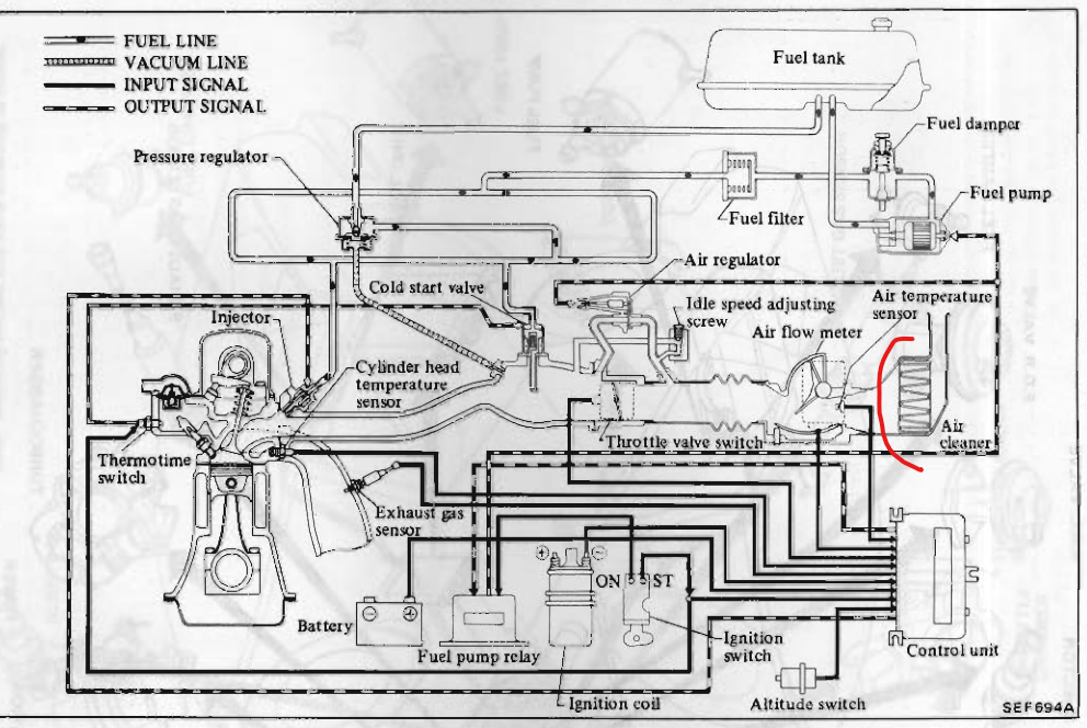

Fuel would be coming out of the AFM according to your description.  It's the next thing after the air filter.
Yes indeed fuel comes out of the AFM. When i see the picture you just posted i think the CSV is open all the time. Also i dont think a injector can spray so much fuel in that it will come out of the AFM
