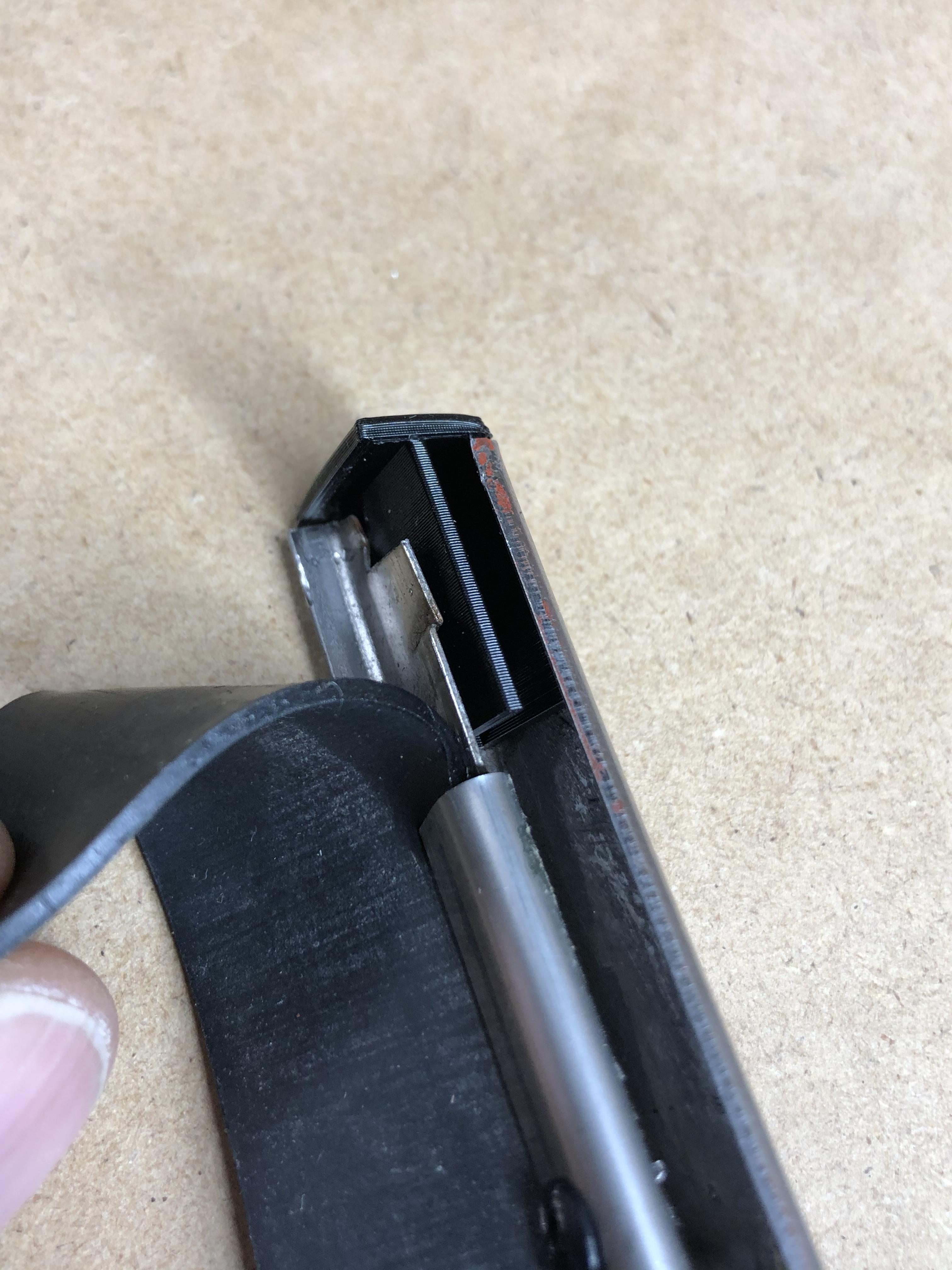

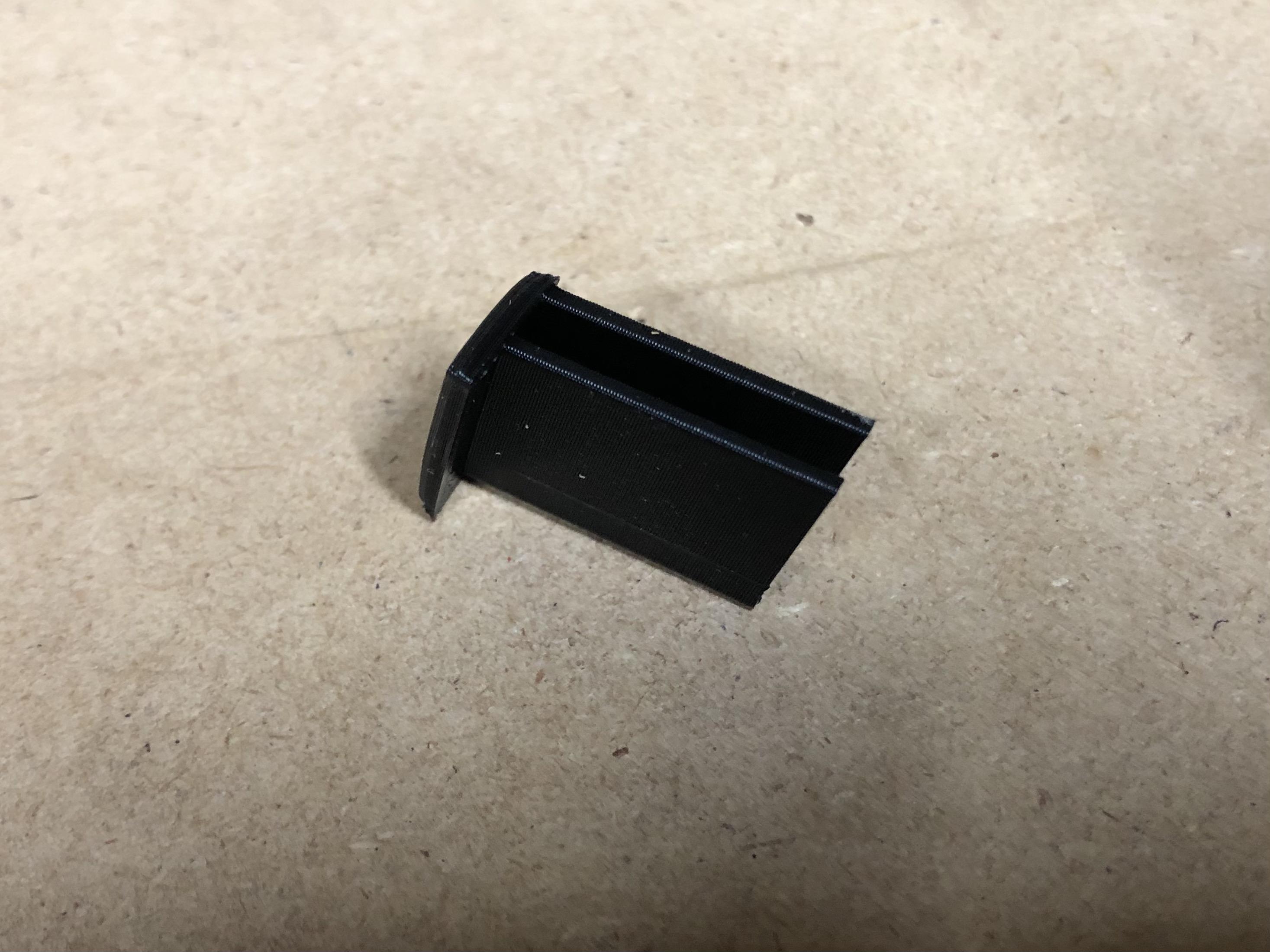

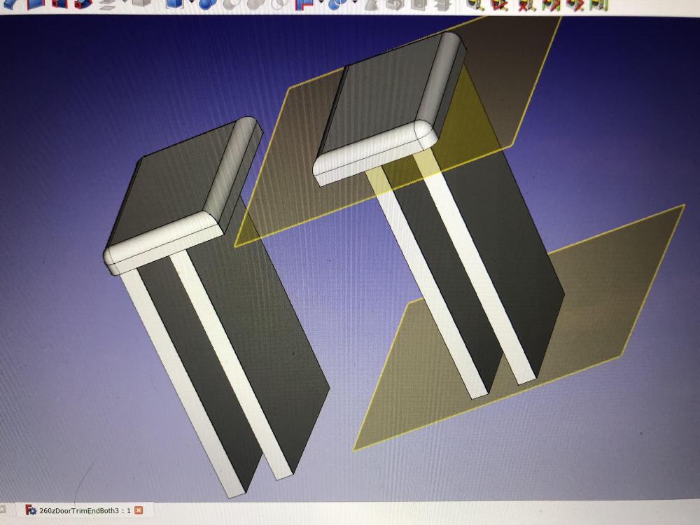

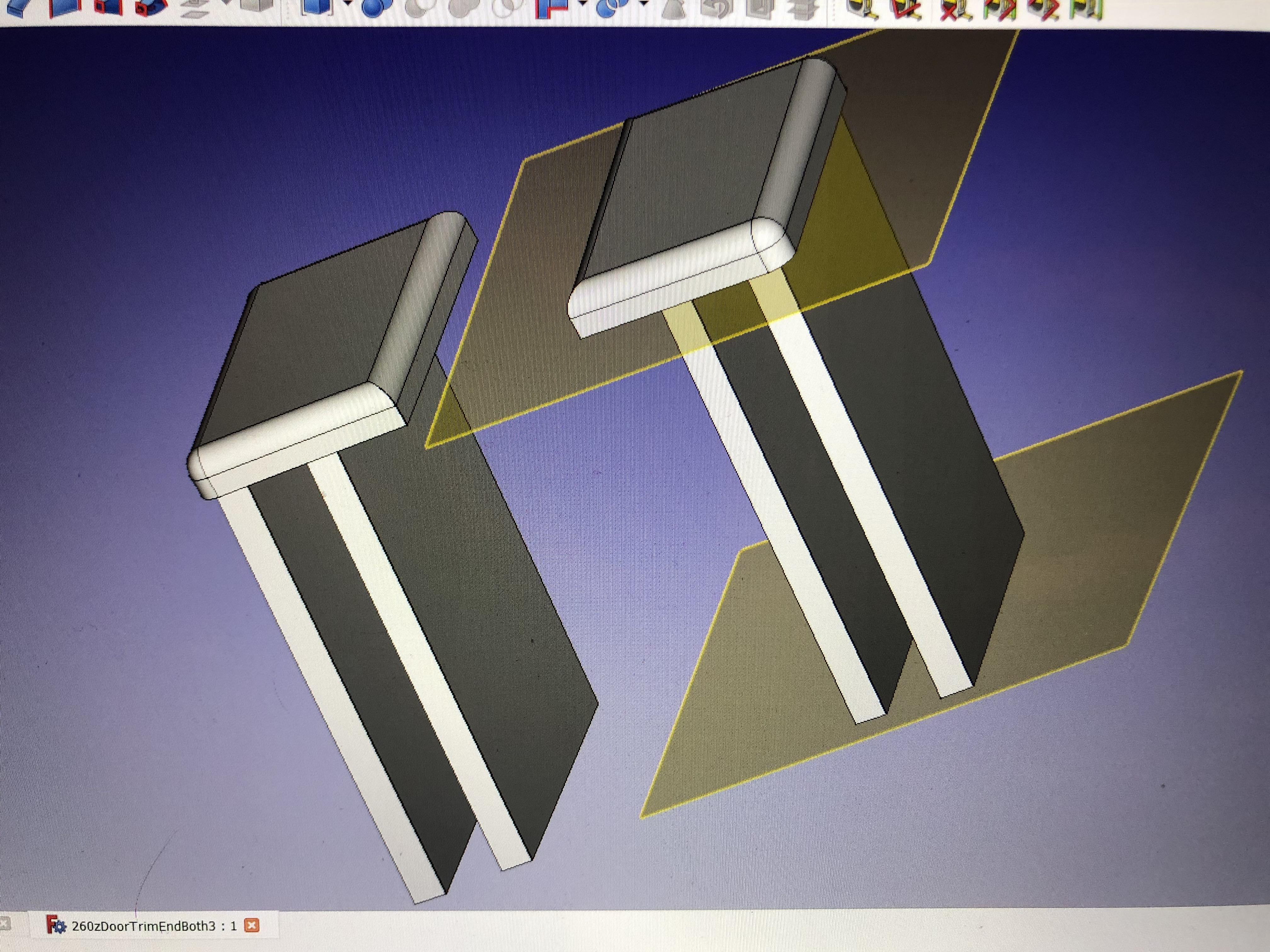

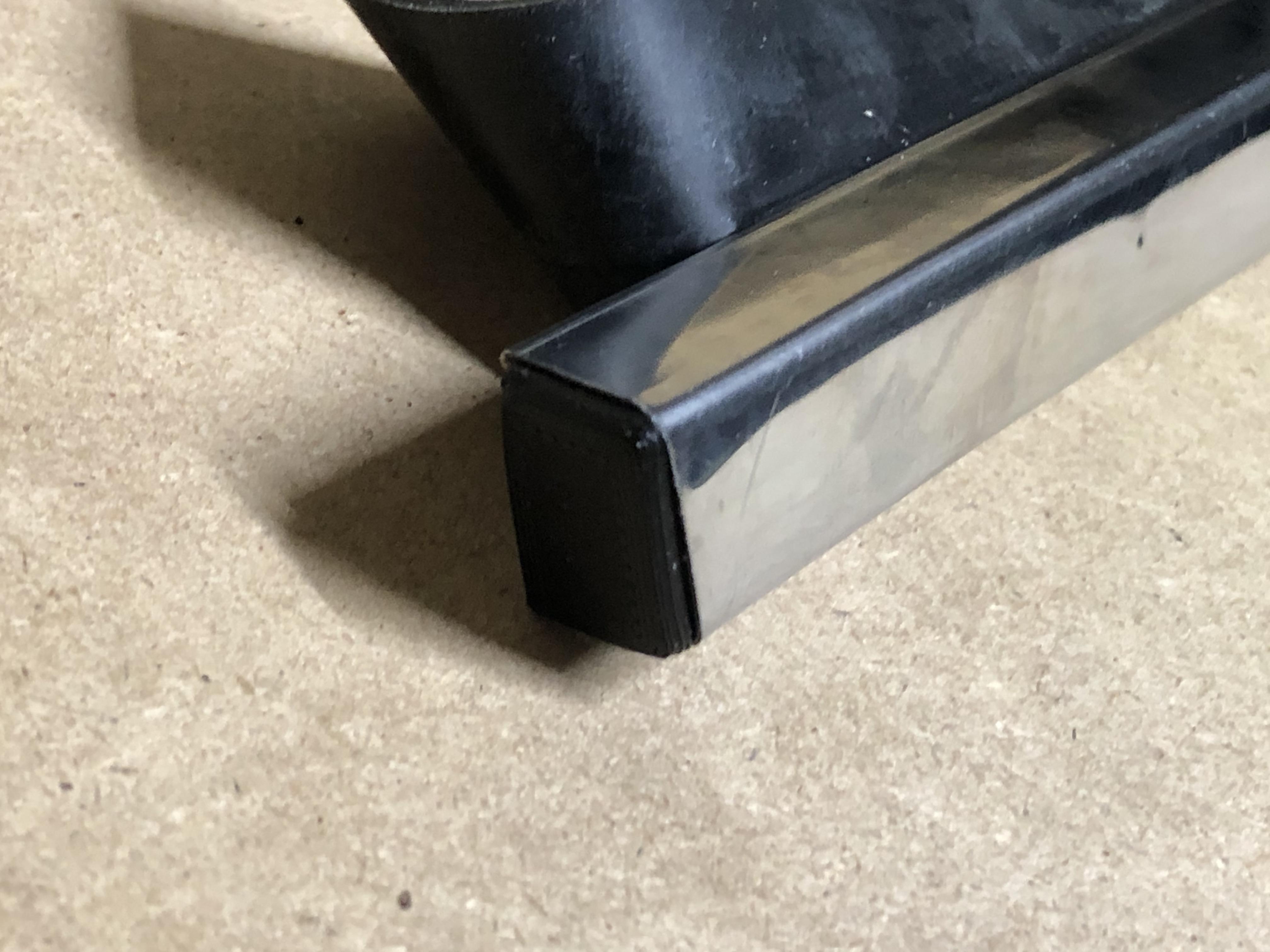

My kids picked up a 3D printer over the holidays, so I thought I try to figure it out and learn how to use it.  I just happened to be replacing the rubber wipes on the door window trim, and noticed there were no end caps.  Not sure if this is how the car came, or just went missing over the years.  I downloaded FreeCAD and started to play around with it.  After a lot of youtube videos, I was able to design and print some caps.  Haven't installed them on the car yet to confirm the overall fitment, so hopefully no issues.
I used PLA filament for the sample pieces (it's the only one I have at the moment).  If these work out, I will pick up some ABS filament and reprint them.

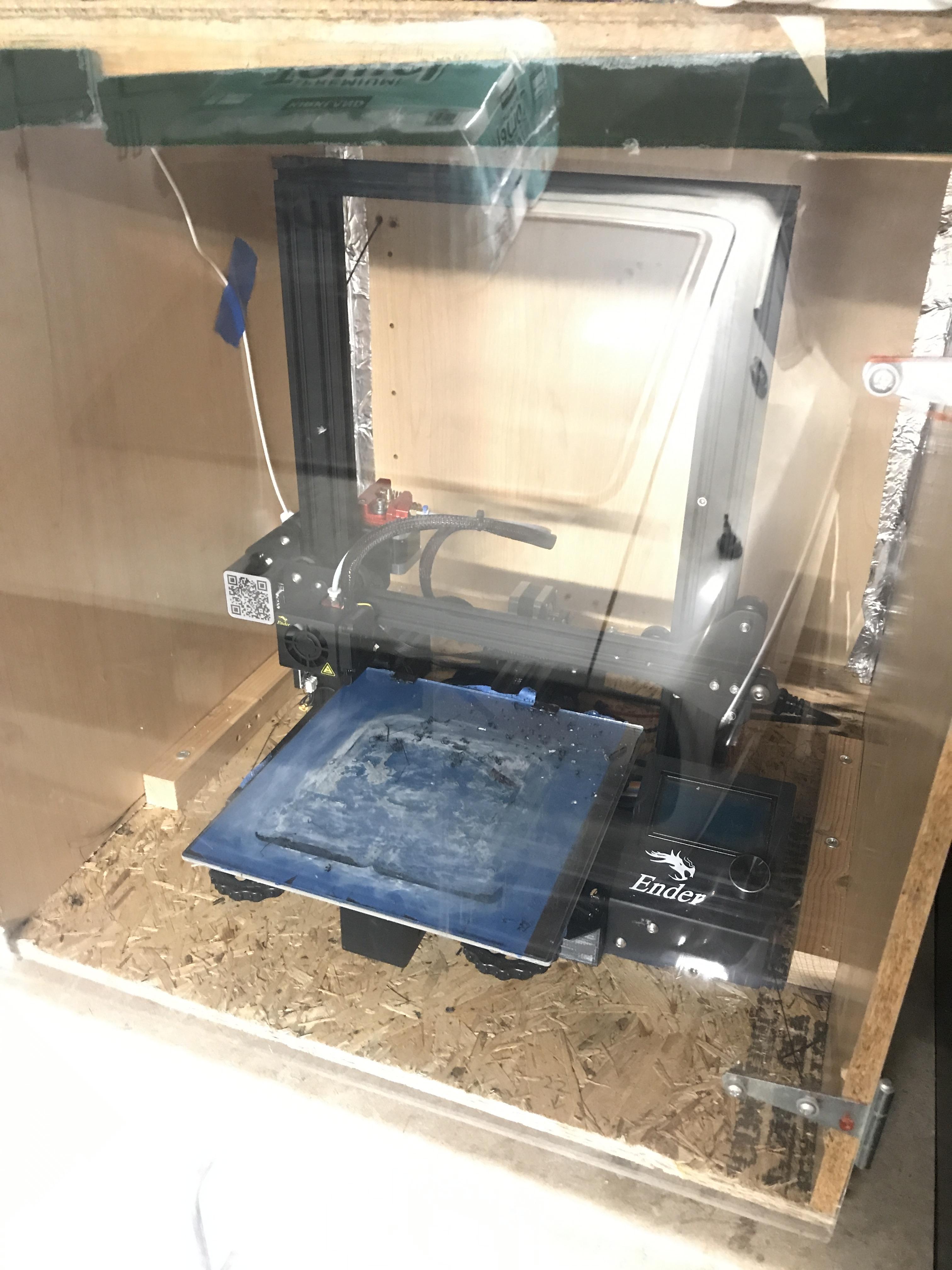

if you end up printing ABS your going to need to get an enclosure for it, ABS does not like temperature fluctuations.
I build mine out of some wood and put a plexiglass door on it, it’s been pretty effective. I upgraded the feeding mechanism on it too, it was worth the money the prints look way better.

Perfect, thanks for tips.  Will look into this for sure as I do plan on printing with ABS.
I'll send you the STL file via PM.
260zDoorTrimEndRH3.stl 260zDoorTrimEndLH3.stl
