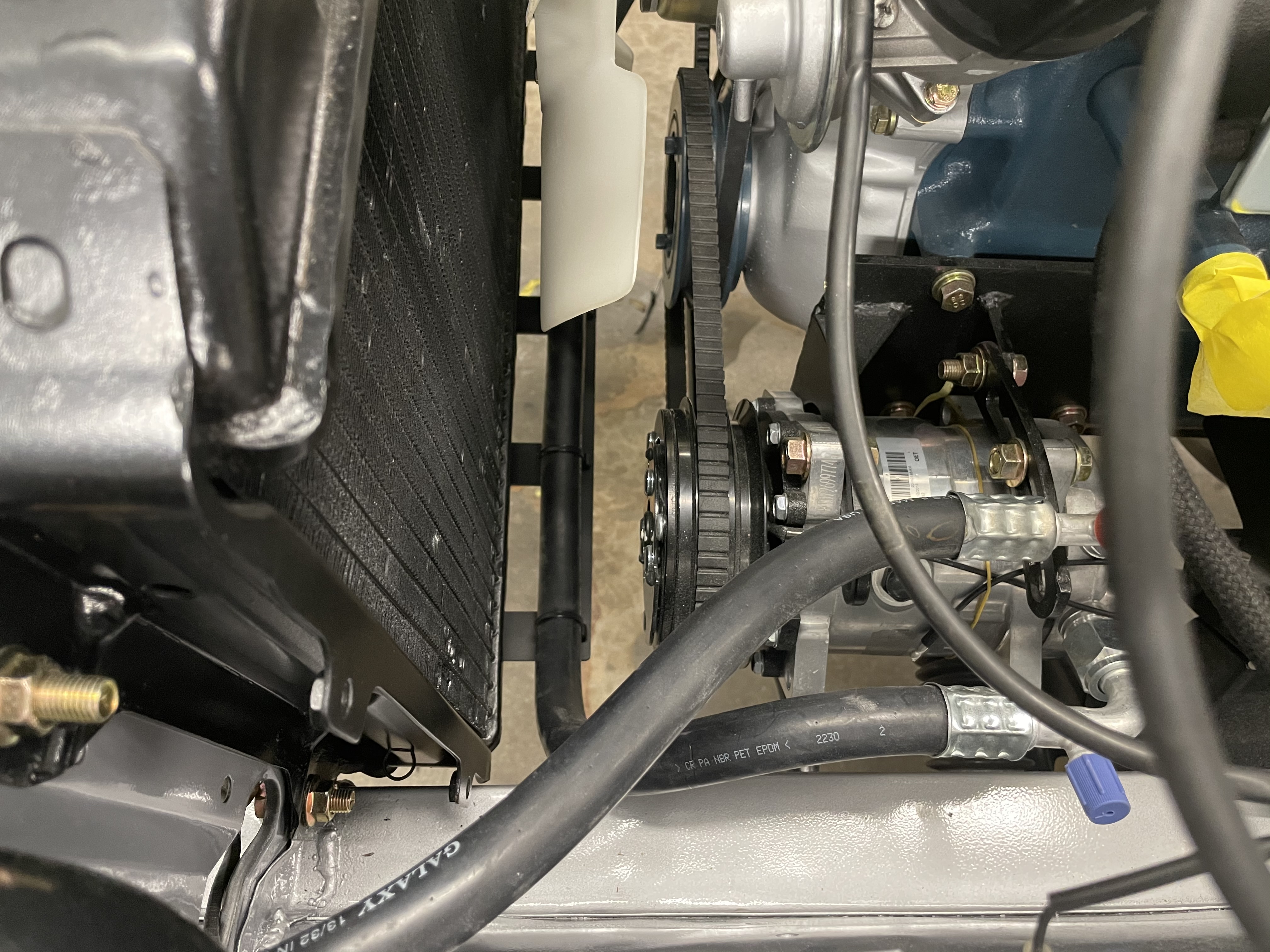

May 2, 20213 yr Author comment_620951 Few small updates as we continue to prep the body for paint. AC system is just about done and I reassembled the choke cable mechanism  Link to comment https://www.classiczcars.com/forums/topic/64674-restoration-of-hls30-12070/?&page=12#findComment-620951 Share on other sites More sharing options...
May 2, 20213 yr comment_620952 I like the A/C hose protector under the Rad., are you not going to install the original drip pan? Link to comment https://www.classiczcars.com/forums/topic/64674-restoration-of-hls30-12070/?&page=12#findComment-620952 Share on other sites More sharing options...

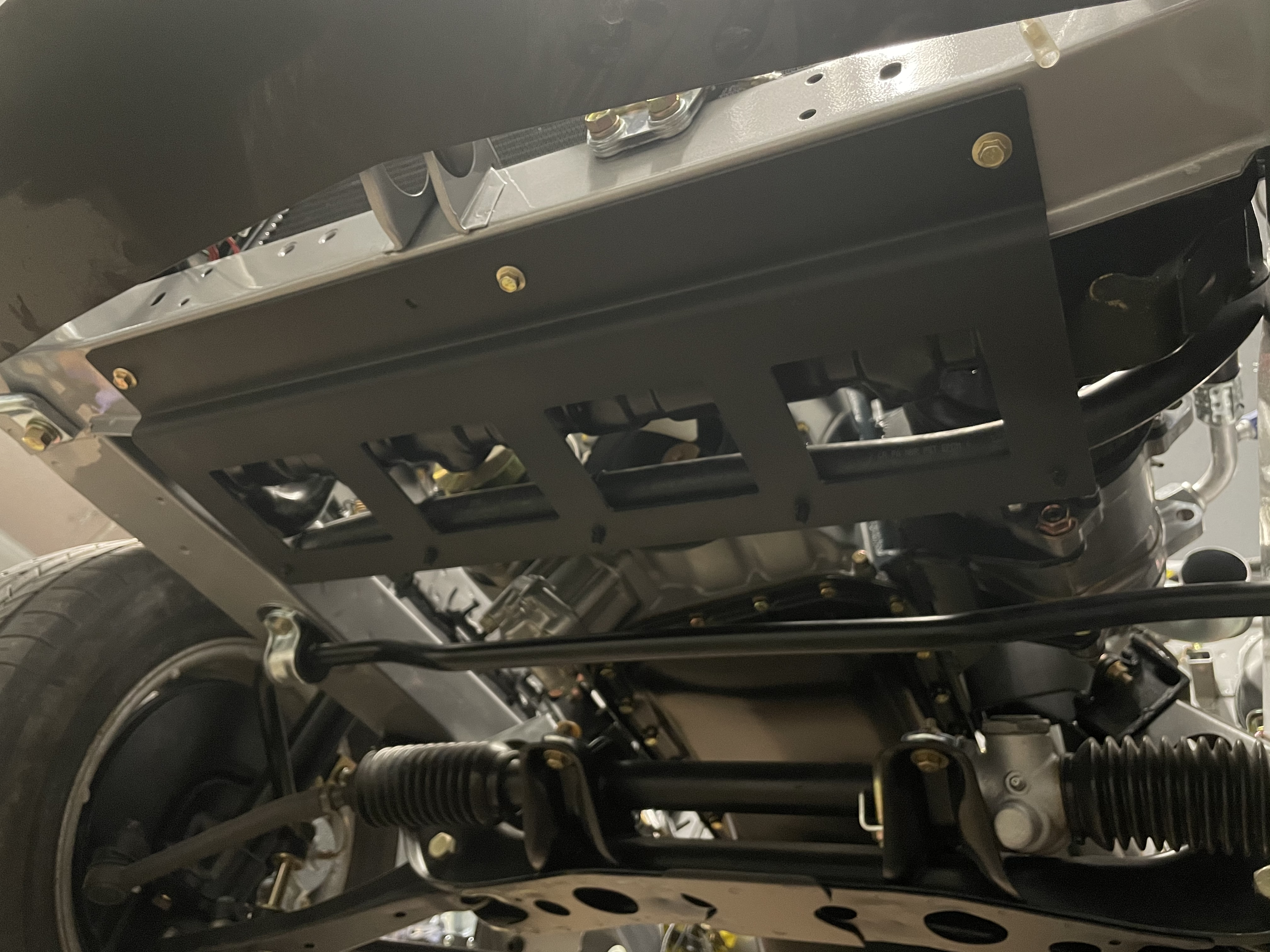

May 2, 20213 yr Author comment_620953 2 minutes ago, grannyknot said: I like the A/C hose protector under the Rad., are you not going to install the original drip pan? Unfortunately that was one piece this car didnât have when I got it. Iâve got one from a 75, and considered adding mounting provisions for the AC hose routing. As hard as the early ones are to come by I would hate to cut one of those up for mounting the AC line to it.  Looking at it closer, in theory I may be able to install the drip pan over the AC hose bracket, and make shims that take up the gaps at the frame rail mounting points. Link to comment https://www.classiczcars.com/forums/topic/64674-restoration-of-hls30-12070/?&page=12#findComment-620953 Share on other sites More sharing options...

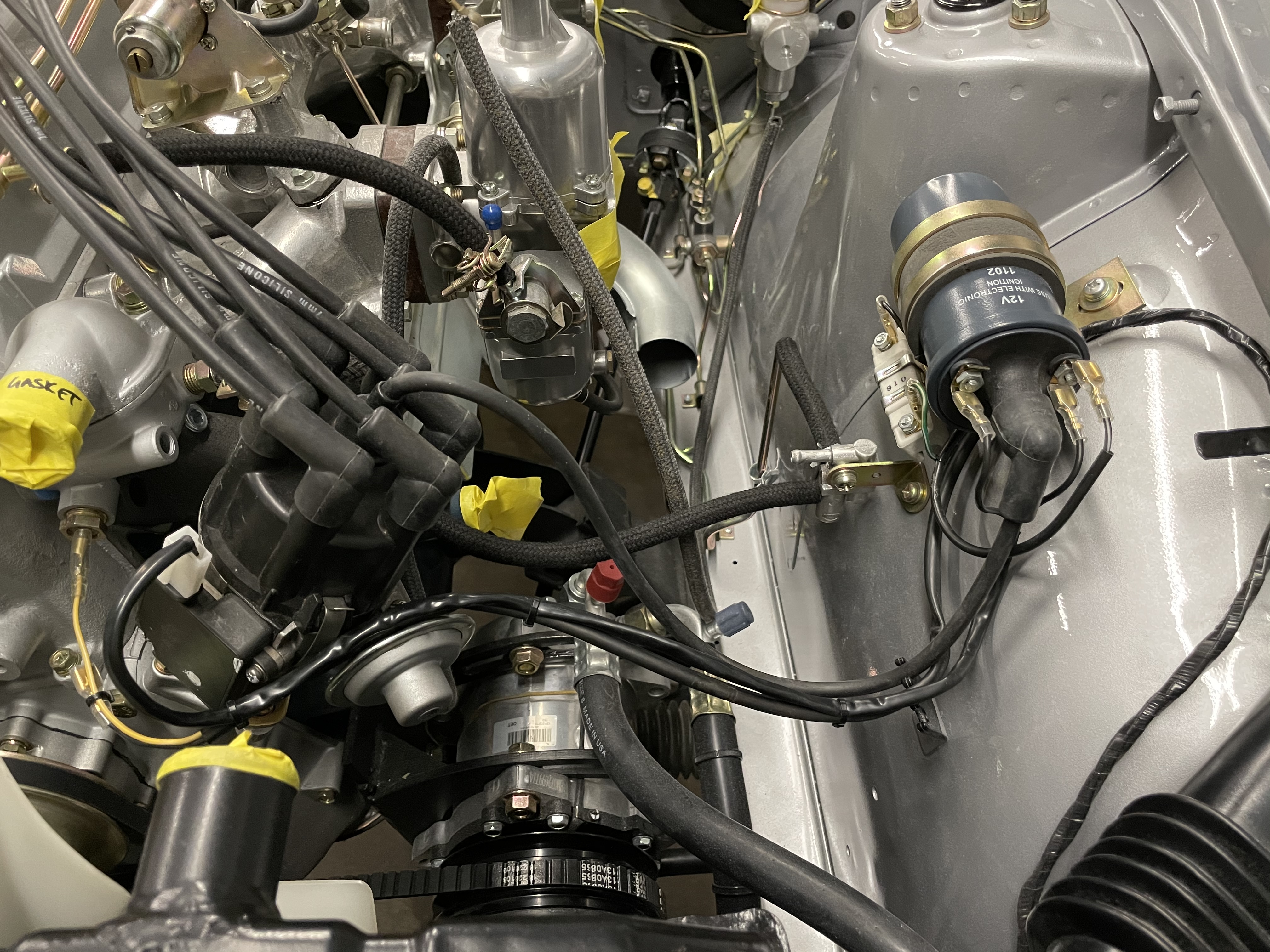

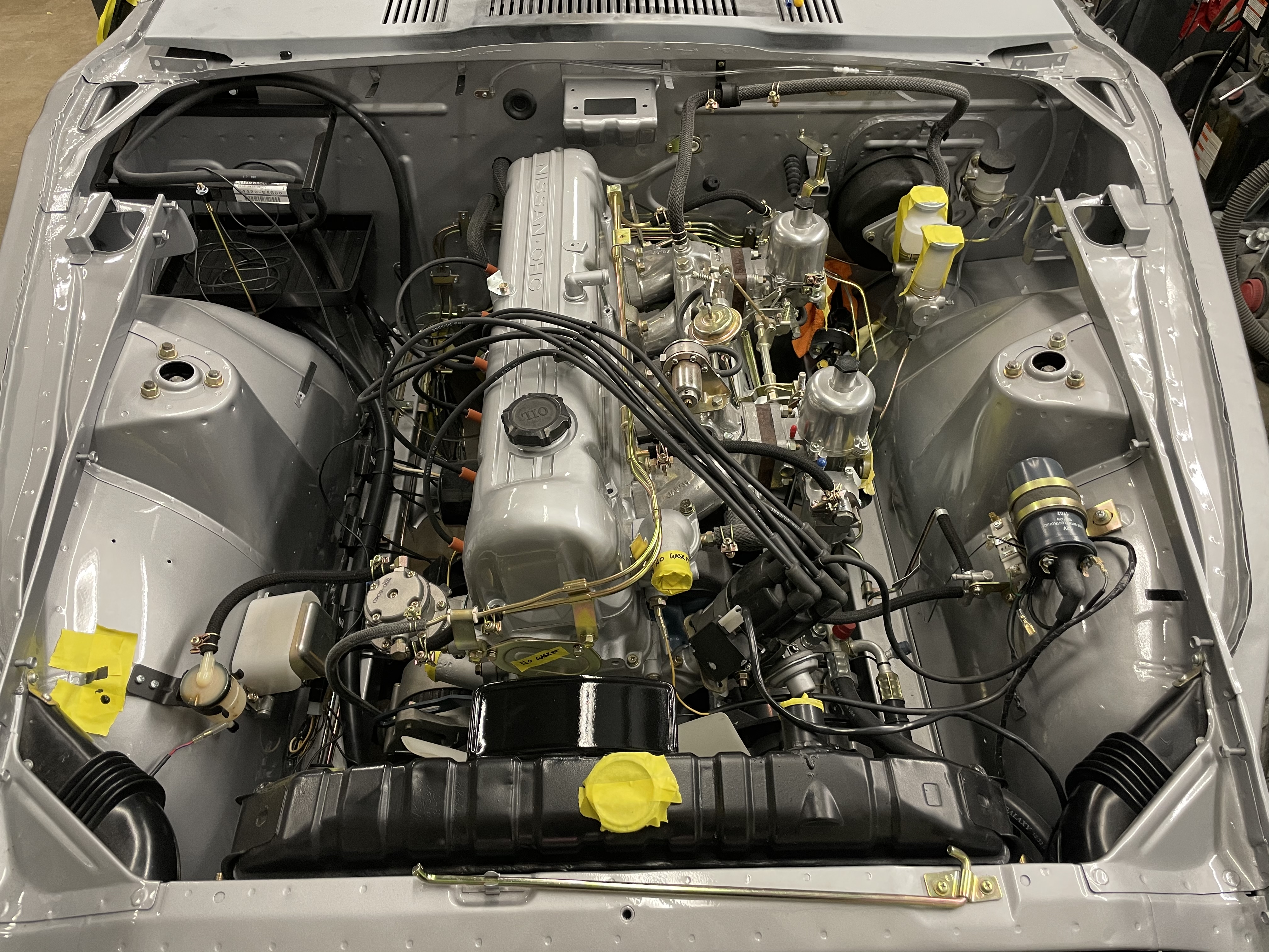

May 16, 20213 yr Author Popular Post comment_621678 Few more loose ends to tie up and the Z will be ready for its first fire up. Â Link to comment https://www.classiczcars.com/forums/topic/64674-restoration-of-hls30-12070/?&page=12#findComment-621678 Share on other sites More sharing options...

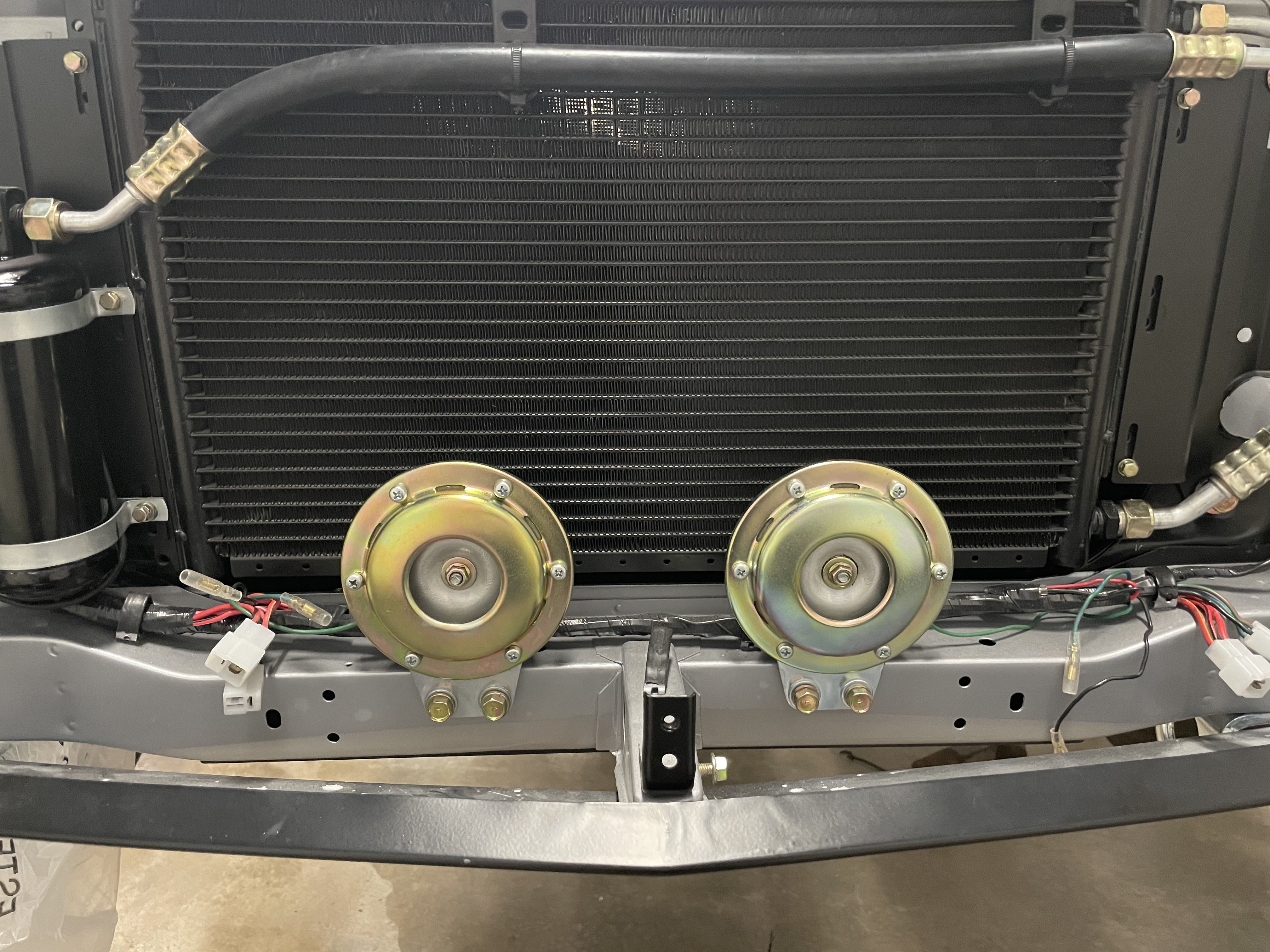

May 16, 20213 yr comment_621697 Just one horn? Link to comment https://www.classiczcars.com/forums/topic/64674-restoration-of-hls30-12070/?&page=12#findComment-621697 Share on other sites More sharing options...

May 17, 20213 yr Author comment_621713 13 hours ago, grannyknot said: Just one horn? Good eye, both are now installed on the Z. Link to comment https://www.classiczcars.com/forums/topic/64674-restoration-of-hls30-12070/?&page=12#findComment-621713 Share on other sites More sharing options...

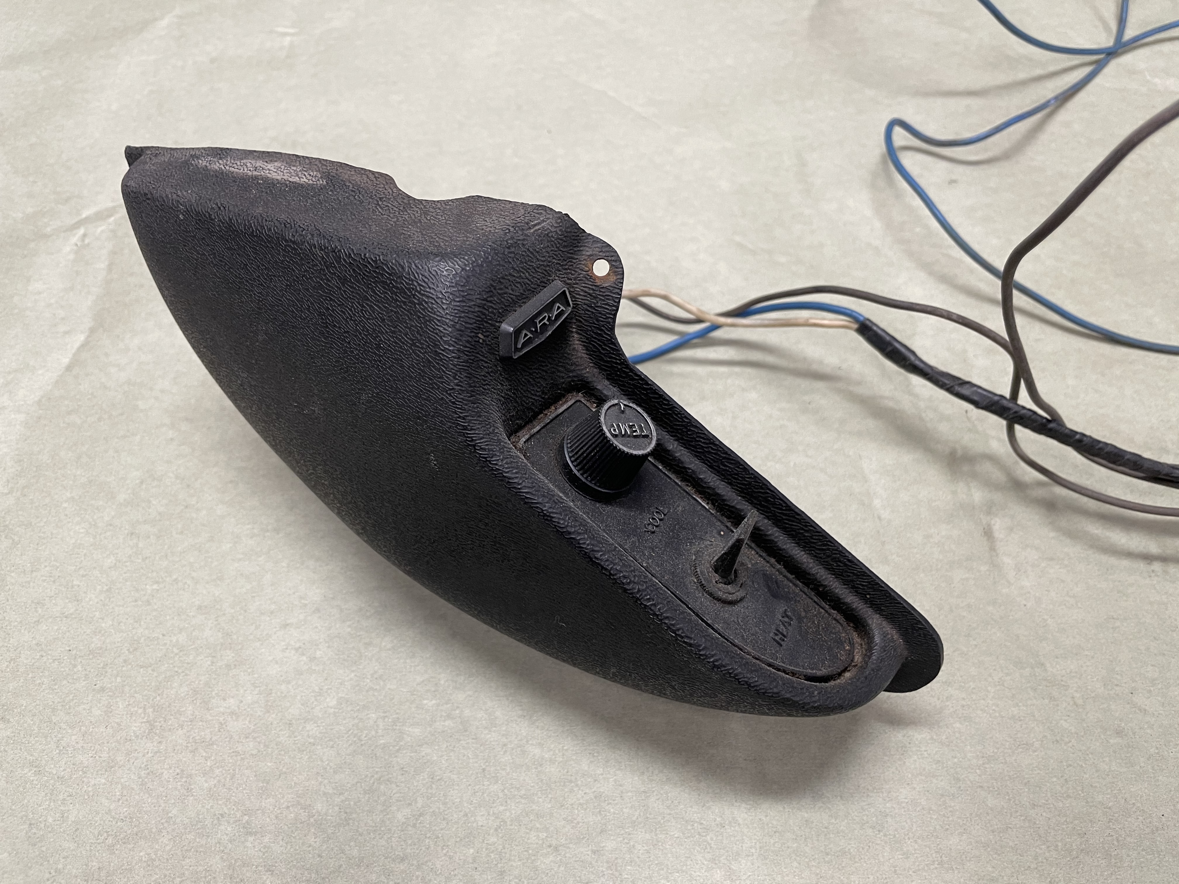

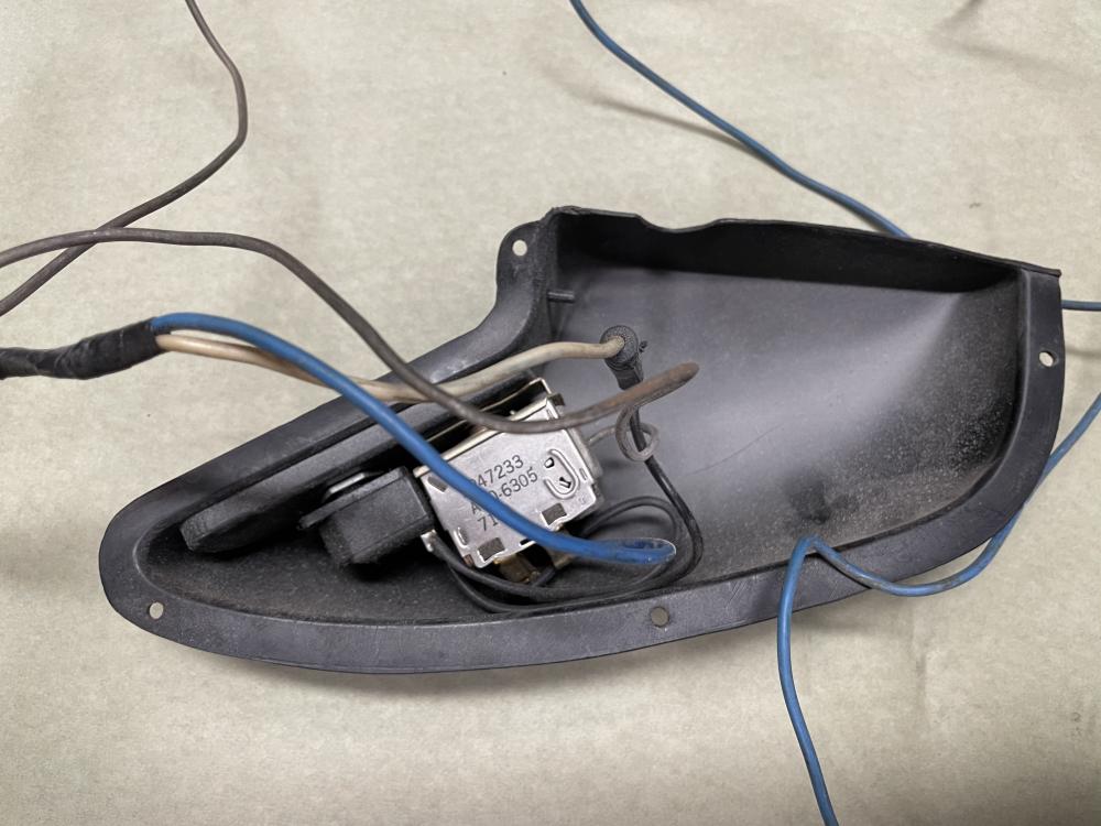

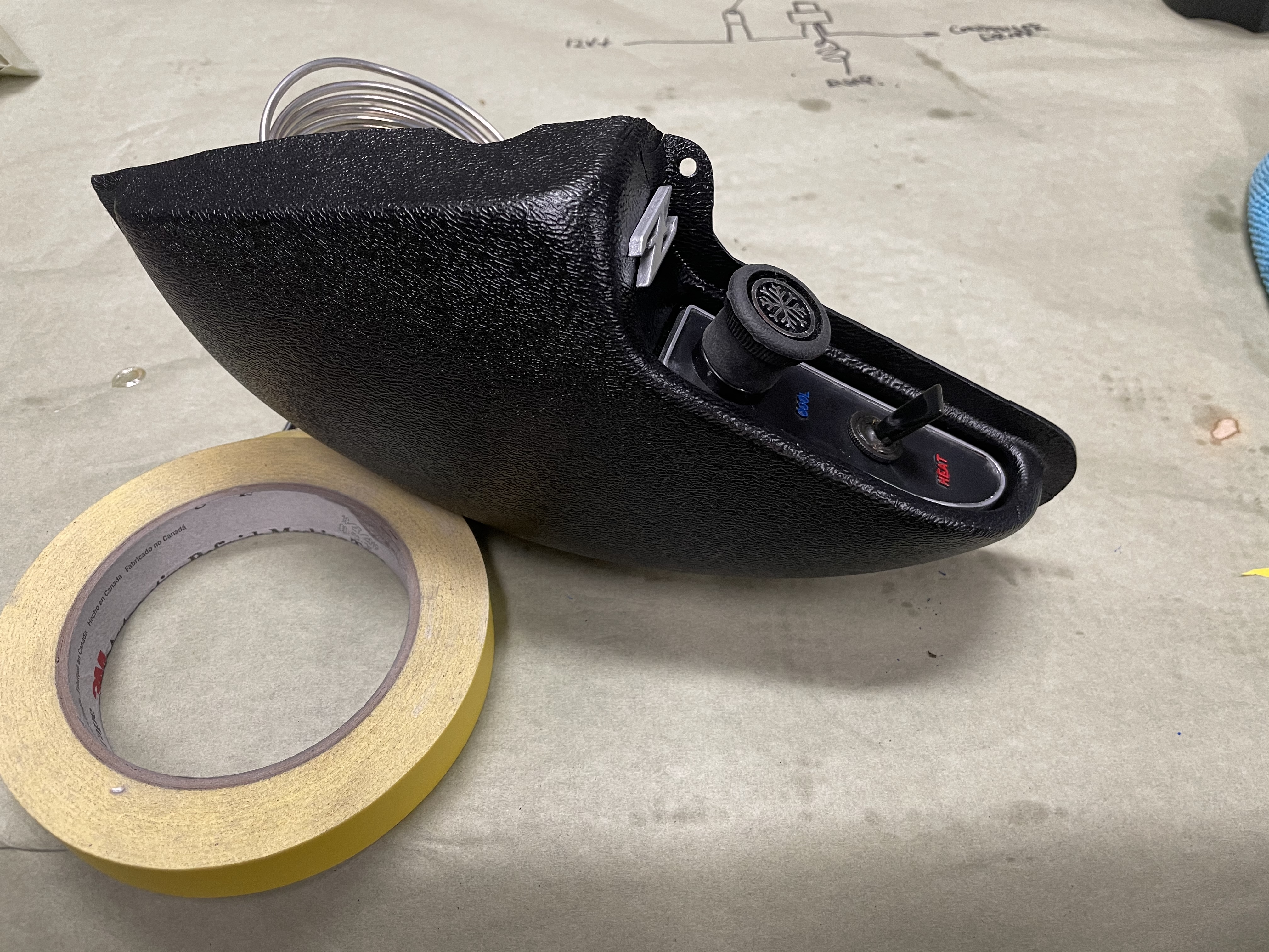

May 18, 20213 yr Author comment_621742 Before and after on the dealer AC controls. Original setup was from ARA, new setup is a mostly pieced together system to make adding AC as minimally invasive as possible. For the controls the ARA unit was disassembled, cleaned, and new switches installed. Also replaced the ARA logo with a Z one to change things up.  Link to comment https://www.classiczcars.com/forums/topic/64674-restoration-of-hls30-12070/?&page=12#findComment-621742 Share on other sites More sharing options...
May 18, 20213 yr comment_621774 Looking fantastic. I still need to come by and go through your A/C installation in detail. I'm nearly at that point on my '72 and need to decide on my path forward. I'm also almost ready for the first start so if you hear something odd coming from just south of you, it could be that! Dennis Link to comment https://www.classiczcars.com/forums/topic/64674-restoration-of-hls30-12070/?&page=12#findComment-621774 Share on other sites More sharing options...

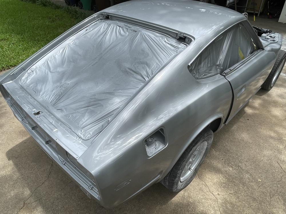

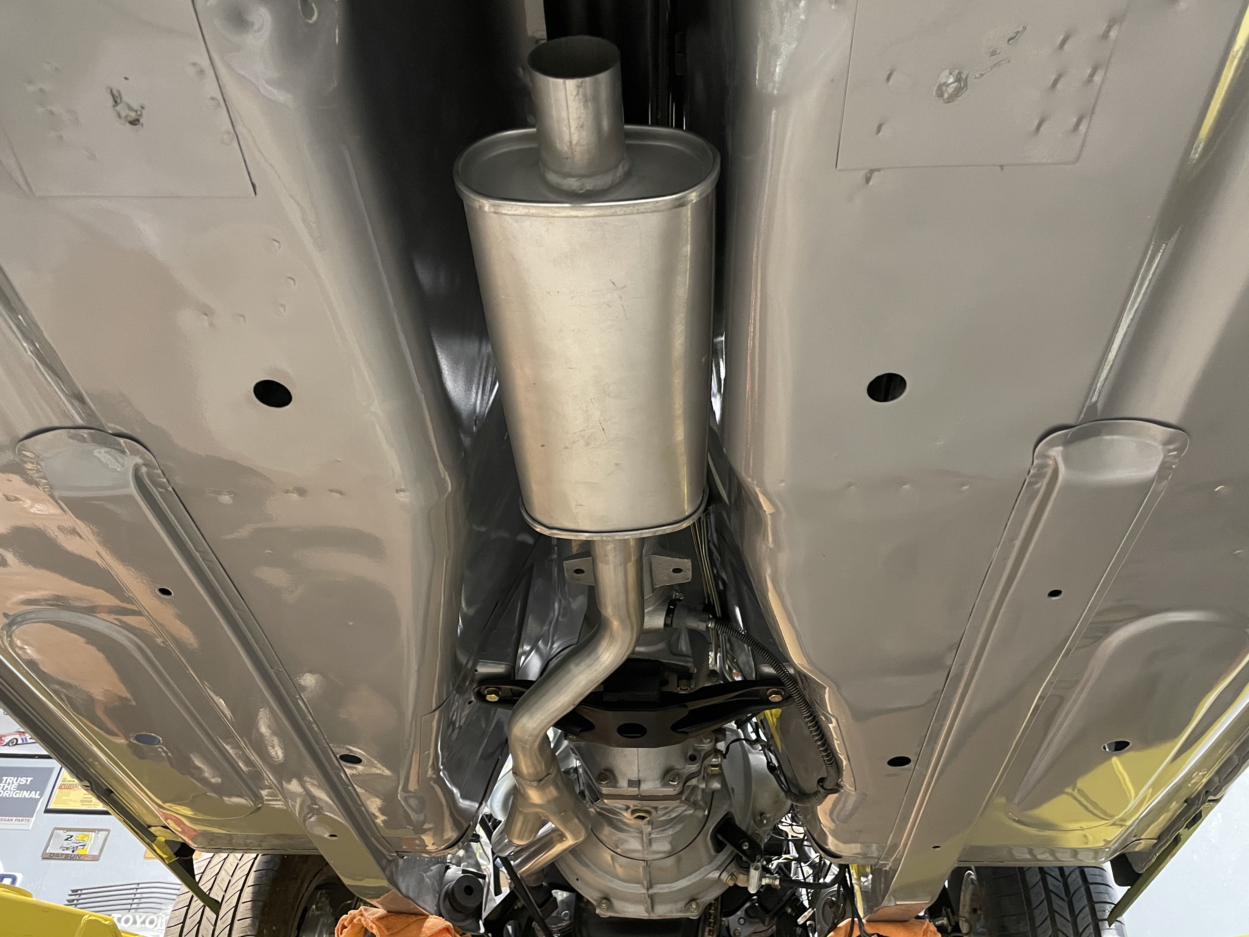

June 7, 20213 yr Author comment_622926 Carrying my exhaust post over to the build. I was able to track down an original styled resonator for the Z. Packages well in the tunnel and shouldnât be too bad to route from. Ideally Iâd like to be an offset inlet/outlet resonator, but this will be just fine.  Painting the body soon!  Link to comment https://www.classiczcars.com/forums/topic/64674-restoration-of-hls30-12070/?&page=12#findComment-622926 Share on other sites More sharing options...

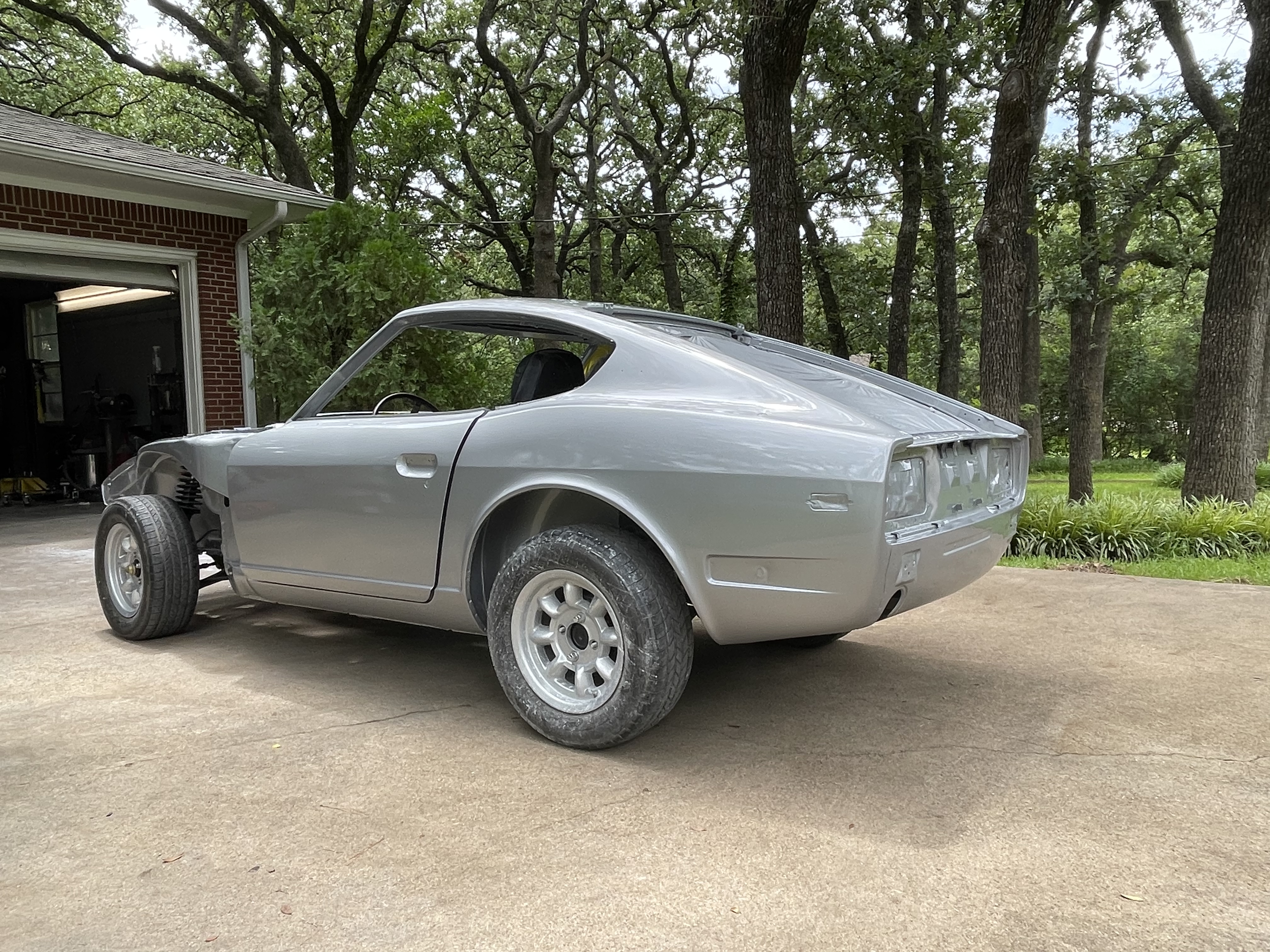

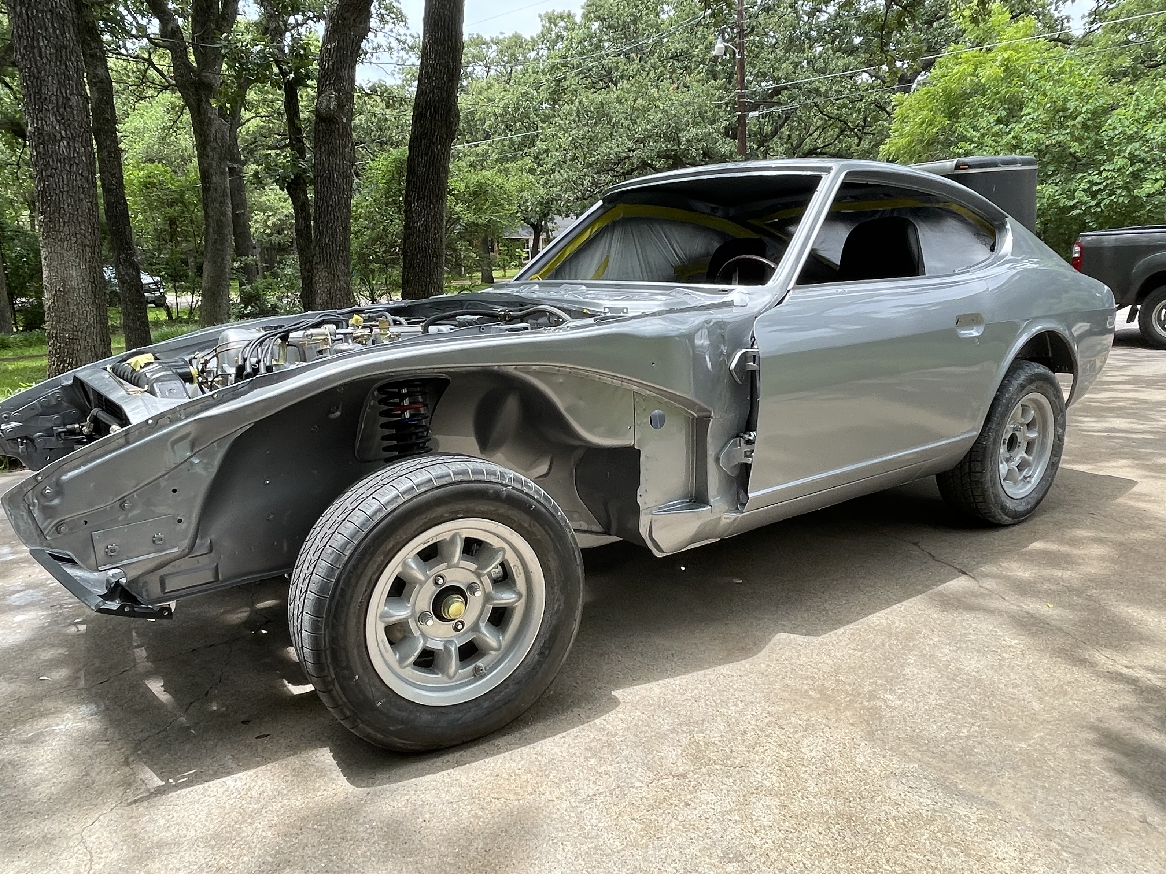

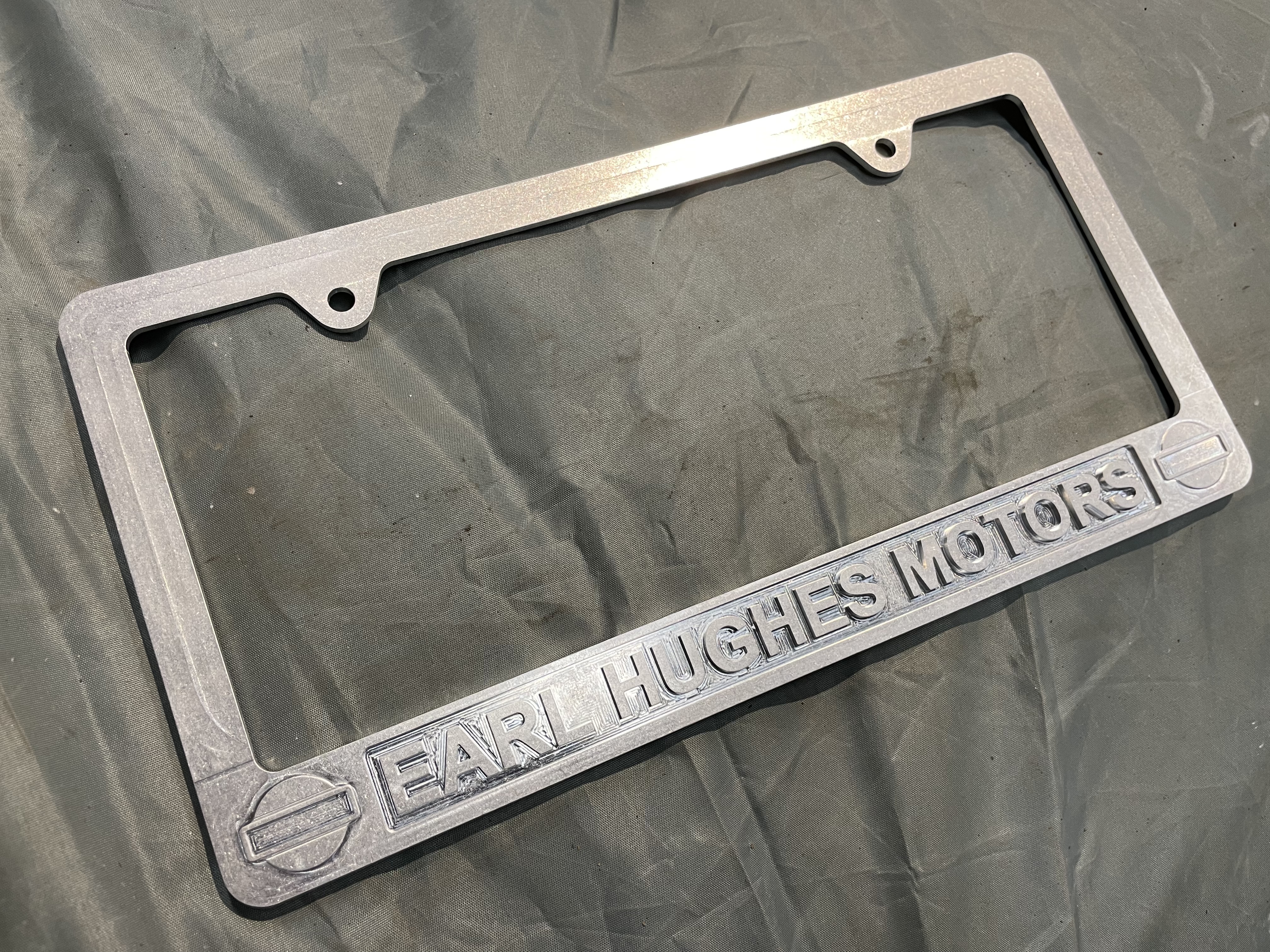

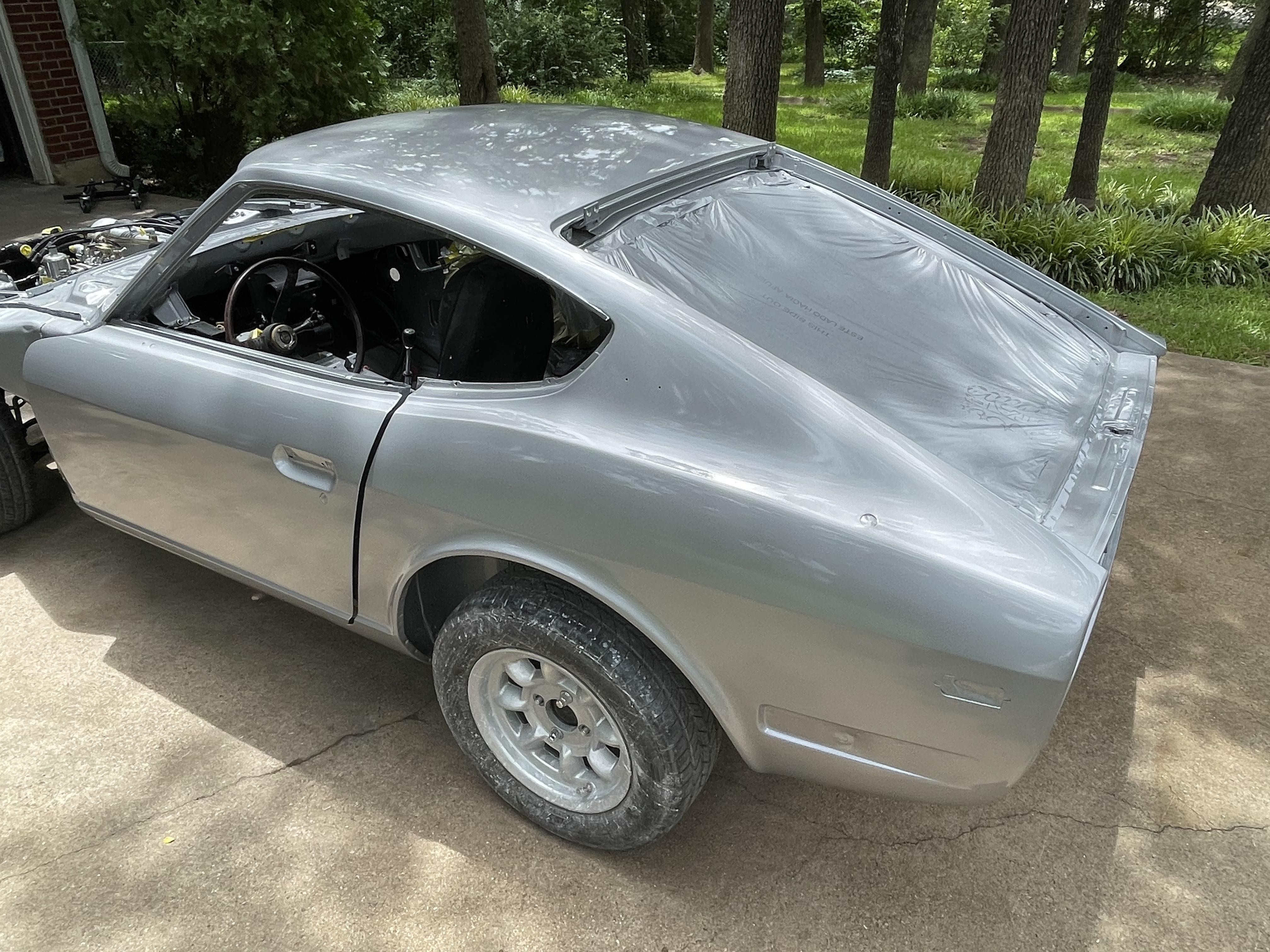

July 3, 20213 yr Author Popular Post comment_624508 Big update on the Z! Body is now painted and ready for reassembly. I also got in the custom made license plate holder for the Z. Modeled this one up to look like a period correct frame from the dealership the Z was sold by in Fort Worth Link to comment https://www.classiczcars.com/forums/topic/64674-restoration-of-hls30-12070/?&page=12#findComment-624508 Share on other sites More sharing options...
